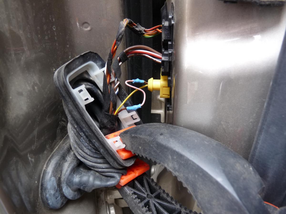

Update on Air bag warning  light:  I took the car to Skoda in Plymouth for a second opinion, they carried out a diagnostic check where it came back as O/S/F side impact sensor. They immediately identified the fault which was in fact the yellow wire that leads from the car chassis side pillar  to the door; ( they even took a photo for me) It's apparent that the first garage correctly identified the same fault but then went straight to the door sensor replacing it at a cost of £220 this wouldn't have solved the problem as it was the damaged wire. They have then re set the fault where I have driven out only for the air bag warning light to come back on the next day due to the faulty wire. Annoyingly the first garage said they checked the wiring before they changed the door sensor; (they obviously hadn't) they also said they had checked the old sensor and had found it to be faulty ( Skoda have said it would be unlikely they would be able to check the actual sensor) Finally the original garage when I rung to complain said it could be a bigger problem to do with the engine management system. Whilst at Skoda I have decided to trade in the Octavia for another vehicle - lower mileage etc... the air bag light is still on and I guess Skoda will fix that when they take the car. I am extremely reluctant to allow the original garage to try and fix the fault and will ask them at least to re-imburse their labour charge for failing to correctly identify the problem and to be honest have lost all confidence in them and just felt they were greasing me up when they mentioned possible problems with the engine management system.

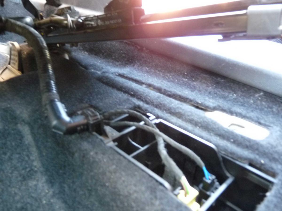

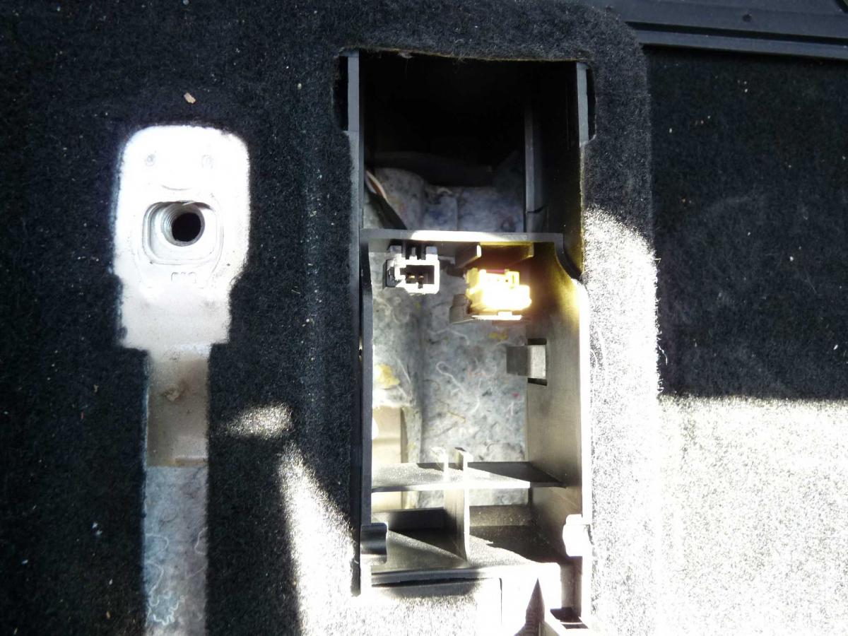

I have unbolted the drivers seat (No. 10 spline driver needed) to get at the 2 yellow air-bag connectors. It is necessary to disconnect the yellow and black connectors in the recess and release the cable clamp. I did not find any obvious breaks in the cables. I repeatedly broke and remade the connectors in the hope of improving the conductivity. I have ordered a Ross-Tech VCDS HEX-USB+CAN Interface so that I can clear the air-bag fault indicator. I have taken some pictures that may be of help to others. I will report the result in a week or so and add the Ross tool to the map. (1st one in France!)
The pictures show:-
The recess under the LHD drivers seat – 2 connectors removed.
The under side of the seat showing the 2nd connector at the back. The white slider releases the connection.
The cable clamp which clips to the side of the recess. 2 releases, one each side. Closest marked with
the VW logo. Squeeze both to lift the clamp vertically.
The recess with cable clamp and connectors replaced Seat tilted back.

Fixed.  Found a broken brown wire in the door cable bellows. There was almost no slack. Didn't know how to release the connectors, so I soldered in a short length of wire in situ.  Made more difficult by the corrosion on Skoda's copper wire, which I scraped away with a modelling knife. I cleared the airbag fault with VCDS and it has not reappeared.  Thanks for all the help.
