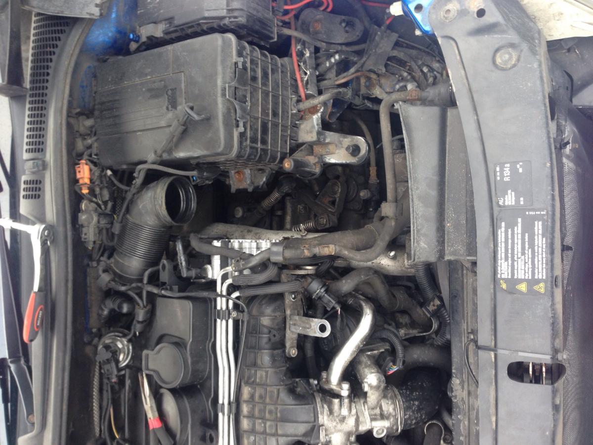

Hey guys,
I'm trying to locate my coolant temp sensor but cannot find it at all.
Can someone point me in the right direction please.
( the last pic is the fuel pressure sensor ) I'm told it's similar though.

From your picture:
Edited by IngusSeflers
you have to take the alternator and tensoner off, its behind them in the middleish of the bottom part of the engine, this will help- removed youtube clip as for petrol engine
Edited by VRSerious
Wrong!! That Youtube clip is a petrol engine!!! seesh!
Locate the top radiator hose then follow it back to the plastic coolant flange at the head/block. THe sensor is tucked away at the back of this flange as per ingus's picture under the tandem pump
