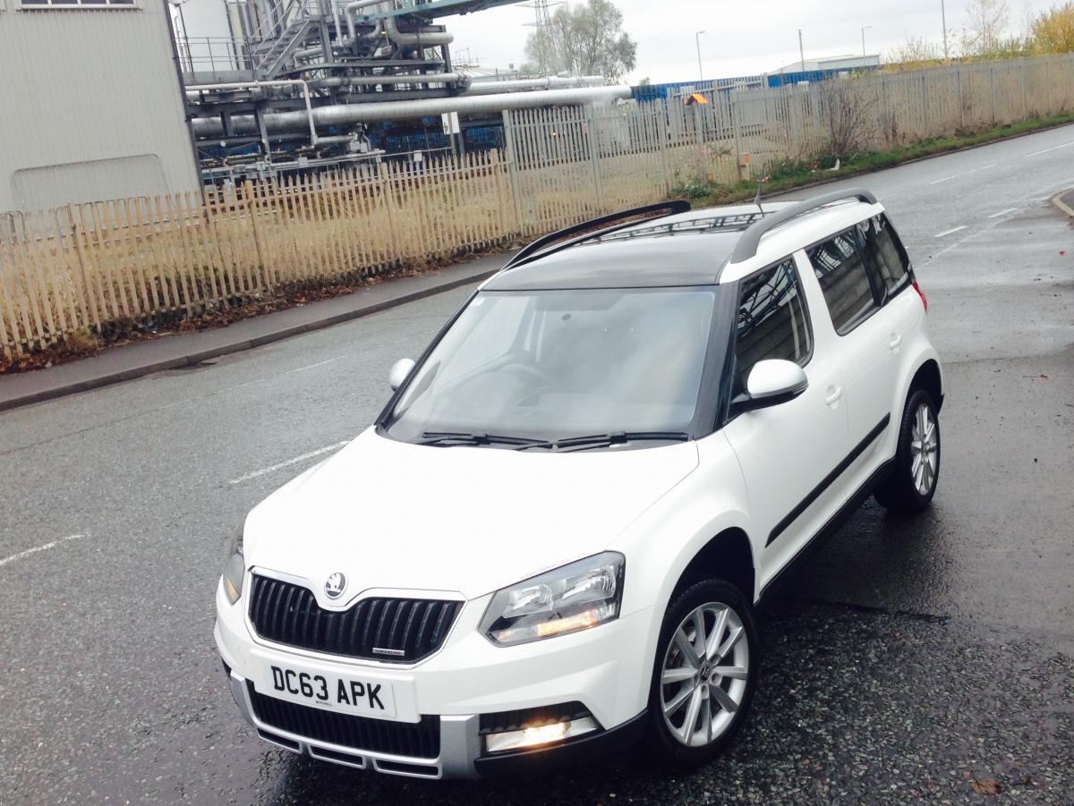

Probably going to get roof wrapped on the car, have the sunroof so most of the roof is already black so gonna get the back end of the roof done, anyone got sunroof and had the remainder of roof wrapped? Just trying to get an idea of cost, been quoted between £150-£300 over phone as estimate which I think is too much, hoping they'll come down in price when they see it and realise its only a third of the roof that needs doing.

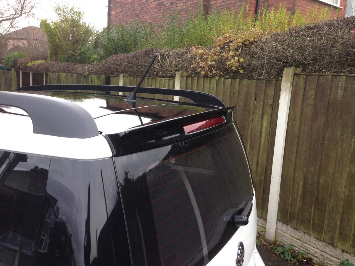

id be weary at that price, i payed £190 inc a spoiler and that was 'mates rates', heres a pic of the job.

That looks good mate, I have the sunroof so 2/3 the roof already black so it's only the last third, they seem decent company and been around 10 years, looking at their gallery they've done some top end motors too.
Obviously not trying to put anyone off, but I know my standard of work and I've been wrapping prestige cars for along time, but i also know you tend to get what you pay for, and I've seen some absolute nasty examples of work, if it's done right, it will last as long as the paint. Just check what your getting for £50
