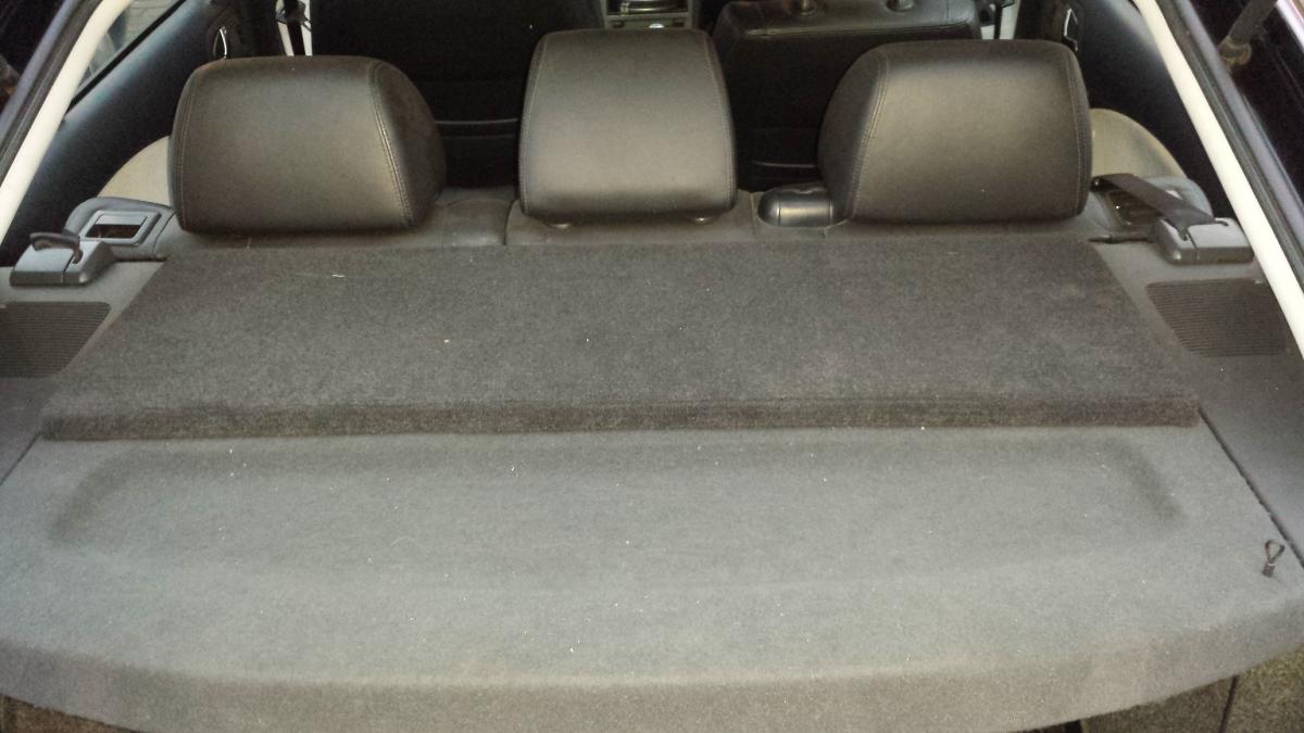

Last few cars I've had, I have removed the original parcel shelf, and constructed an entirely new one out of MDF. Because that's how we did it 'in the old days' haha!
But I've seen good results with modifying the existing shelf. Which is what I did with my Octy. So basically what I did was find a bit of 18mm MDF, and cut a rectangle of the MDF board that was about the same size as the flat, rectangular bit on the parcel shelf. I then cut the holes in the board for the speakers, and mounted them. I then covered the board in black aucoustic cloth.
I cut corresponding holes in the parcel shelf, and then placed the board on the shelf, and wound screws through from underneath the shelf into the board above to secure it.
So I've ended up with the original parcel shelf, with a rectangular MDF board mounted to the top of it, giving me a solid place for the speakers. It doesn't really show up at all when you look at it through the hatchback glass, and it sounds as solid as any other parcel shelf mount for 6x9's that I have ever made before!
Hope this helps. If you want, I can take a few pics and post them up, let me know.

Here you go, pics of my shelf as discussed above. Hope it helps! It only took me a couple of hours to make, and you only need a smallish rectangle of MDF to do it. Works like a charm!
Cool, looks tidy enough. Mine are in now, I nibbled a bit out of the speaker cover in the end to make them fit the gap. It doesn't look too bad. Speakers wires are just gashed in for now until I order some adapters, but they're producing better sound than the standard speakers at least!
