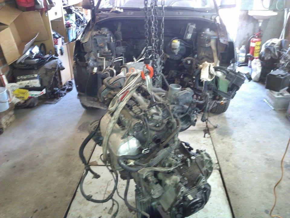

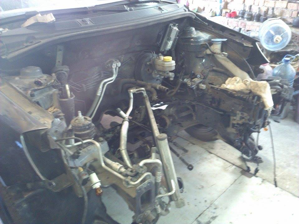

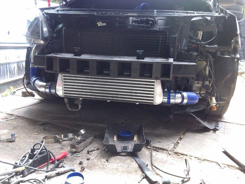

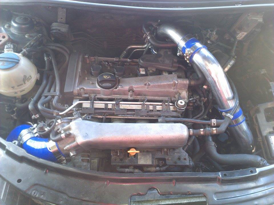

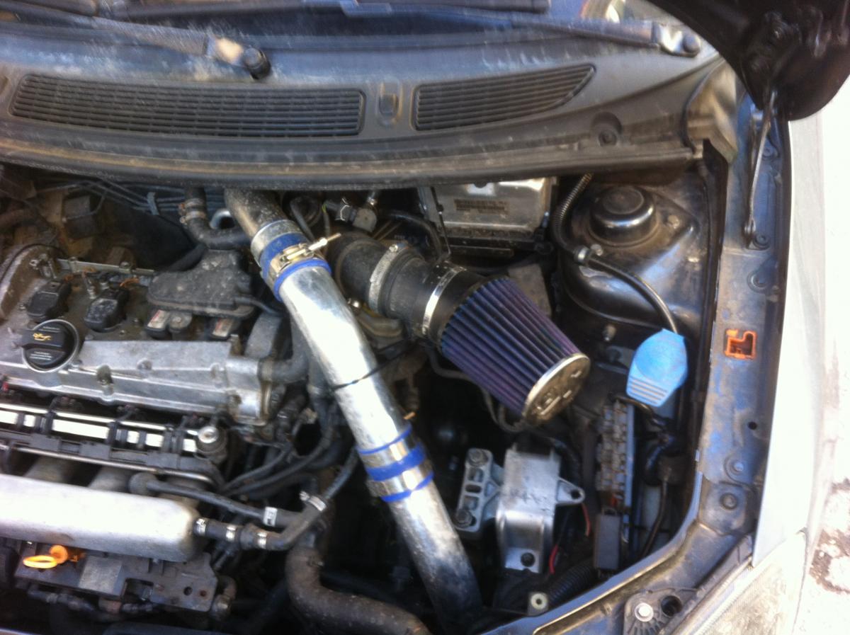

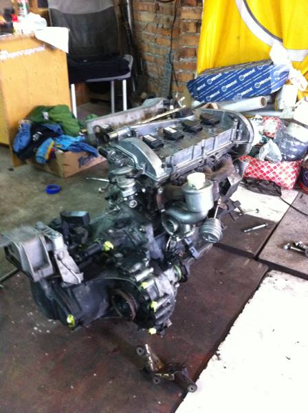

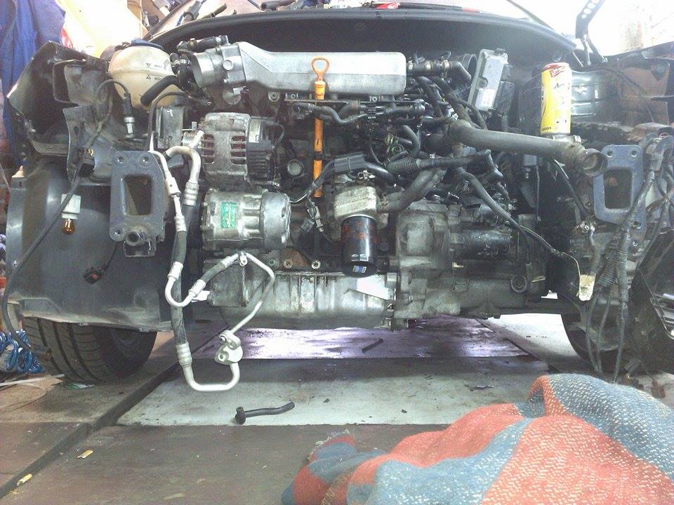

So , after the car started whit the new heart , we started checking and finishing most of the things.

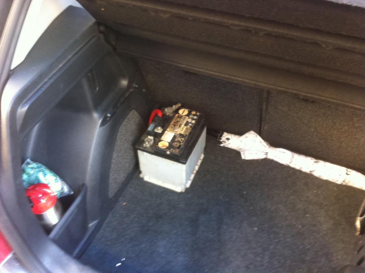

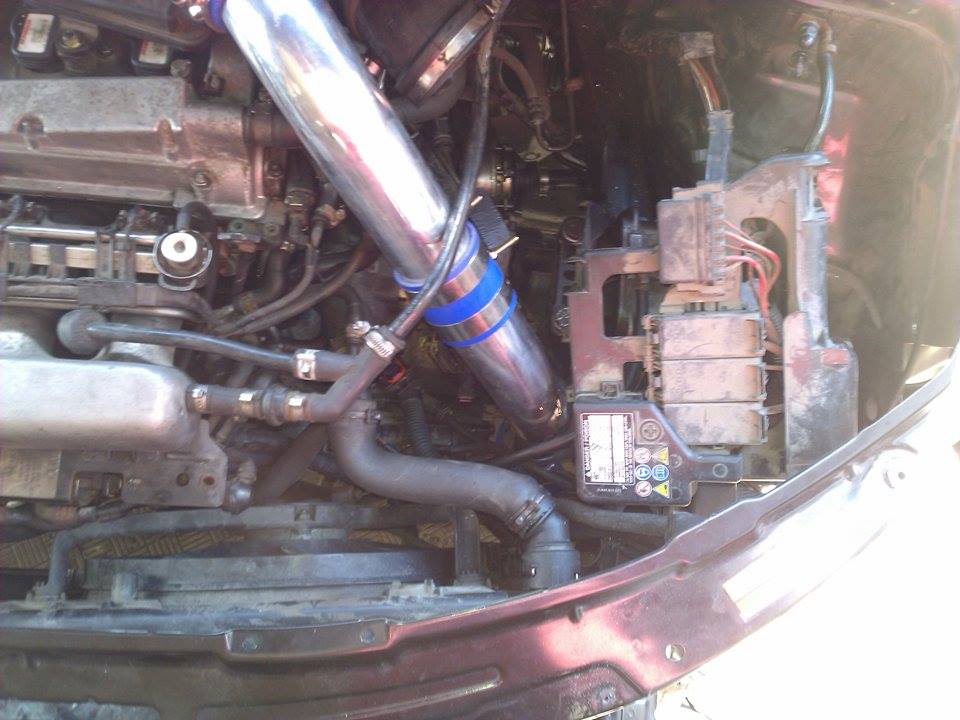

The battery was moved into the trung

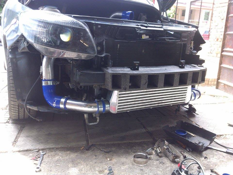

Because we noticed that the space under the front roof is smal ,but i want to make the a specific room for the intake.
By the end of the month i will create a "shield" for the Intake

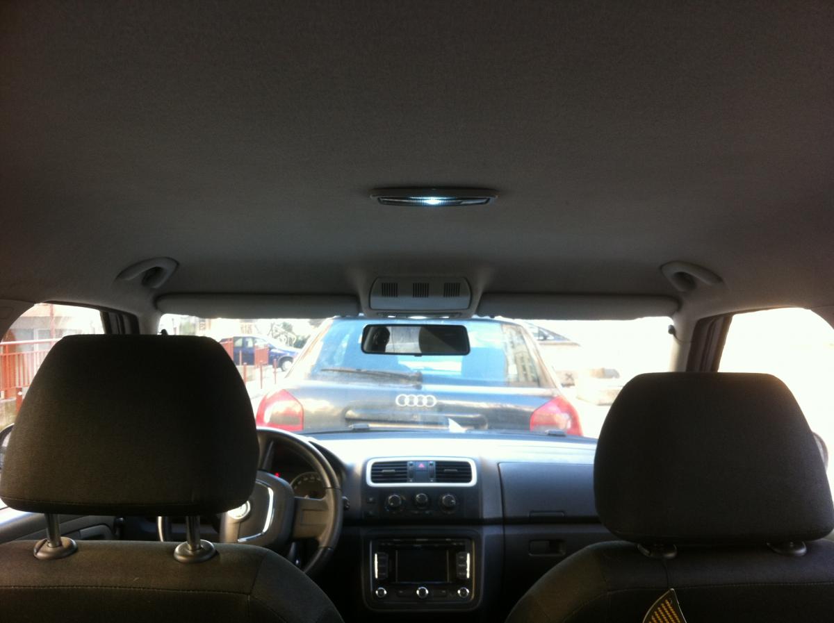

I took the idea from our colleague with the Black Fabia sport from Greese and put a second light inside the car , in the middle of the roof

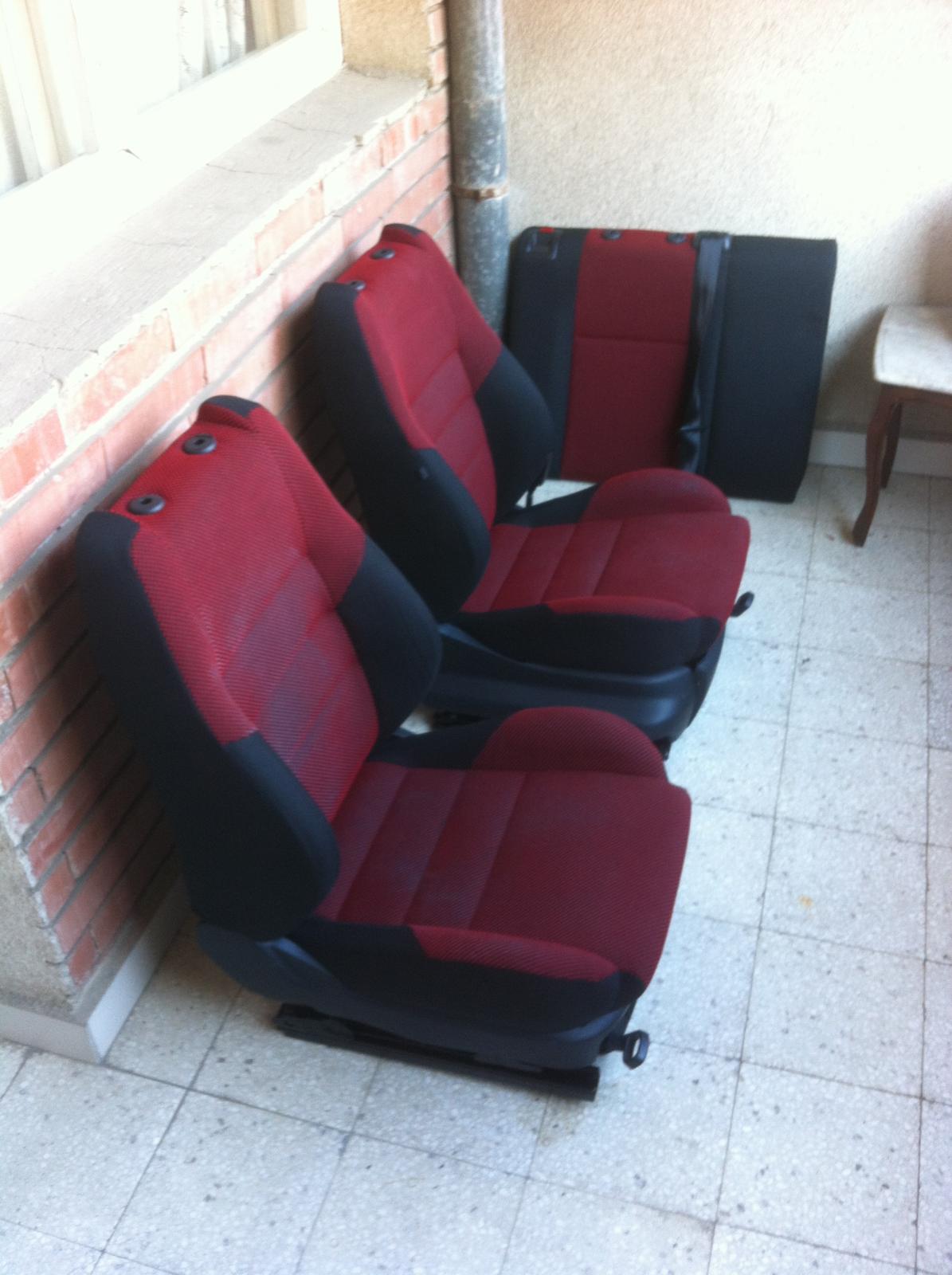

Also i get the Fabia sport seats , which at that moment are red from monte carlo , but i will upholster them with black

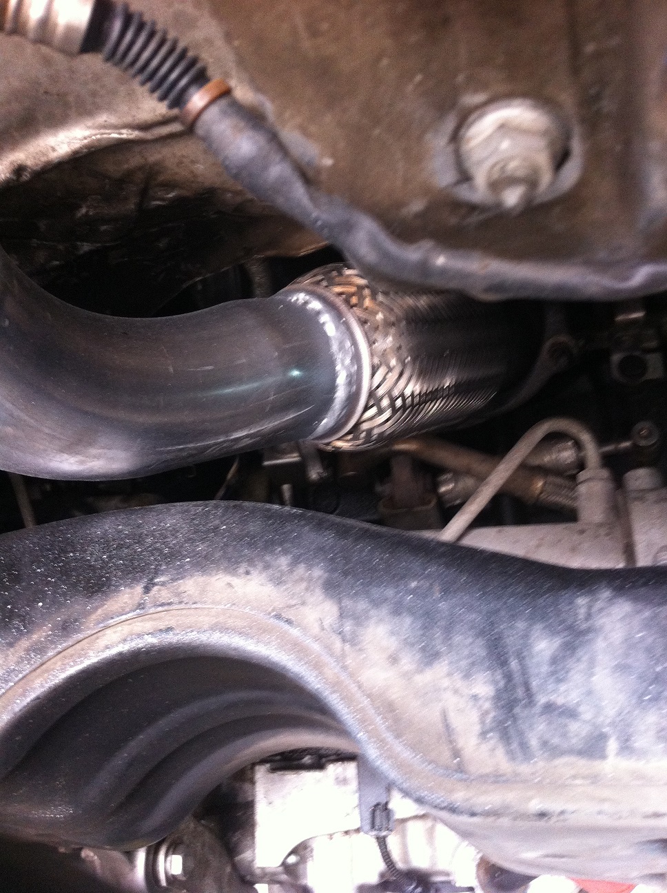

Something that i`ve forgot to mention is that the exaust is 63 mm

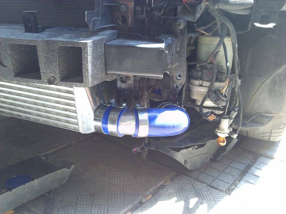

So i have also installed an exhaust silenser.
I got a boost pressure metter and Oil Pressure meter , which will be installed by the end of the month.
I got a pari of EIBACH pro-kit  springs. I hope soon to be able to complete the suspension.

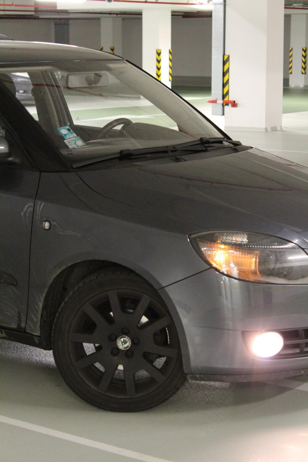

At the moment the car is for full re-painting , and the wheels will be changed with pair of these : http://reifen-lorenz.de/fileadmin/_migrated/pics/rial_como_schwarz.jpg 17''
Right Now the car is still with the Stock soft , but soon it will be remaped. The expected results with this Hardware is 190 H.P on the wheels.
