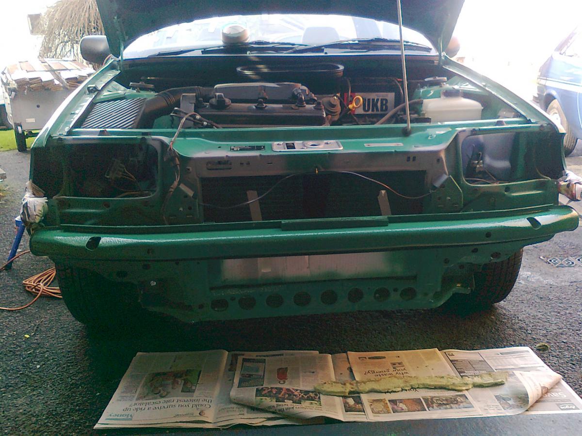

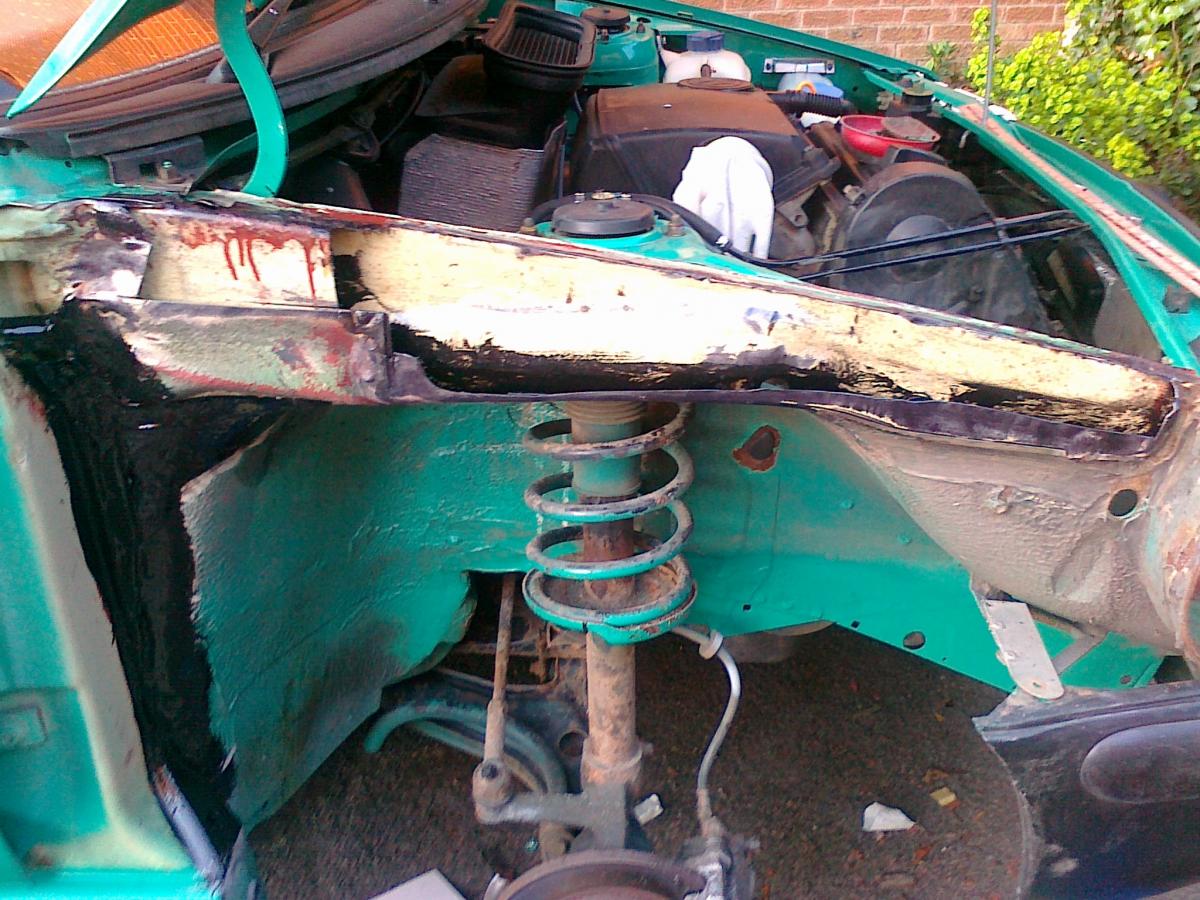

So lets get started, front end off for rot inspection, wings will be chucked, have new wings ready to go on after few repairs
Excuse the welding, was blowing holes when I started
Next
Bit tidier
Mainly just surface rust on n/s/f inner wing so just needed a little rub down, primer and a touch of sealer,

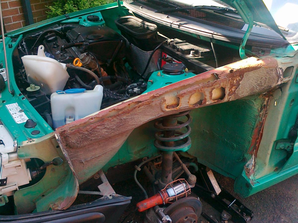

I cannot find the photographs of the rear wheel arches when I repaired them when I do I will post them I wasn't as lucky as you as both front inner wings were in a bad state I used a piece of plywood and a jigsaw to cut the shape I required and bent the metal round it maybe you could do the same it was successful

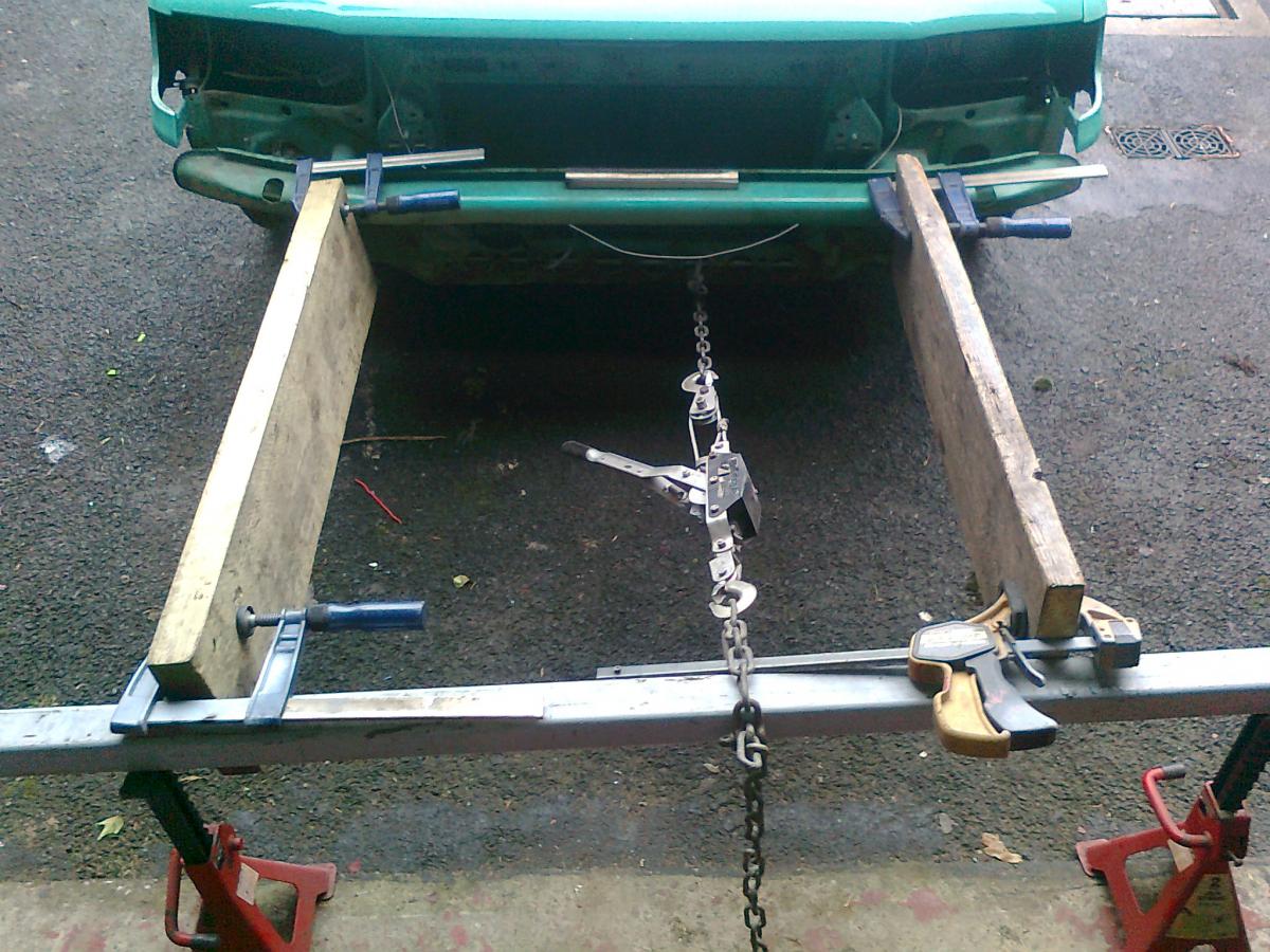

Not wanting to take your thread over but sharing things that work always helps others, the front crossmember was also in a bad way the truck lived on a farm for several years and it had obviously hit a few rocks in the fields over the years this is how I pulled it back into line with my home-made body jig

Wow, I thought mine was in a bad way, that first inner wing pic brought a tear to my eye! I doth my hat to you sir, some good quality repairs there. I will be checking out your build thread for more ideas.

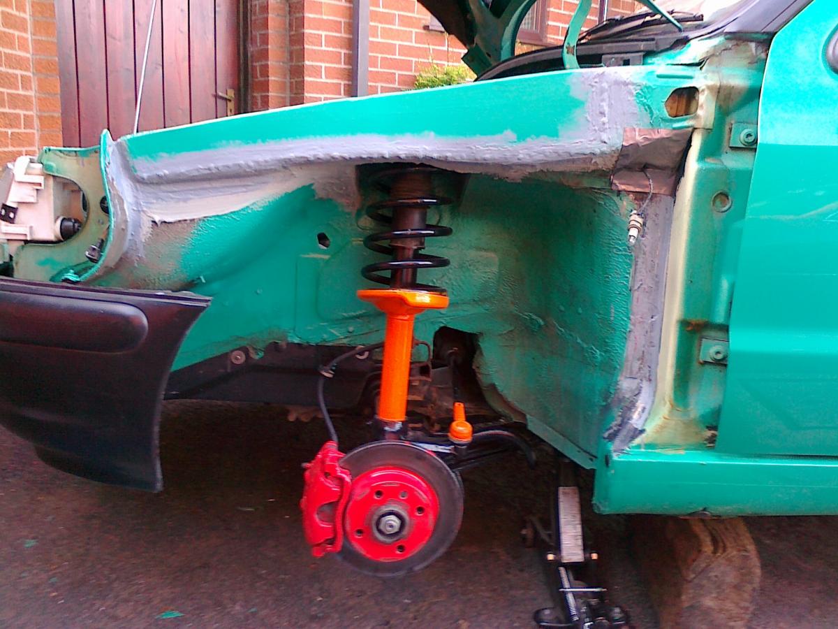

^^ Nice repair, is that using 1mm steel? Good to see so many of these being rescued, just a shame skoda didn't slap a bit more primer on them in the first place.
Yes it was 1mm right angle repair section, you can buy it from most panel suppliers, or I guess yoi could make it pretty easily if you have a metal folder, there were none of these captive nuts left that hold the wings on so I had to use self tapping socket head screws.

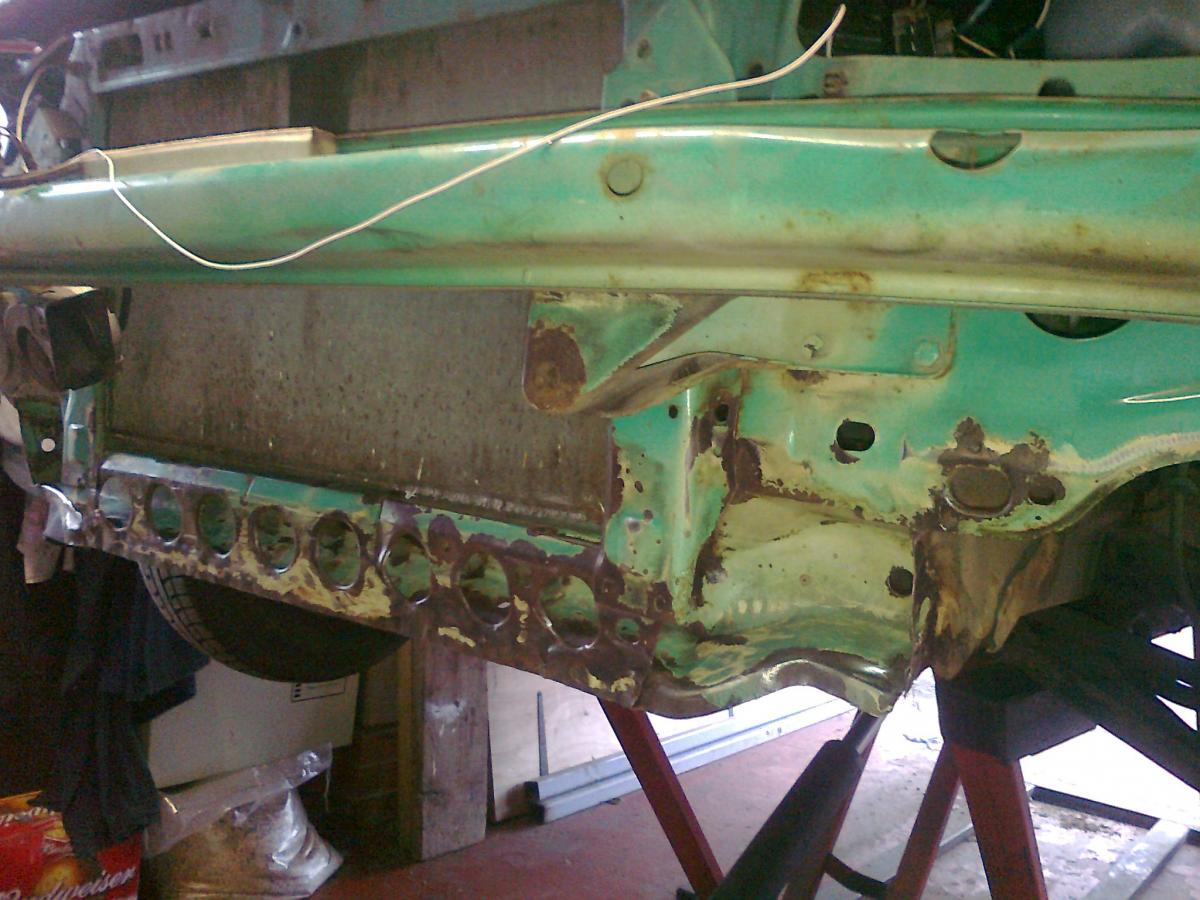

Managed to get a couple hours on the pickup today, rotten sill:
Rot cut out back to some fresh metal, inner sills look fine although theres a bit of rot behind a previous repair (last pic)
New bit of sheet fab'd and shaped to fit
Bit of primer, Ready for filling and smoothing eventually
thats it for today
Nice job you've done on that. Pushing the weld bead uphill by the looks of it.. odd what you can tell looking at pictures isnt it.
something else I thought of too, make sure you trial fit your new wings before you paint them, pattern part wings for these can vary massively in thier fitment, I had to trim mine to get them to fit around the inner wing spars and had to use a bit of persuasion for them to sit down flush with the door.

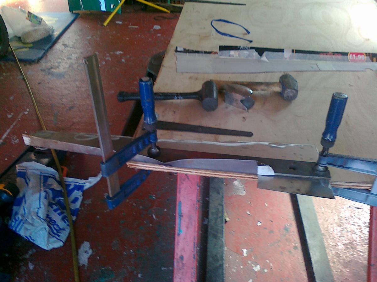

Had another go on the pickup today, first up a diy sheet metal bender was fab'd
