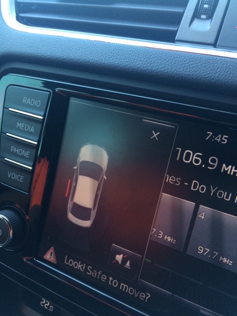

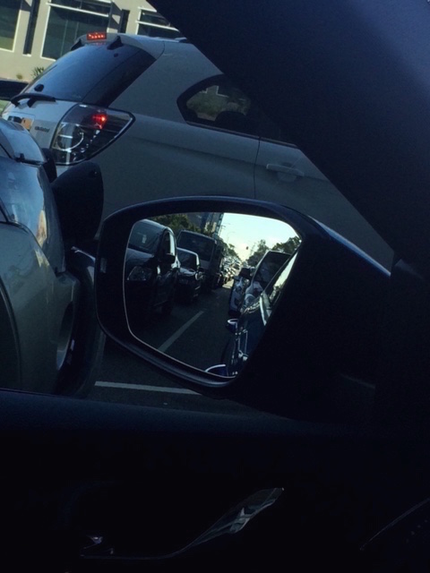

I have been having some issues with the sensors. The side ones go off randomly from time to time in traffic or turning into a junction.
If beeps as if you are about to hit something.
See two pictures attached of an example whilst sat in traffic. Both photos taken without moving or anything around me moving...

Thanks TomLux appreciate it. I think the things are separate. I agree that the sensors are sensitive and go off a bit early as if you are about to hit something that you are approaching / passing.
But the issue i am having is different. The sensors will go off when nothing is close. I can either be at a stand still or moving slow (never above about 20kms). The pictures are a good example because if the sensors were picking up a car it should set - off more than one of the panels.

ah yes I didn't notice that it has only one bar as red. I don't know, maybe a faulty sensor? I don't know how the front and back side sensor talk to each other to determine how many of the side bars the system will show as "detecting something". Could be that one is defect and detects invisible objects and the other isn't, thus showing only one bar.
Let the dealer sort it, but as often it's non reproducible I guess. Sorry that I can't be more helpful. If I should encounter the same thing I'll let you know.
