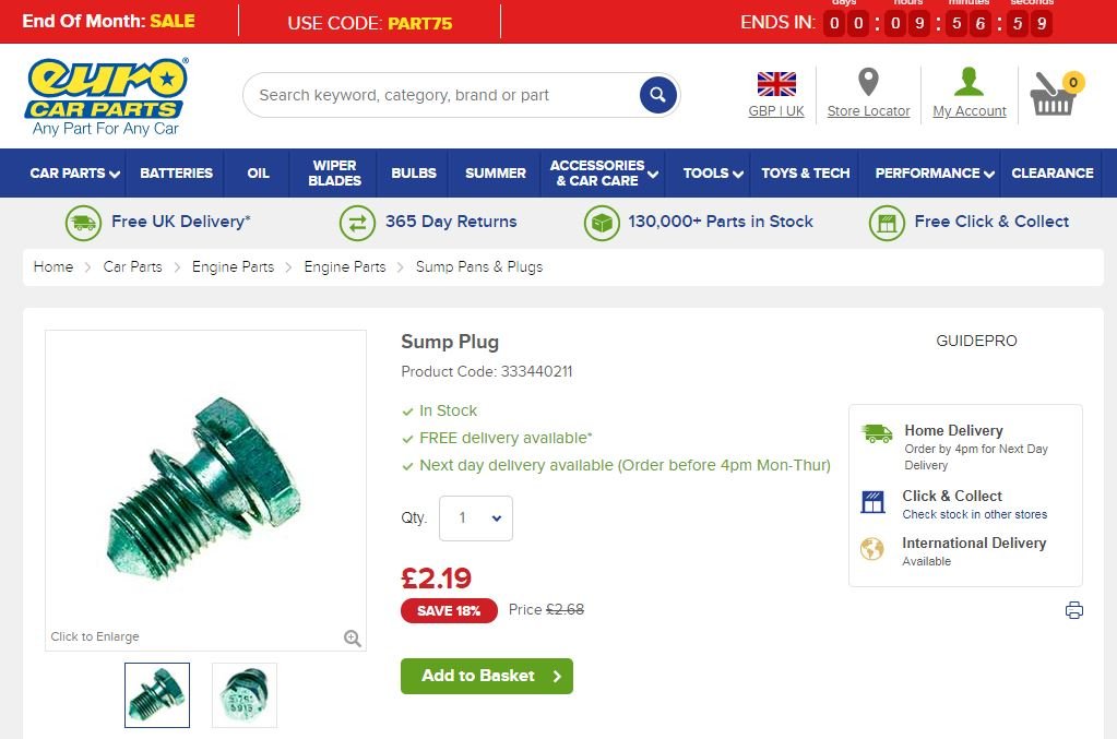

Great write up and pics.  Would you happen to know the code/size of the new sump plug you are using ?  I see ECP have a 75% off sale today so I'm going to stock up...!
Cheers
Cheers

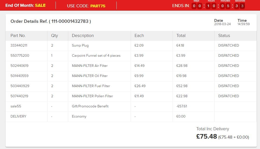

Here was my last Eurocarparts order.
19mm sump plug with integrated washer = 333440211...
They've gone up by 10p!
Edited by silver1011
