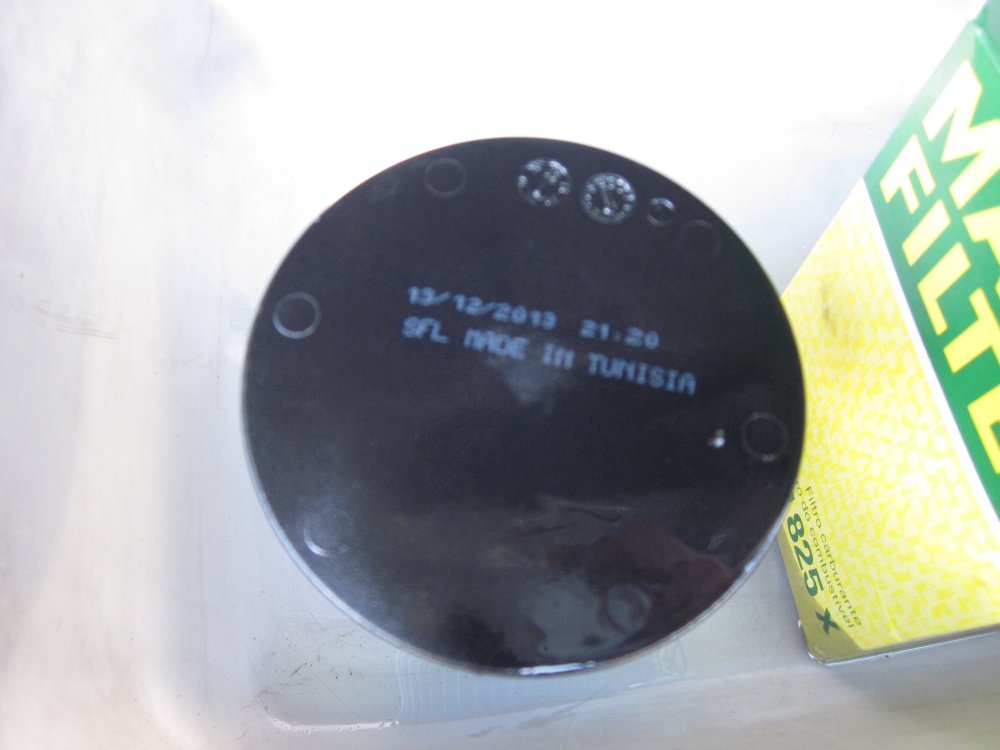

Follow a quick dash to the local motor factors in town. I gave them the VIN and they brought out the correct filter. The old filter simply pulls out of the filter housing lid, the long stem is part of the filter housing lid. The filter slides down over the stem and off. The new filter is fed over the stem and is a tight push fit into the filter housing lid. Job done, no thanks to Rainworth Skoda parts department!
£8.50 lighter for a non-branded filter but at this point my options were limited!
