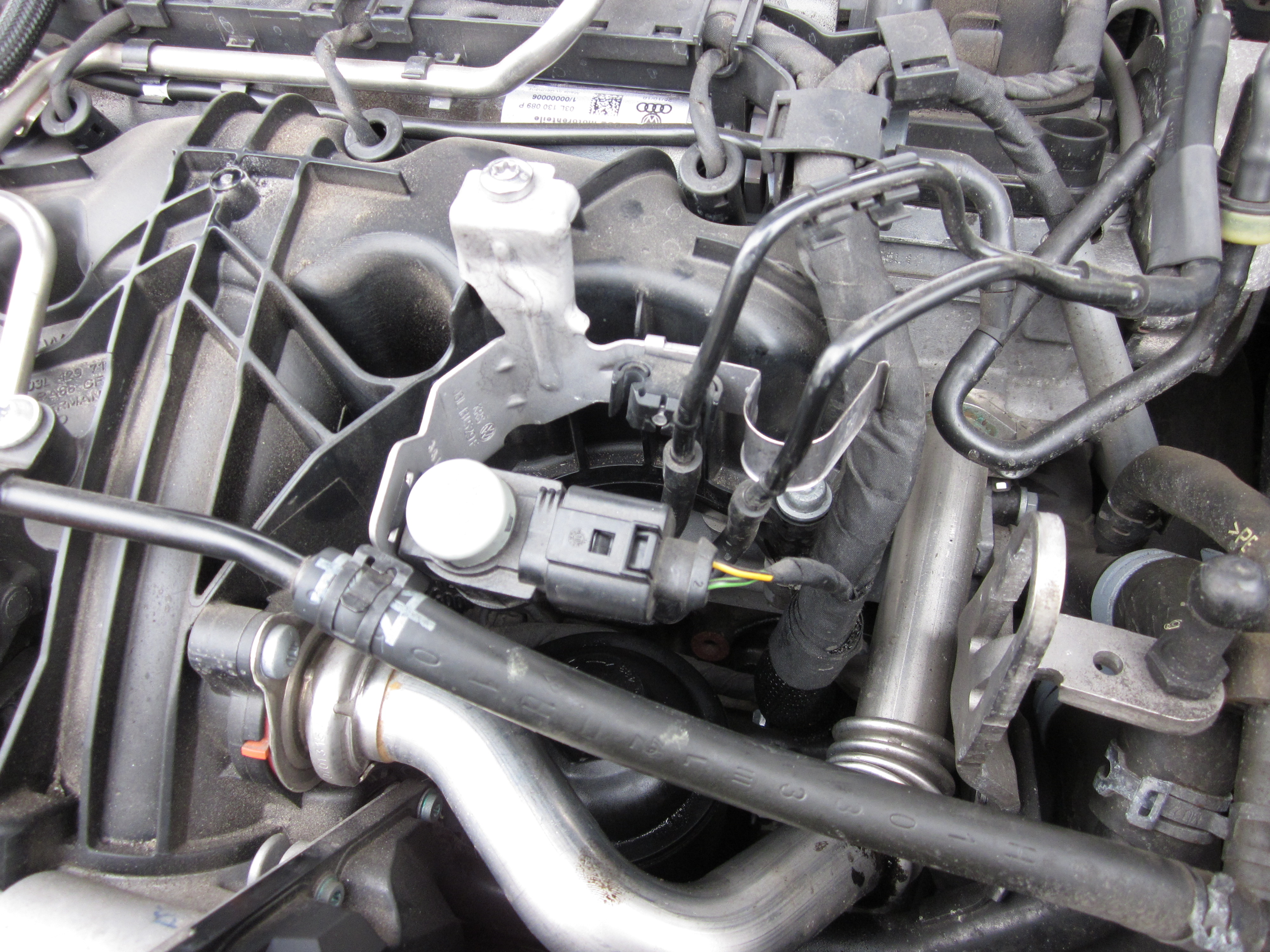

  • Oil in and up the the MAX level!   I then put the sensor back in place, being sure to push the little rubber tubes back into their seats too...   Wiring harness back behind it's U-

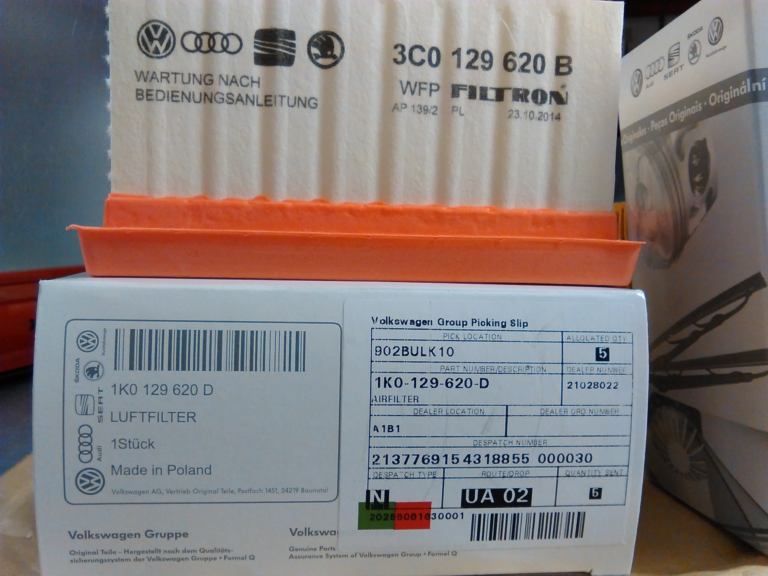

  • There is a little shelf in the bottom of the filter box that simply lifts out...   I could see some leaves underneath the tray...   A quick blast with the hoover got all of the tin

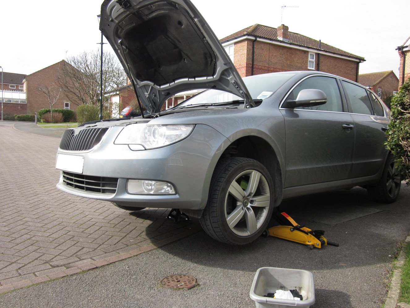

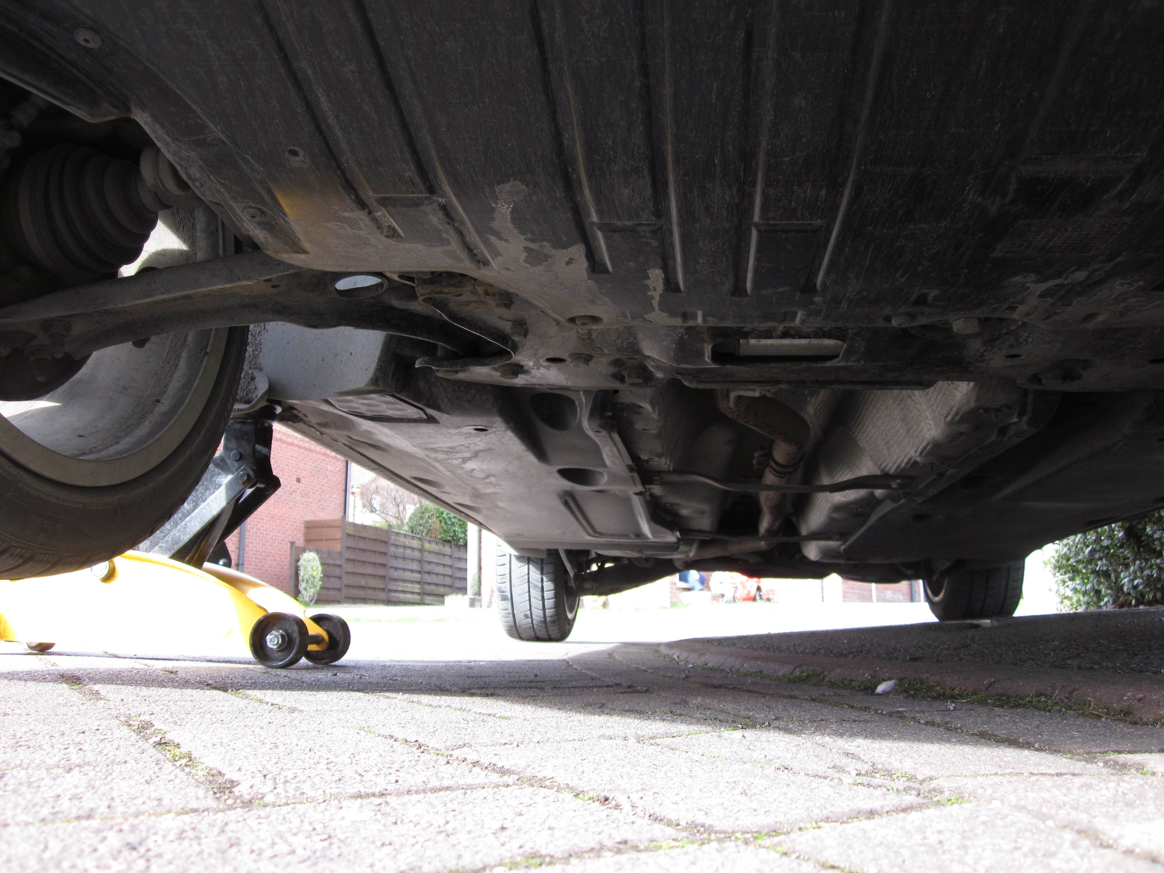

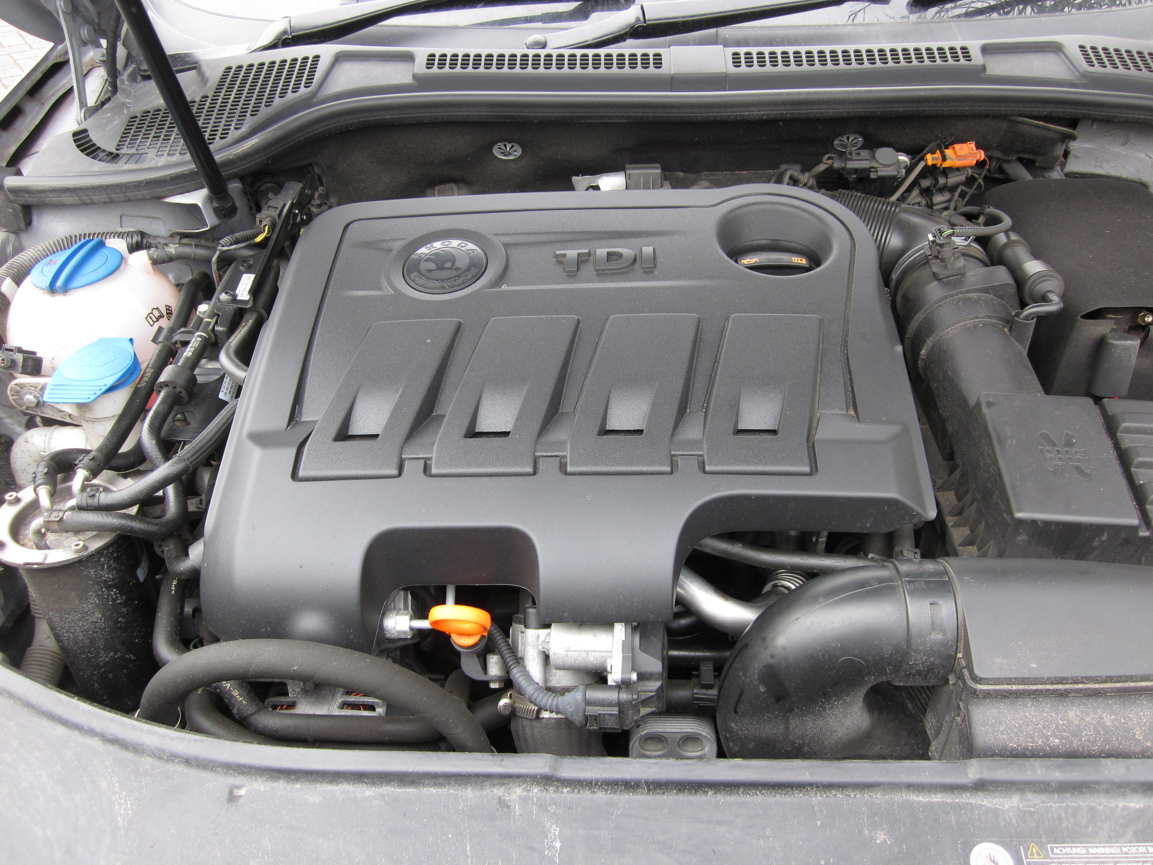

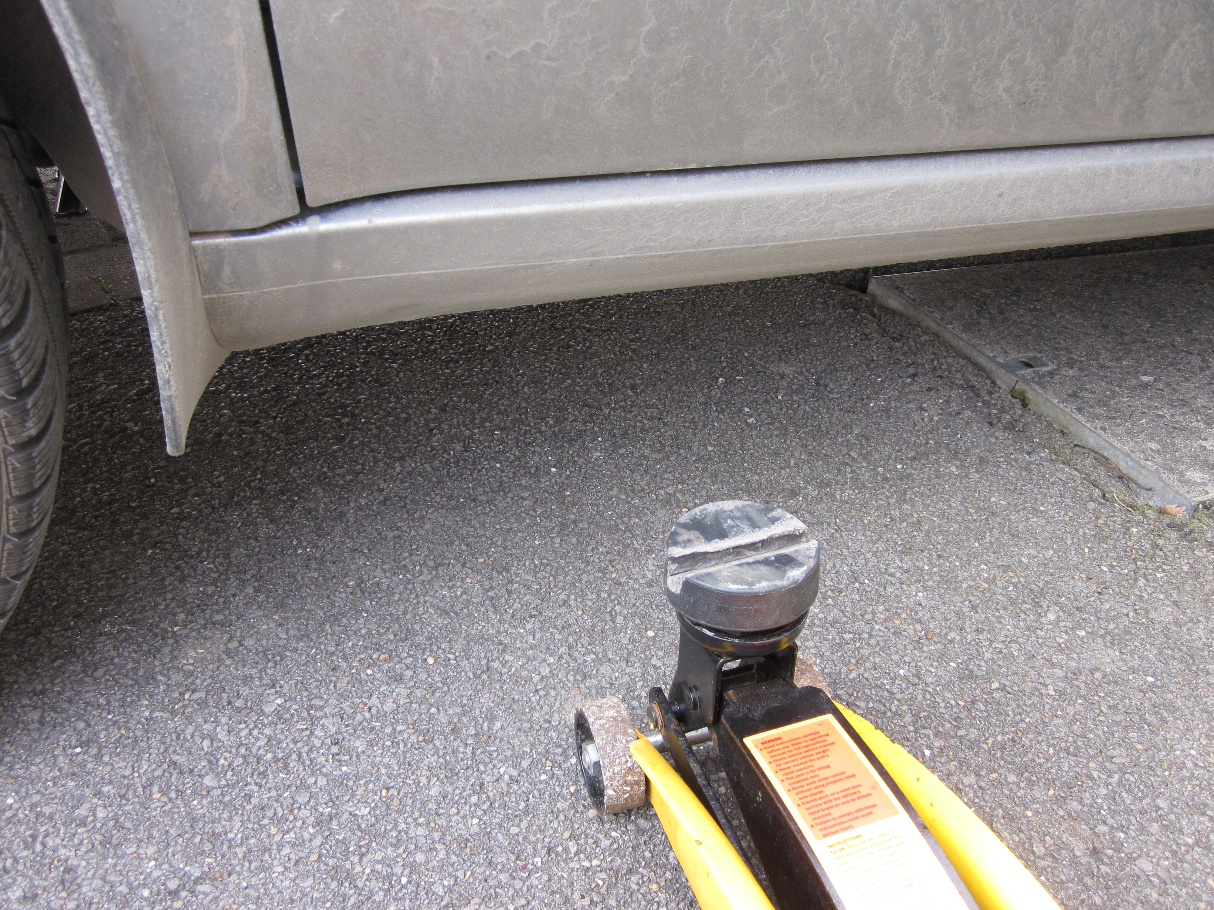

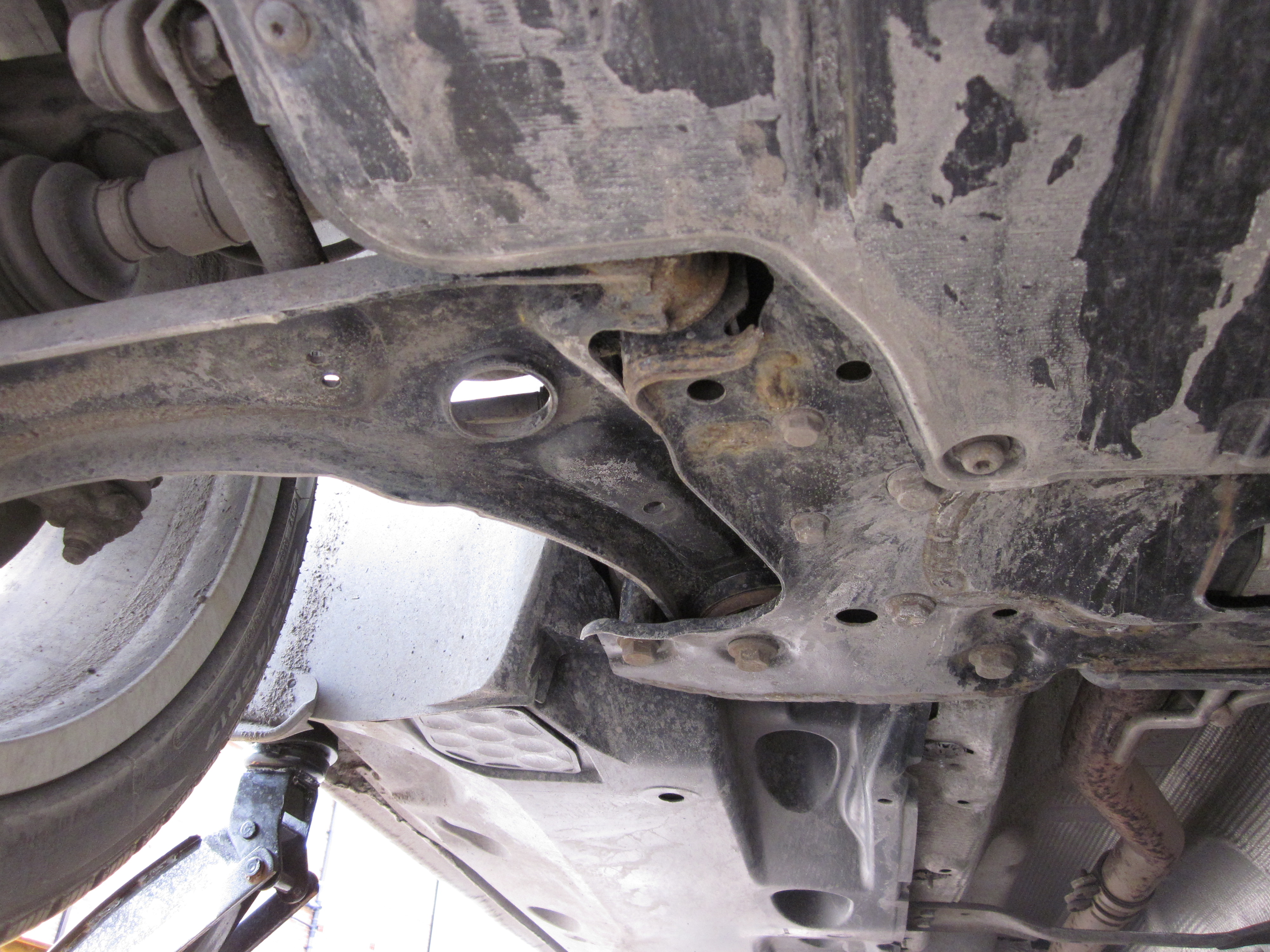

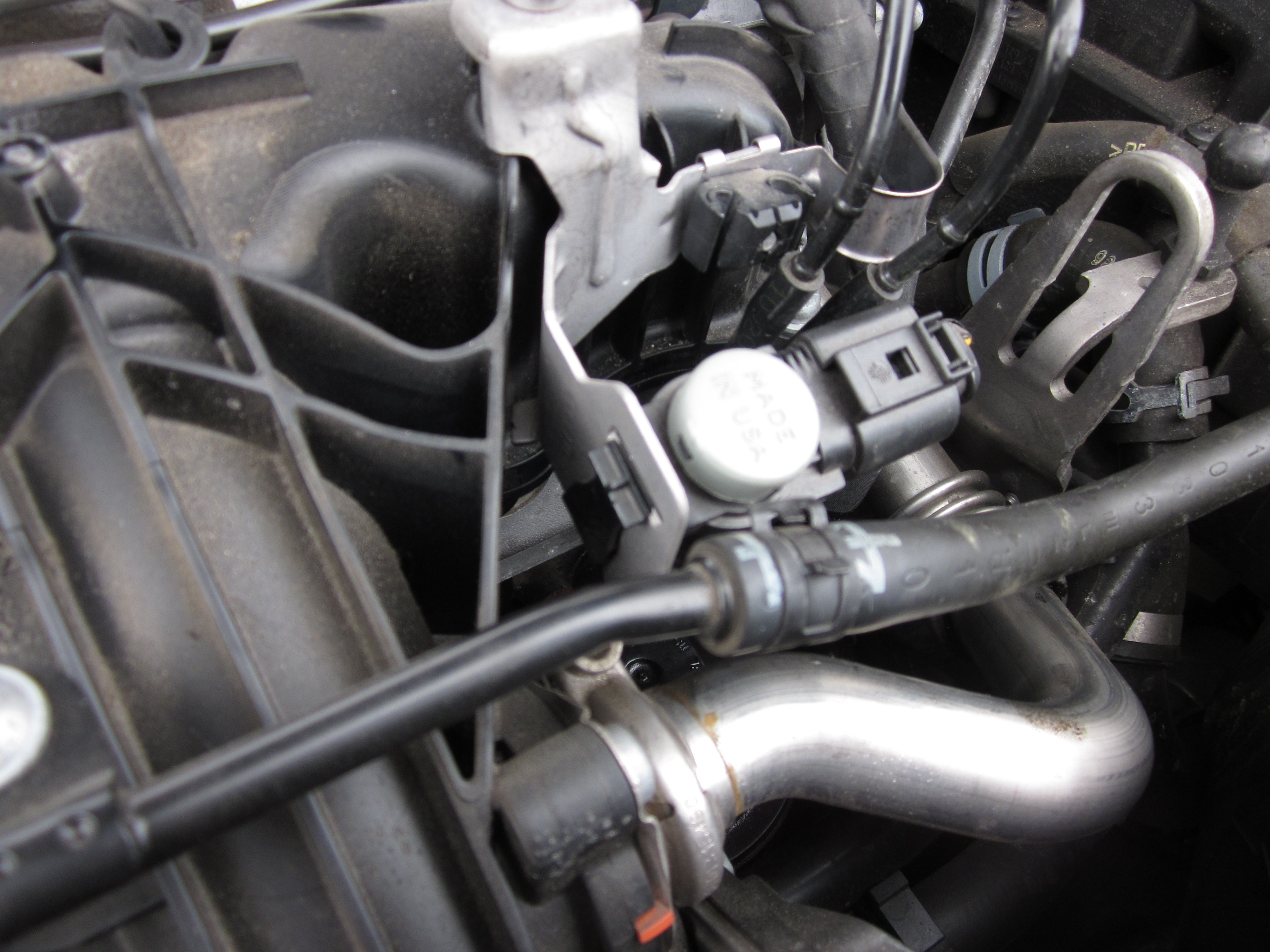

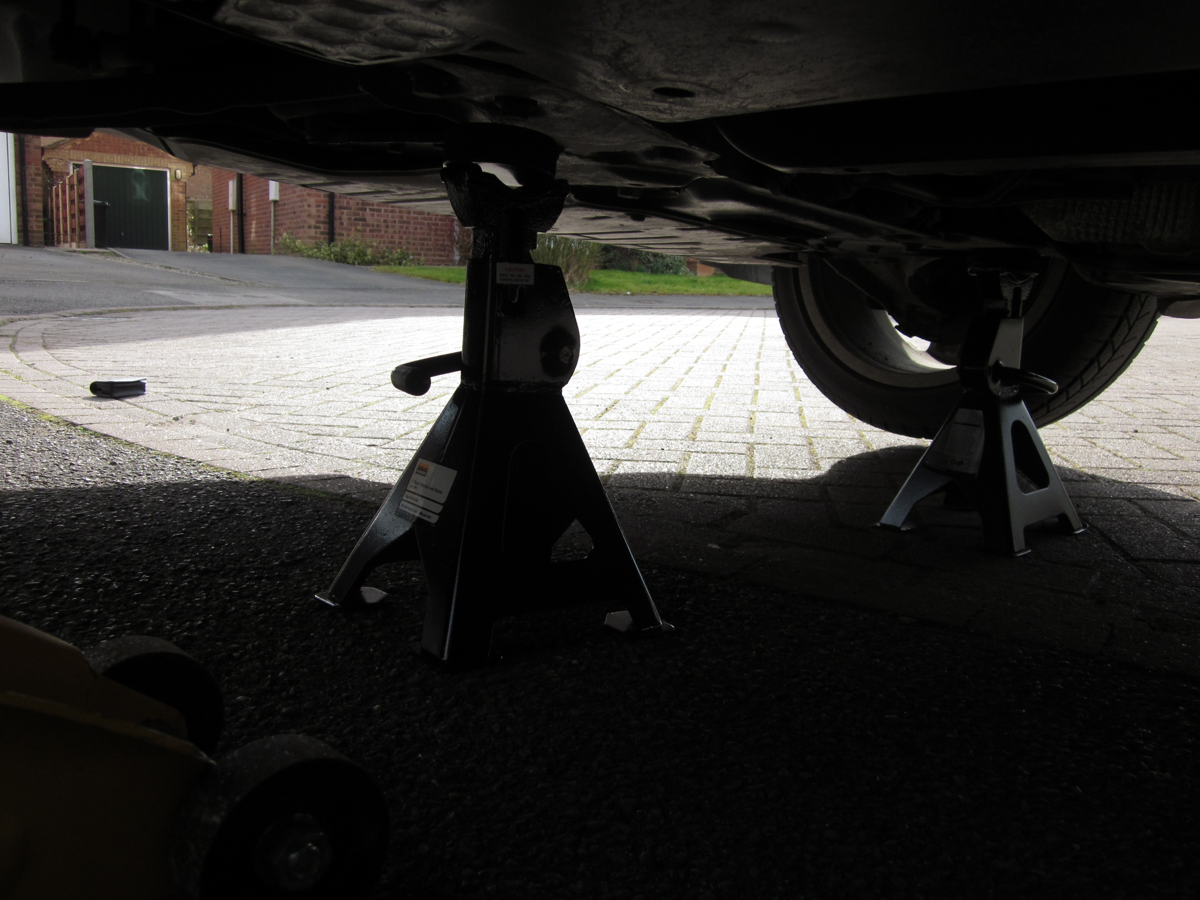

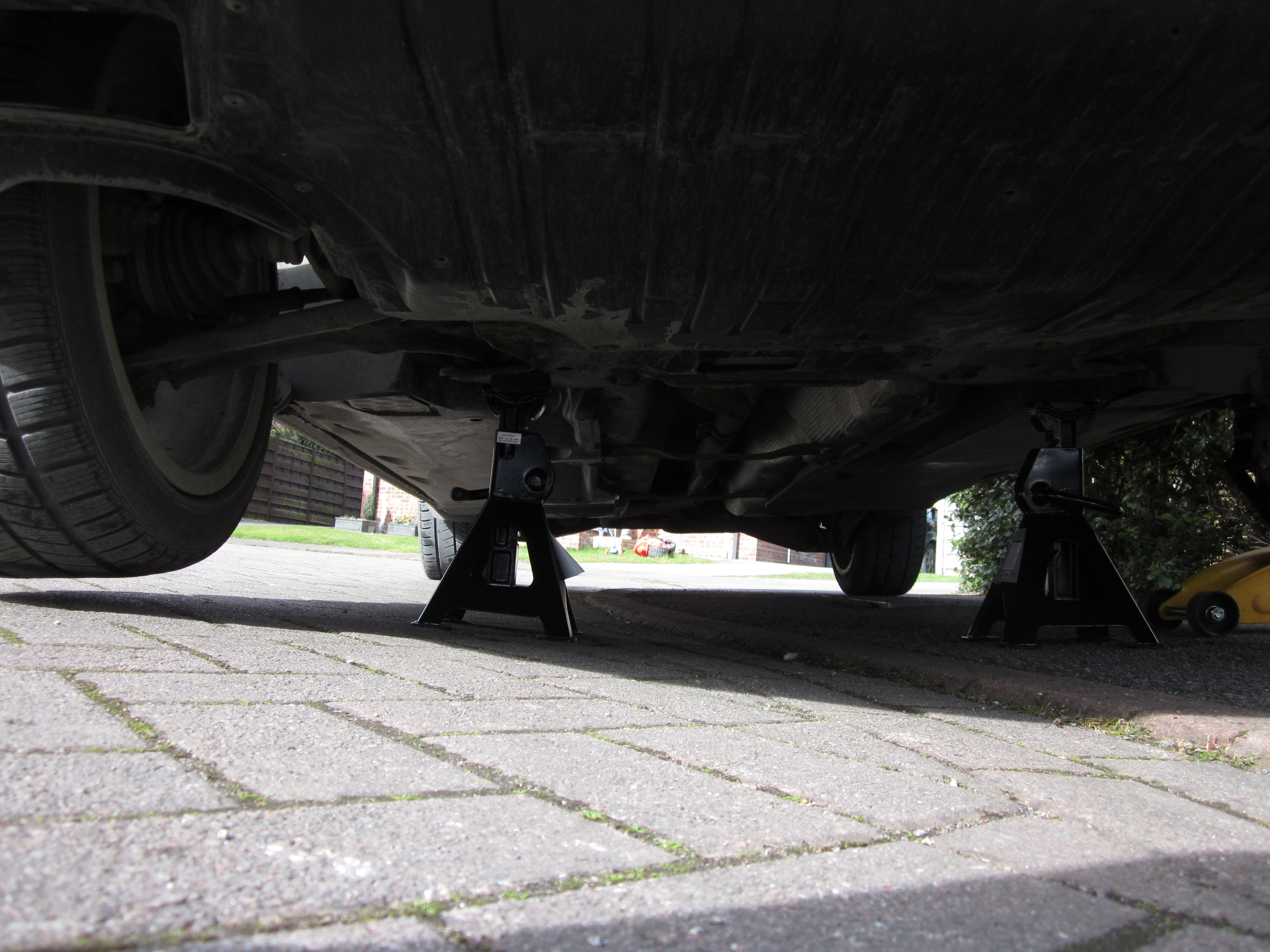

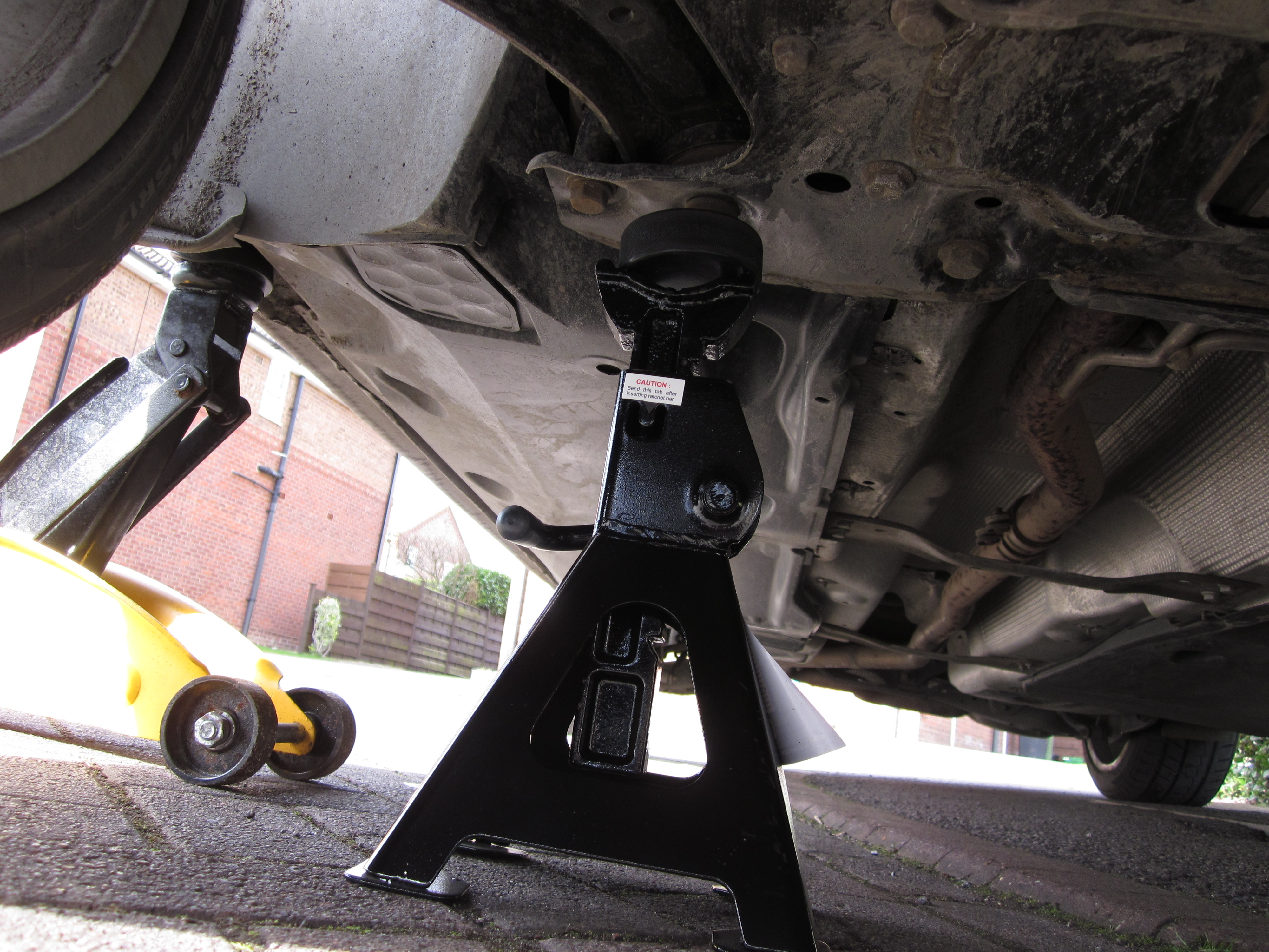

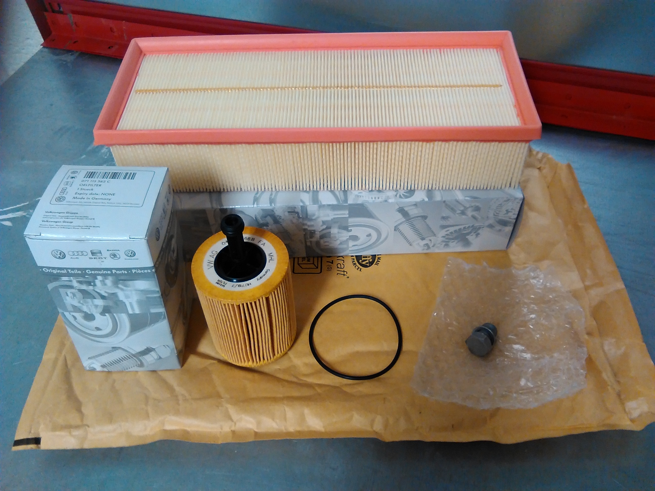

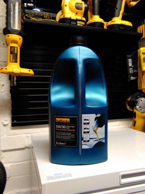

Here are the pictures from my opening posts, although you'll have to work out which ones go where!
