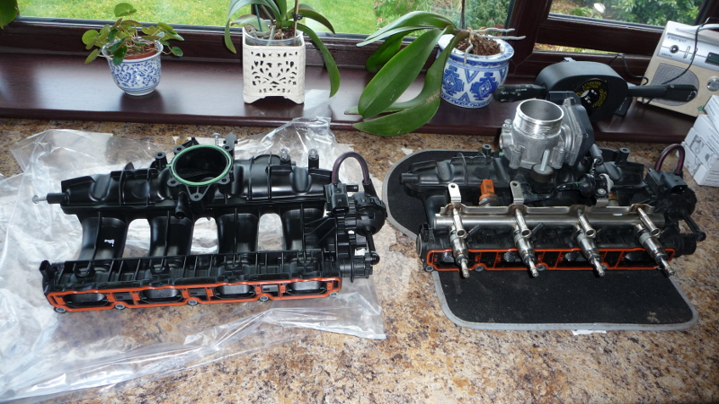

New Tsi intake manifold and decoke

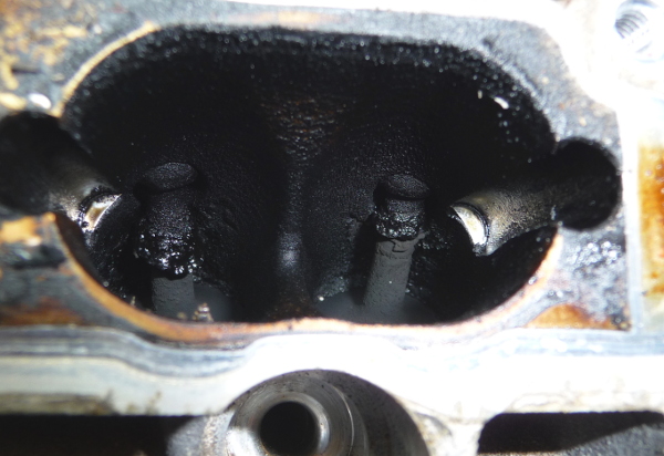

The same cause of the sticking flaps - oily fumes from the crankcase breather - also slowly carbons up the engine intake valves and can reduce performance.  None of the detergents in petrol, seafoam etc treatments can do anything about this.  I was intrigued to see what my valves were like so, rather than pay a garage for quite a few hours to renew the manifold and do a decoke, I decided to do it myself.

Your build up isn't that bad and a chemical inlet clean before each service would probably be beneficial in reducing the amount of build-up
For modern direct injection cars I completely agree that the petrol quality has no impact whatsoever on the inlet valves coking up. I will say that my injectors were as-new with no obvious build up, so good fuel must have played a part in that.
I will admit that I haven't tried seafoam myself - I've just read a lot of conflicting (i.e. polar opposite) opinions regarding its effectiveness, mainly on VW forums.  If you've had good results with it then good for you!  For me it it took a lot of effort with Valvoline EGR & Turbo Cleaner + brass bottle brushes and a plastic scraper to remove the carbon so I'm sceptical. However, rather than just pass on the opinions of others without proof myself, I'll happily edit my original post slightly to remove that opinion.
I put up the post as I haven't seen much on the forum about petrol decokes so thought the photos might be interesting to others.  Also, I enjoyed the work!

My 1.8tsi has 150,000km (90k miles).  The inlet was off at 95k km for a water pump and the build-up wasn't pretty.  My mech sprayed some solvent in the inlet but I doubt he did a great job (he was busy & wanted my car out of the shop)

Interesting videos and you may well be right that it could slow down the coking up. Now that I've taken the manifold off once I reckon I could remove and refit it next time in two hours.  Also, I'm pretty sure I can get a cheap endoscope through the in-situ intake manifold like you did for future checks before I do another decoke.
A bit off topic but all the advice I've read is that gummed up intake manifolds can't be repaired.  That's why I fitted a new one.  However, rather than throw away the one I took off, I'm investigating refurbishing it as a good spare. I've already cleaned it in the workshop solvent bath at work and silicon greased it so it doesn't stick any more.  I've stripped and checked the actuator diaphragm - no splits and in good nick.  That leaves the electronics to check. Also, there is a small oil seal fitted between the position sensor switch and the flapper shaft non-drive end which is in poor state and could have allowed crap into the switch.  If I can source the oil seal and check/clean/replace the switch (if needed) then I reckon I can make it good as new.

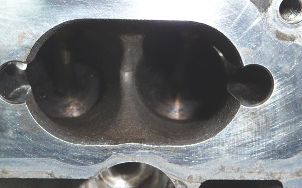

I decided that after trying a chemical clean that I would have to remove the manifold to assess the state of the valves as I still had an ever so slight hesitation at around 2000rpm. The car has covered 40500miles. the chemical clean had cleaned a little bit on cylinder 2 & 3 but had not done a great deal to 1 & 3. I spent 4 hours scraping at it with a screwdriver /  wire brushes, engine degreaser and carb cleaner.  The amount of gunk was unbelievable, especially on the splitters. They had thick built up crap on them.
All back together and now runs like a dream. Seems faster too.
I think now every time I service it I will be running a chemical clean to try and prevent it building as as fast.
