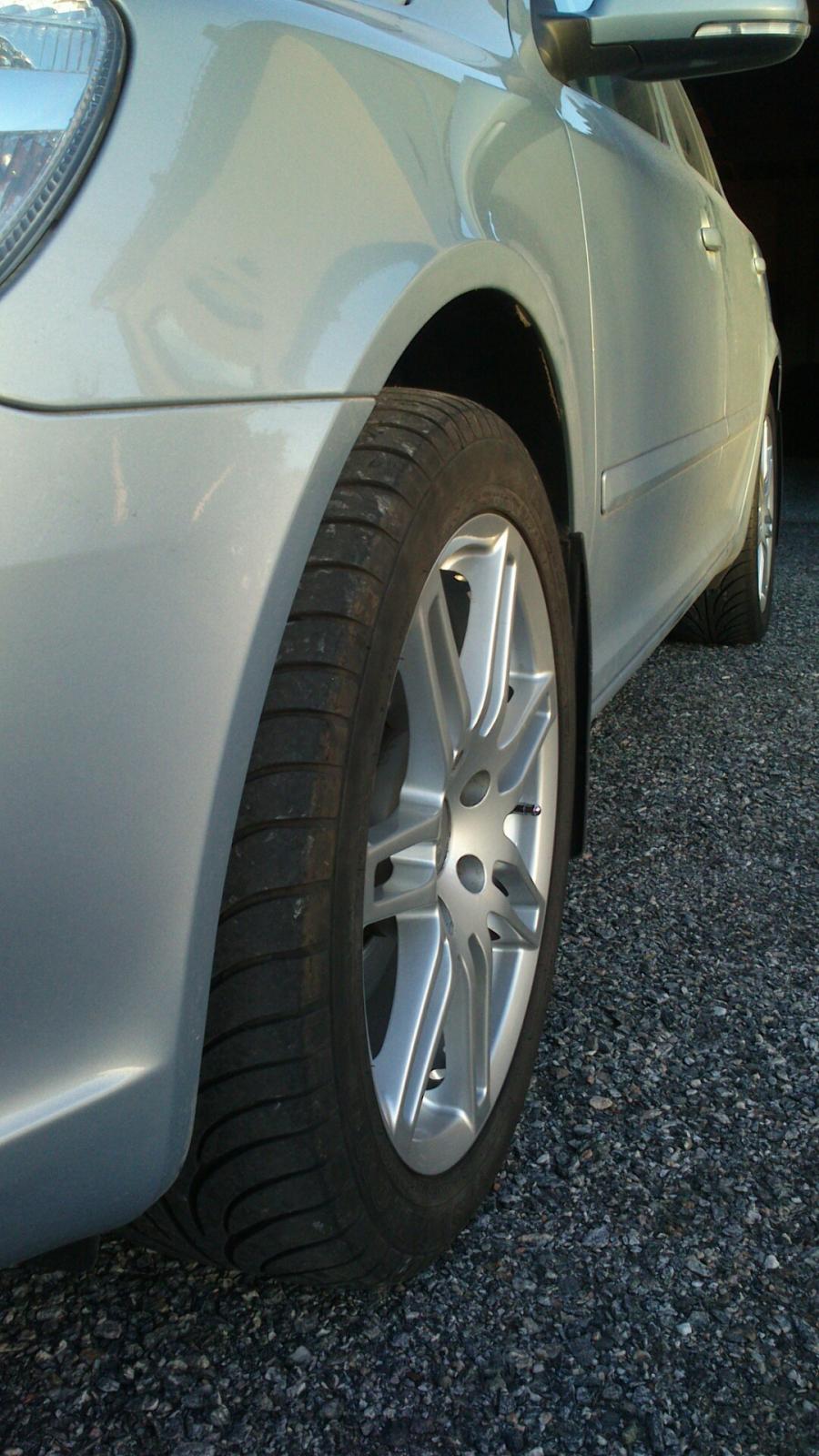

This is how it looks, not too obscene I guess.
They looks fine! And nice rims too, do you have dimensions of them?
Crap photo but they seem OK.
What size rims?  They almost look like TT rims but they aren't wide enough for that.
LOL...I take photos for a living so excuse me not getting my DSLR out. They were sold as from an A6 but can't be sure on that
