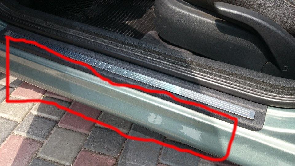

 Has anyone ever fitted and clear sill protector film to there Superb? I already have the black/silver covers that say "Laurin & Klement" I am looking to cover/protect the lower section (as highlighted in the picture)
Getting in and out on my garage I have caught the painted area a few times, so far no damage.. but it would be good to protect it :)

I have used this stuff for many years on the sills, leading edge of the bonnet & the leading edge of the roof to windscreen if you can buy it large enough and your front bumper is like new  its stops many a stone chip, also can be used on the car body just behind the rear doors. Just using it on the sill, remove the L&K plates wet the area with a mild soapy solution ( a drop in a pint of warm water) apply to sill, this allows you movement of the sill protector, squeegee the water out, you many need to use a hot air gun or hairdryer to work the protector into the correct areas. Look on some of the Chinese web sites CEO1 or similar for this stuff at half the price you would buy it here for.

are you sure? that is only 50mm wide, I ordered the 150mm wide so it will go from the skoda protectors with laurin & klement on (or just superb)
all the way down to the line where the sill is armour coated.
The two scratches I have are only just up from the armour paint.
Should be OK, I only want to protect the edge ... :)
