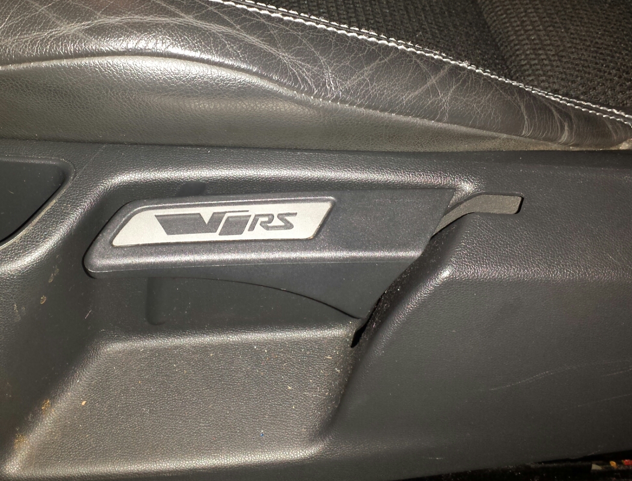

post-112017-14277528688899_thumb.jpg fitted these vrs plates for my seats thought it would be a nice finishing touch
