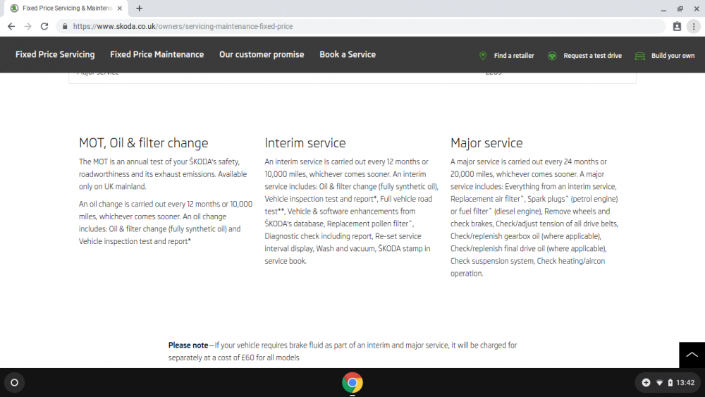

Those that have Skoda  Main Dealer Servicing sometimes find out that the wheels are never removed even though they are paying plenty for the Fixed Servicing offer.
Belts obviously not checked either if they are not visible.
