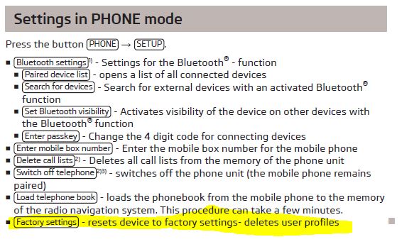

Looking at the manual,
I have done this on my Columbus and it wipes all phone setting/paired devices..  You will need to re-pair the phone ;)

I did it on my Columbus and it cleared everything, just had to re-pair the phone and it downloaded the phonebook :) I presume the Amundsden is the same
No joy The Amundsen+ appears not to have a facility to "Delete Call List"

Oh crap.... When I did mine it deleted everything, I repaired the phone and it asked if it could download the phone book, starting from scratch....
