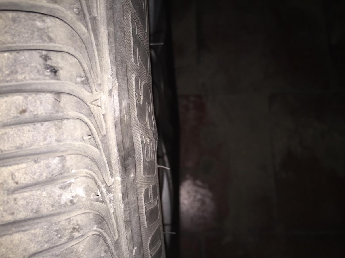

Hello,
I have a trip tommorow about 450km and temperature will be around 33c....speeds about to 140-150kmh
Is it safe to travel on this tyre? It has a very small bulge (it seems even smaller in real life)
I know its dangrous but it has only 32000km on it and lots of people said since its very small its ok
Please advise
Get it changed to be on the safe side. Last thing you want is a blow out.
Might be able to get it changed for free if it's found to be a manufacturering defect

Replace as soon as possible.

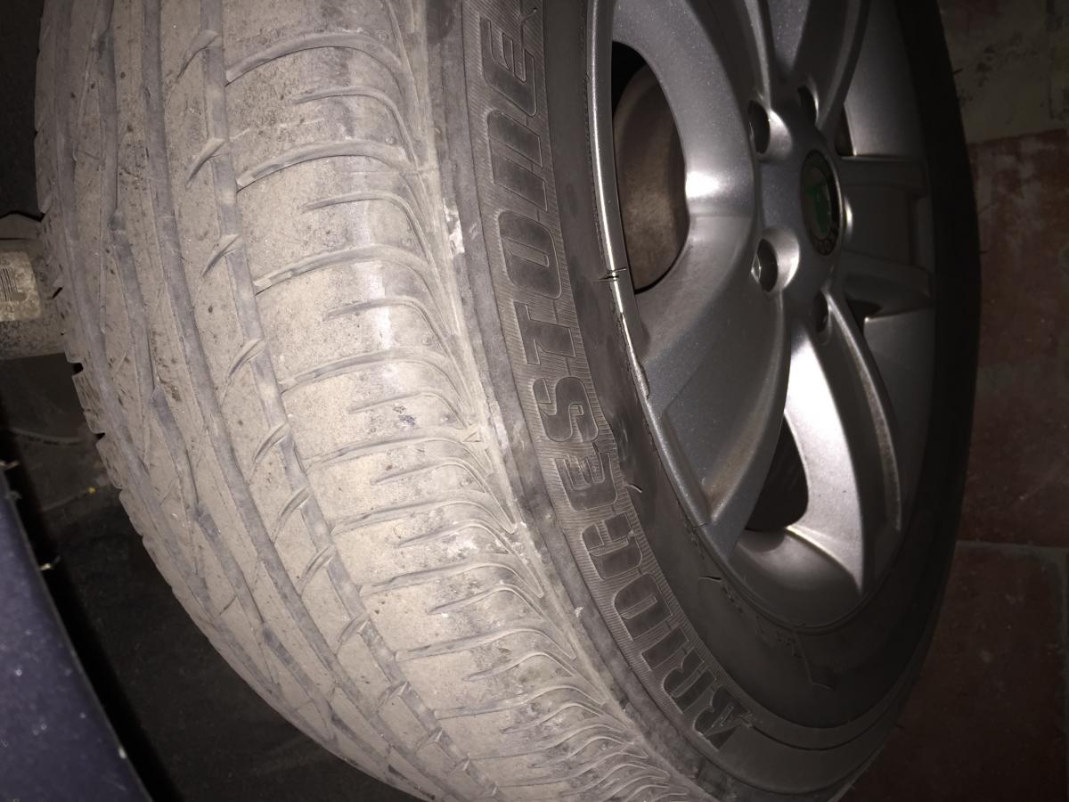

It's fu##ed, that must have been some impact. You can see damage to the paint on the alloy.
As above that tyre has had it.
That tyre is dangerous and illegal - worth a good few points on your licence

That is an impact fracture.  The cords holding the rubber together have broken.  It's fubar
