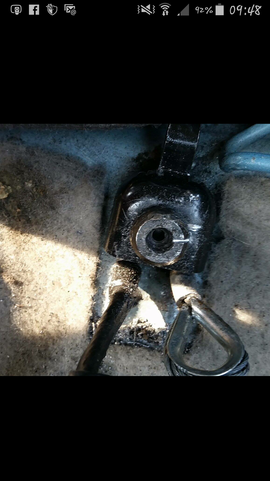

Can you post pictures of both ends of the bolt?
Makes it easier for us to "see" your problem.
If you only have a minimal toolkit, it might be advisable to get some help before you damage it too much.
Not the best picture, as you can see I've already tried drilling the bolt out. The other end of the bolt just sticks out under the car about 2 inch and is just threads
Not ideal because you've already drilled the centre, but sometimes you can cut a groove through the top with a hacksaw and use a big bastid screwdriver/ratchet for some purchase.
If you do have 50mm of thread showing under the car, then it should be possible to wire brush the threads then lock two nuts together and loosen the bolt that way, but it will need to be cleaned and soaked in a good release agent.
I'm going to try getting it out using 2 nuts, hopefully it works.
