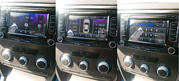

Can anyone ID this Chinese head Unit?
Got it nice and cheap, it works fine apart from the door open indicator as seen in the photo. It seems to mix up the signals from the car and shows nearside door open when offside is open and vice versa. It's not the car sending the wrong signal as the maxidot display shows the correct door. It has no name on it or within menus so would like to ID it to possibly find a firmware update or resolve the issue somehow. Not a big issue i guess, just a bit annoying. thanks

Does it just think the car is LHD? Maybe it doesn't recognise left or right but recognises driver or passenger door. Possible setting somewhere?
This was my initial thought to but the language is set to UK and I can' see a LHD option. It is a cheap one I know and I know mikes thoughts as they are similar to my own in many respects. That said it was £75 and came with external mic, reversing cam etc so was a bargain and will do until i can afford the columbus.
Maybe it just assumes LHD...
Thanks to all for help, i found that it is a witson and entered secret menu using this video:
https://www.dropbox.com/s/k2n34ez2iea0kwn/d9235secretmenu.mp4
Was set to door: Europe :D all working now and managed to turn the TV off so that doesnt appear in src selection now :D
