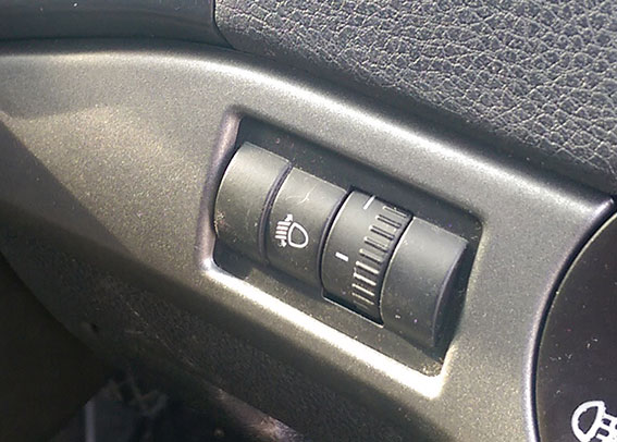

I have this:

Well it arrived today and it was a straight swap no additional wiring needed. I now have this 'luxury item' fitted :)

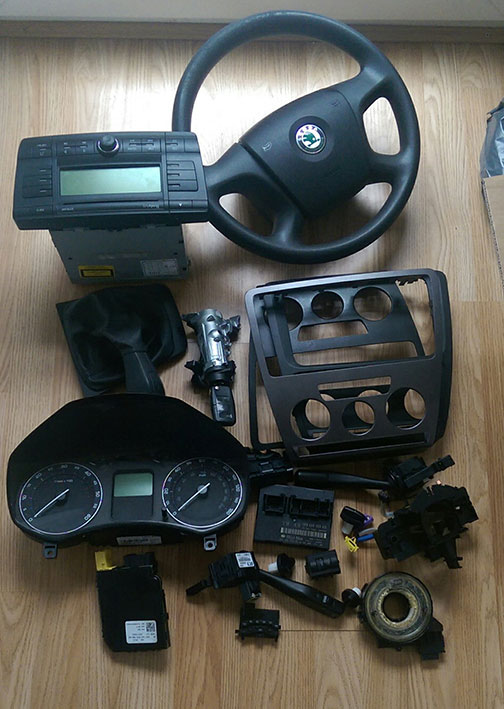

I am getting quite a collection of useless spare parts :D
Not worth selling really they are all basic spec parts, I have been giving a few away here and there

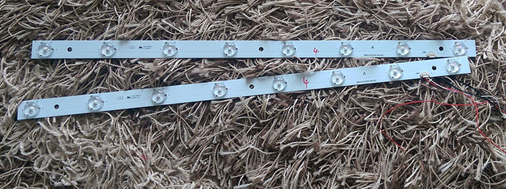

I'm working on footwell lighting now, 12-24v LED's taken from a TV. Perfect length within mm for the underside of the dash. As they are from an LED Tv the voltage is variable for backlight brightness. Just trying to work out the wiring which I think I have sorted. Took a repair wire from the chopped off connector that came off my new clocks. May have to upgrade my CECM but not sure yet as vcds shows it as an option. A bit ghetto I know but i'm running out of things to mess about with. No idea if it will work.
EDIT...scratch that they don't light at lower voltages lol, the dimming won't work!

Ooh, instead of those strip things why don't you go for a kit which wires properly into the fusebox and illuminates the front AND back? Think it's about £20 on ebay, sure someone on here will come along with a linky... :)
I had the strips and nothing to do with them, no other reason really :)
