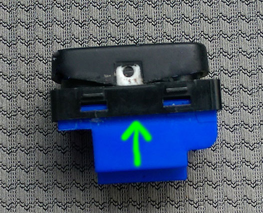

Next on pic one get a small flat screwdriver and insert between the blue and black parts and prise in direction of arrow.

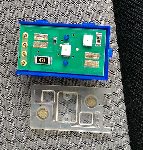

Once open it looks like pic 2
Remove rubber part and clean the conductive rubber pads with a cotton bud and alcohol or the likes
I scraped the brass contacts with a screwdriver to clean them but there are likely more civilised ways to do it
Re-assemble and reconnect wire before pushing it back in its hole as it would be a nightmare to plug the wire in once the switch is back in place.
One working switch that I now barely have to touch to operate

Having had a semi functional switch for some time now (locks ok but will not unlock, no matter how many times the switch is pressed), I followed your guide with ease, accessing the switch through the gear lever gator.
On dismantling the switch I expected to find the circuit board and contacts "gummed up", but was surprised to find this was not the case with minimal, if any, signs of anything to interfere with switch contact. After cleaning both the circuit board contacts and the small rubber contact pads using some isopropyl alcohol and a cotton bud, there was some visible "dirt" on the cotton bud.
Having reassembled the switch I am pleased to report the switch is now working as it should.
