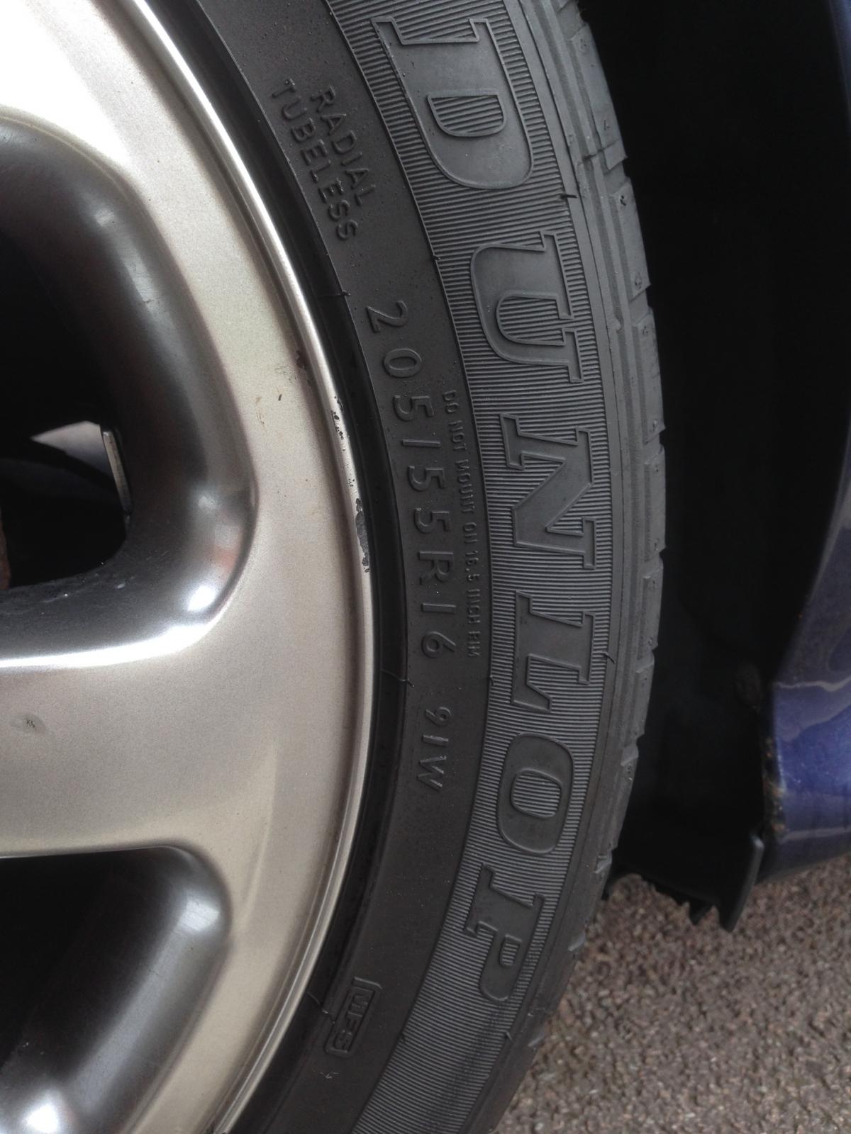

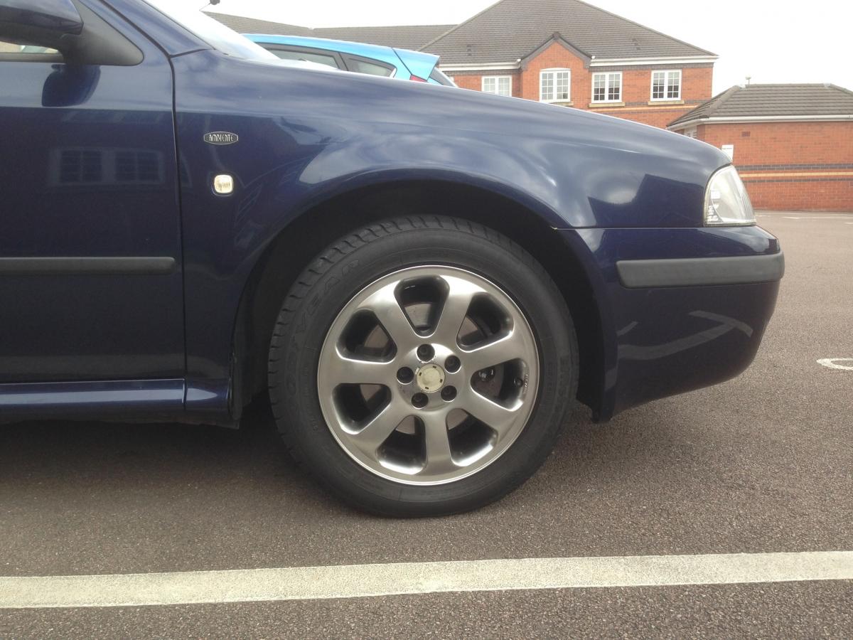

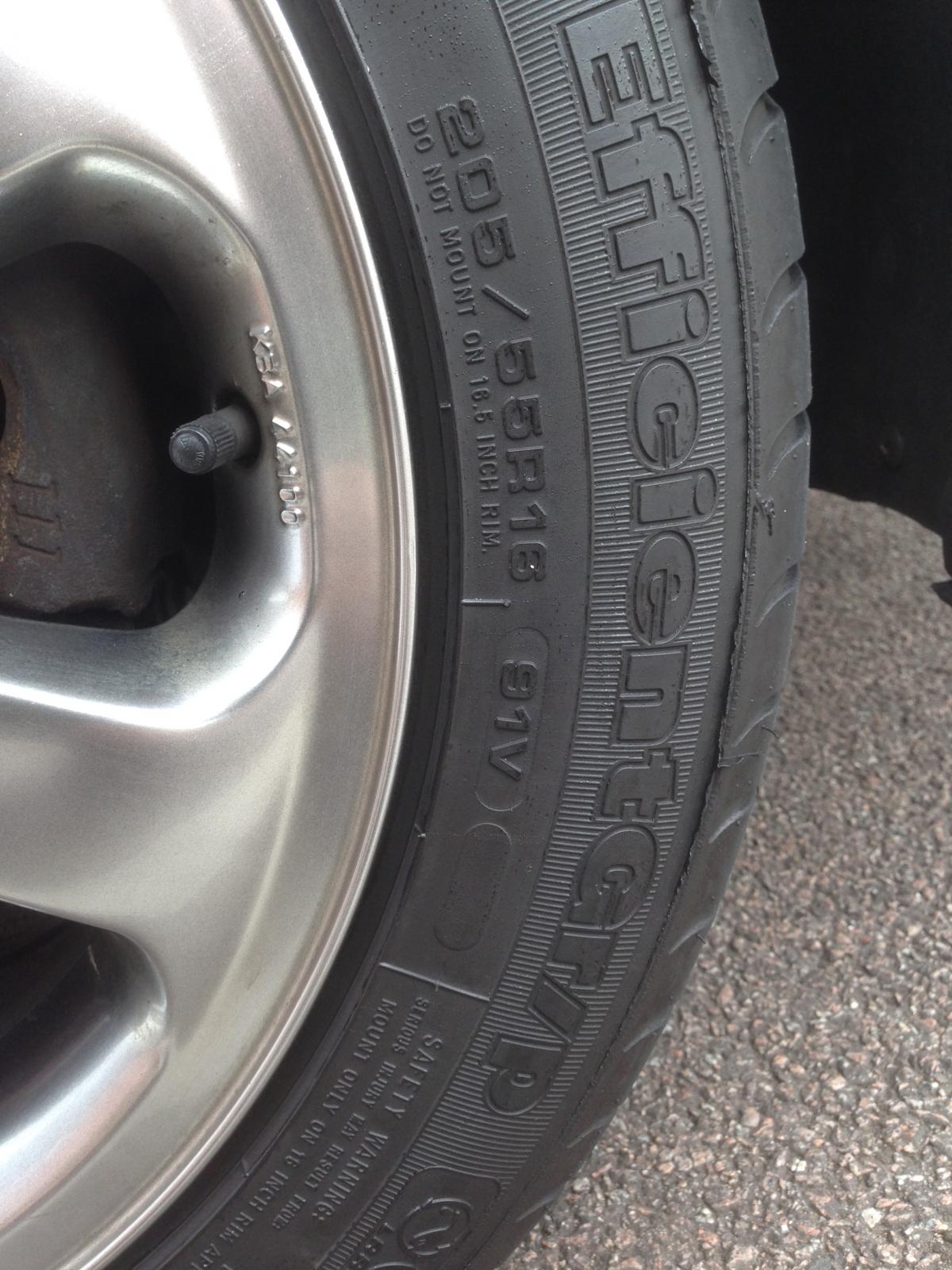

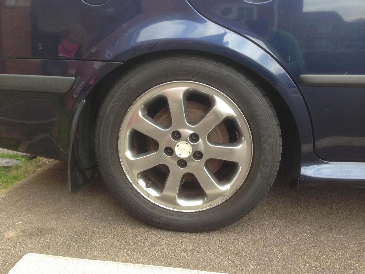

Just put the 16" alloys on mi car and drove with it yesterday and everything was fine but this morning when i drove it again i heard sound like when the tyres hitting the inside of the wings. That sound was coming from rear axis. Tyres are 205/55 R16 on all 4 wheels. Front is looking that the tyres do have plenty room but rear one are quite low.
Alloys are original Skoda Octavia L&K model 16"

That looks a bit low on the rear with 16's on I'd check your rear springs aren't snapped?
I've got 17's on mine with no issues at all.
Yup it is the rear spring. I have lied down under the car and the top end of the spring has snapped and fallen inside the spring together with that piece of rubber that is usually on top of the spring.
It must have been cracked (half of the spring is rusted other half freshly broken) in the past but was holding together until the mechanic dropped the car rapidly on the wheels when changed them. Is it difficult to replace it? Can i do it mi self on car park? And what everything do i need to do it?

Springs replaced and car back in his proper hight. Thanks for advice lads.
