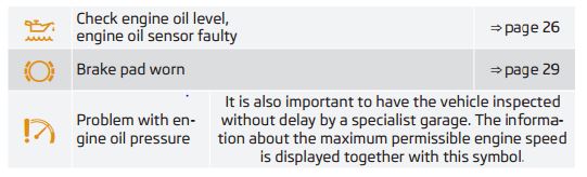

There are two lights, one for the oil level and one for the oil pressure, which one is it?
The top one with the oil can mate
