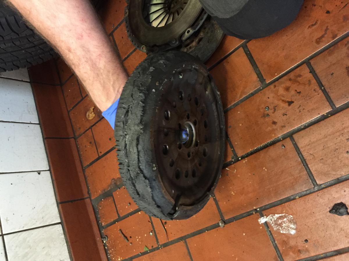

Attached is a photo of the flywheel replaced today. Safe to say that indeed was the problem. One of the mechanics said it was the worst they'd seen.
Many thanks for people's post. Greatly appreciated.
Photo attached
Looks well used that!
You've been lucky, could have nearly been a gearbox as well!
