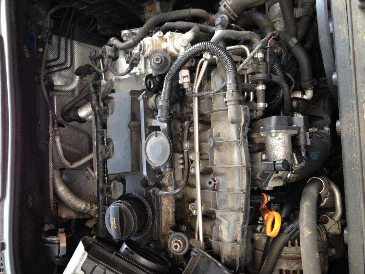

Where is the diverted located please anyone ?
Any ideas ??
Please ?
On the TFSI the std diverter valve bolts directly to the turbo, a regular BOV/Dump Valve won't fit as they are designed to be fixed to a rubber or silicone Pipe.

yes its the same as the link you first posted up. put the car on ramps and take off the cover underneath the car, then you can see where it is, it fits between the diverter and part of the turbo,for fitment the best bet is to buy the forge one. check the condition of the diverter valve while you have it off the car as it has been revised over and over again as they tend to fail.
