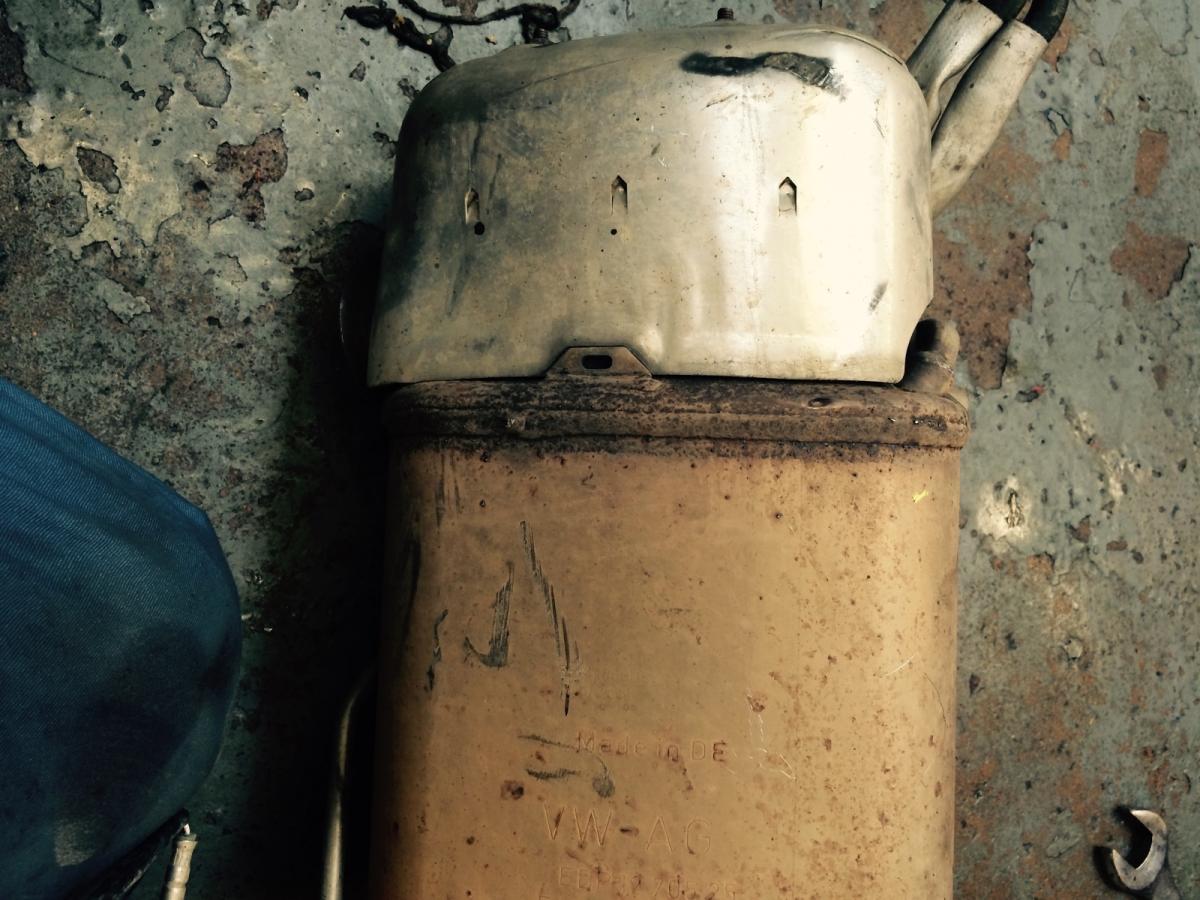

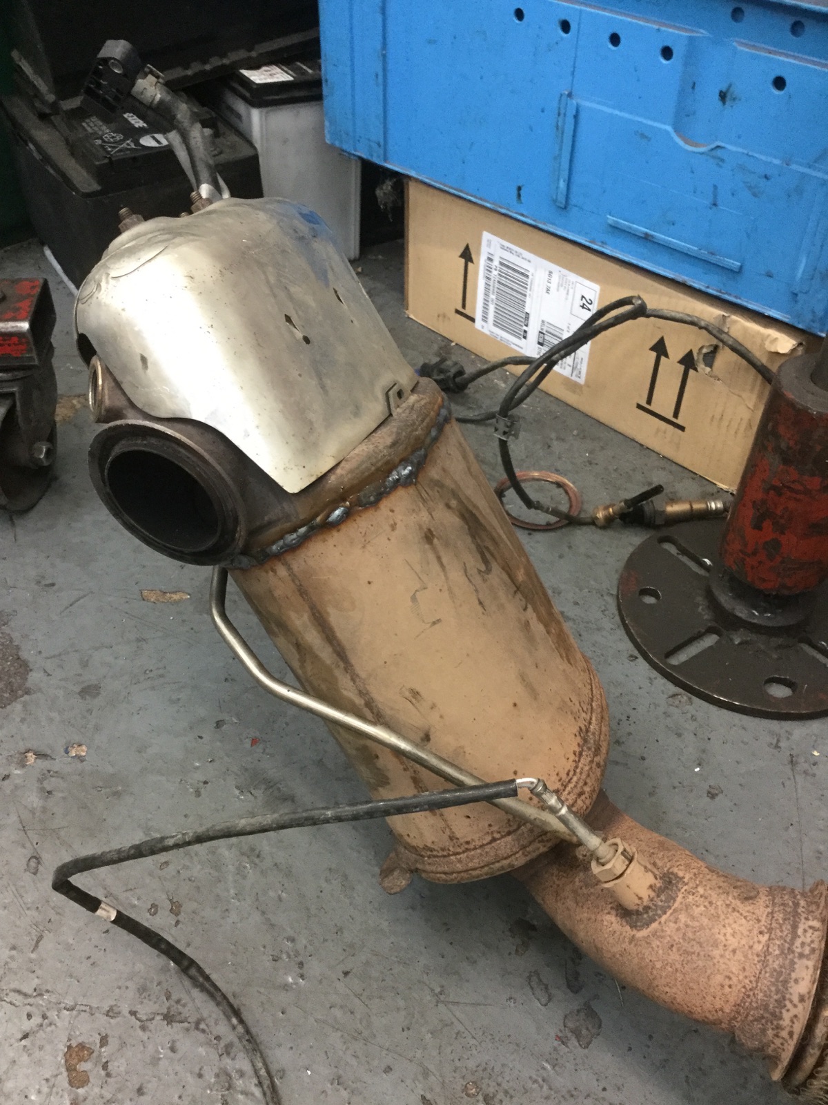

Well, it took a long time, but after finding and using a local independant VW garage, the guy has been excellent and not accepted the non clearance of the fault code. I ran 3 tanks through with the Wynn's DPF cleaner (that was fun ;-) ) when he couldn't clear it first time and they still couldn't get it to come out of limp after the 3 tanks. The garage then tried their own road test, nothing, then bought a new tool to fire cleaner directly into the DPF apparently, this still to no avail. Final solution for my perplexed garage was to cut open the DPF, inspect, clean over night, re-assemble and this finally cleared the limp. That and a lose hose and its now A1. So took a while but saved a new DPF and Turbo, by going to a conscientious independent VW dealer, very impressed.

post-52897-0-49277100-1444655845_thumb.jpgpost-52897-0-14499600-1444655862_thumb.jpg there is a cool video of it blowing foam out the exhaust, but I couldn't attach it...
