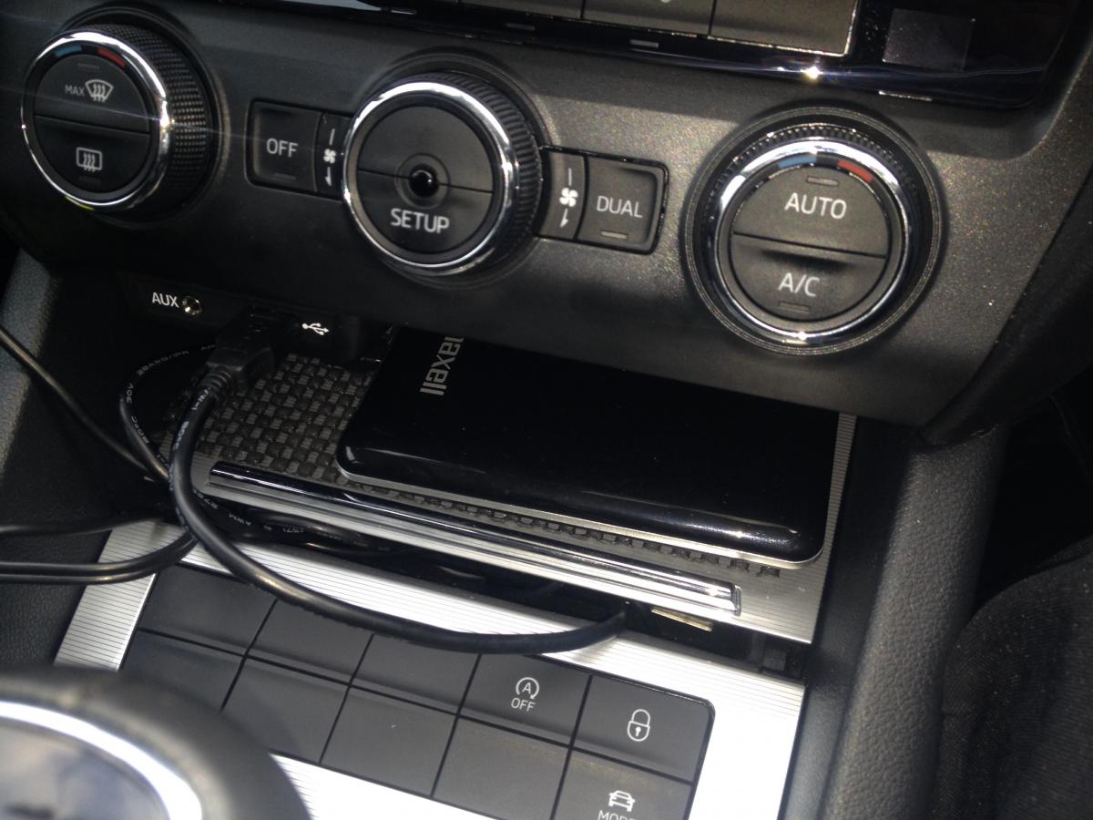

I'm currently using an external 500Gb portable hard drive ,which i got from ASDA for £30 ,into the USB socket. It has to be formatted in FAT32 , so i had to use a program from Verbatim website. I have it sitting on top of the front ashtray cover.
