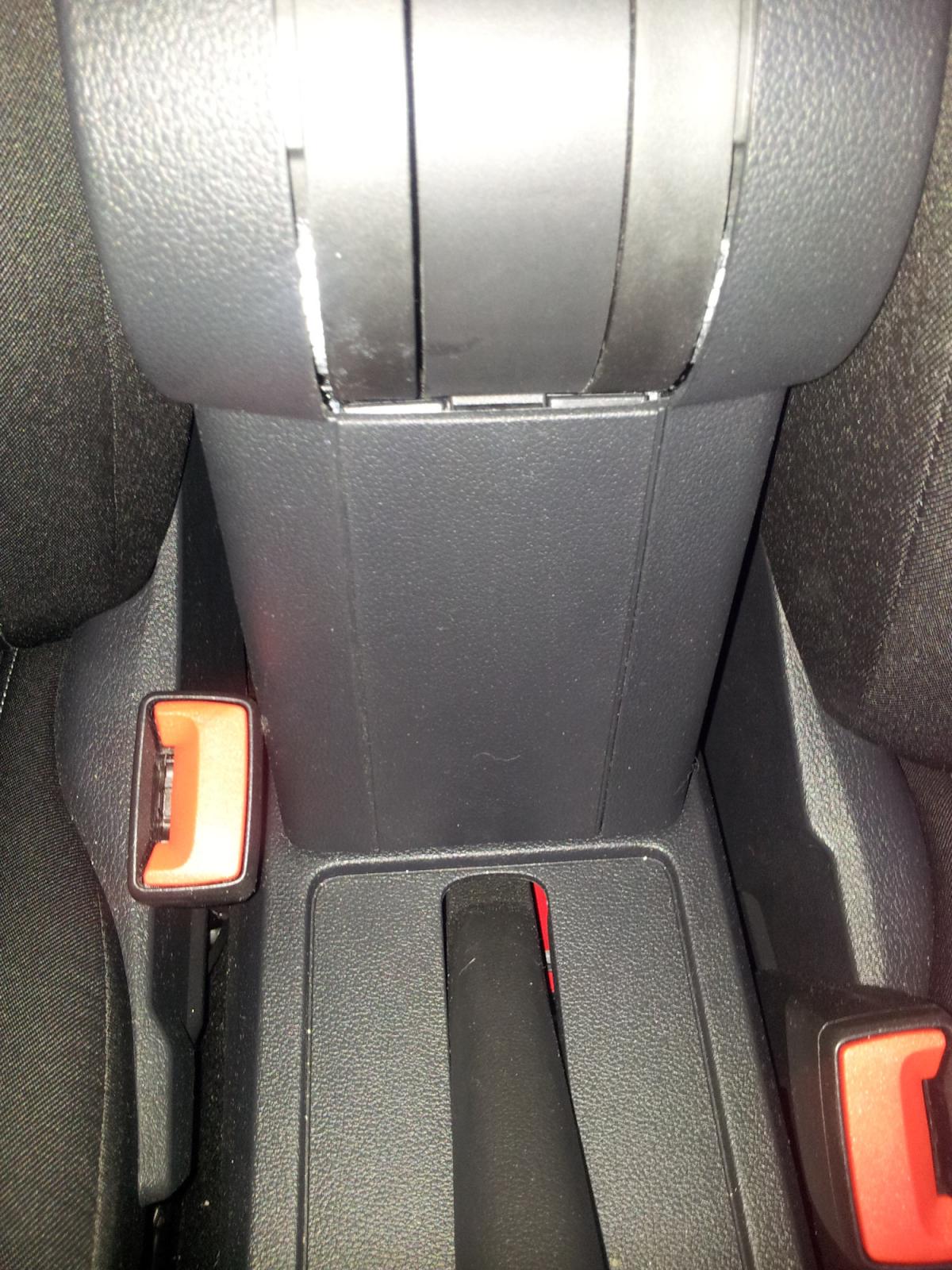

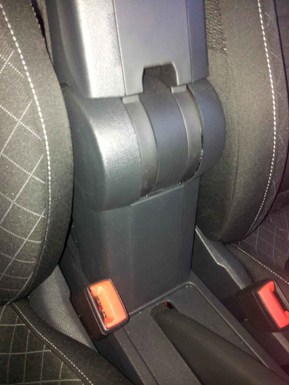

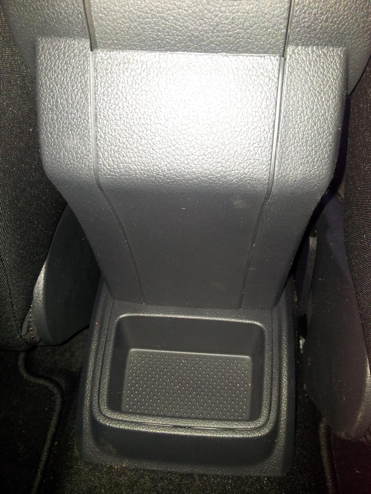

Attached are some pics of the armrest.
The third one shows why it's in the way, even in the upright position. I'm all legs so have the seat right back. In this position, the armrest is actually forward of the seat and somewhat annoying.

I completely agree with you Prog, i'm 6'4 and it really does get in your way and keep banging my elbow,  my partner 5'6 has no problems. It is sat way to far forward and just doesn't work with the car. From the looks its not moulded in so you don't need a whole new center trim, like you say its what's underneath. If someone could post a picture of the SE it would be much appreciated.
Yes, if it was mounted further back it'd be fine.

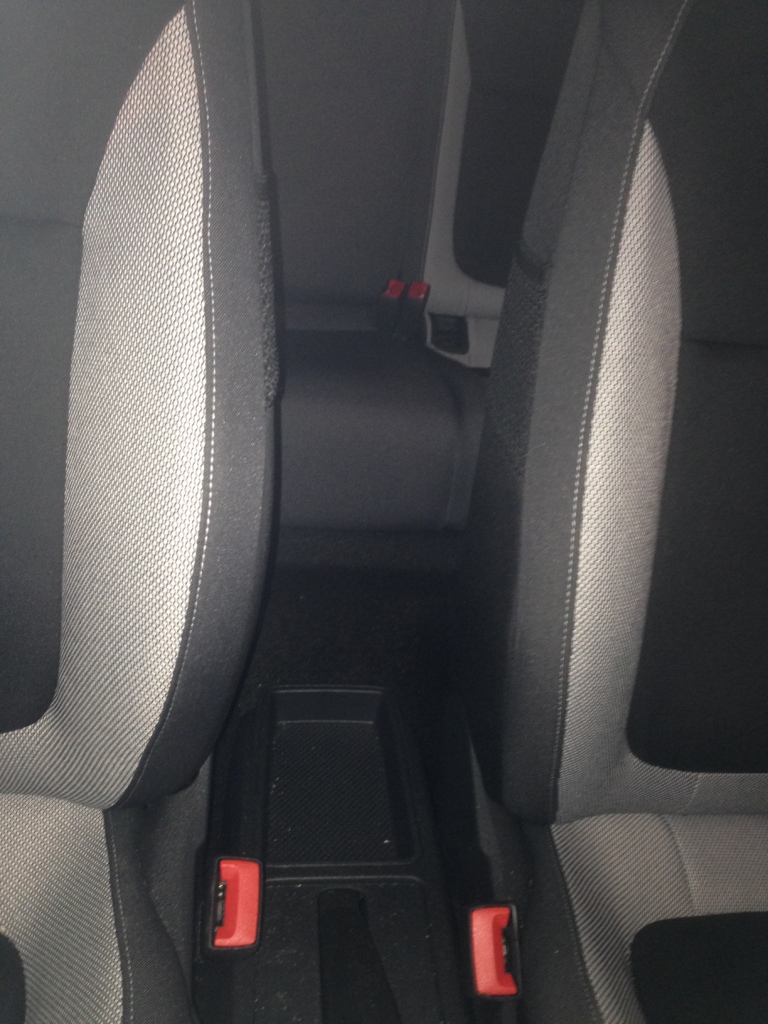

This is mine from the front, sorry its not a good pic taken with my Iphone
Have the SEL have parked the armrest in the upright position I think I will use it on longer runs bit of a nuisance around town. This rather defeats using it for storage. Joe
That's great. It looks like the storage tray is a separate part that clips in.
