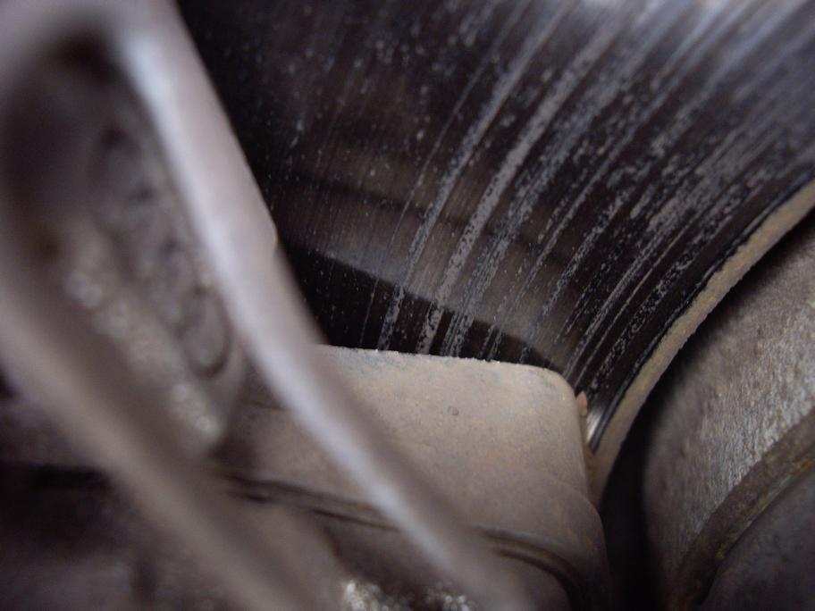

I've recently purchased a used 1.6tdi Rapid Spaceback with about 14k on the clock.
After about a weeks use (and abut 600 miles!) I noticed a lot of brake dust on the front wheels - looking more closely I see the pads a wearing wedge-shaped, with the lining on the outer part of the circumference much thinner than the inner part.  This is true of both front brakes.
Not something I've seen since the old days of the Triumph with their square disc pads.
This doesn't look right to me - before I go trotting back to the dealer though, is this normal for these cars?
Piccie attached I hope (my photobucket has decided to not let me copy links any more :devil:
Mine look similar (Toledo) and they do show a good deal of dust from the pads, seems normal.
Yes the pads are correct no need to worry.

Well, having properly examined the brakes today (i.e. took the wheel off and had a look) I can confirm that I need the following parts:-
Scraper,  egg from face,removal of, quantity 1, part no. DLT2015
How could I possibly mistake the chamfer for this kind of problem I don't know, except maybe age is creeping up on me! Especially as there were no funny noises.

It really does make a lot more brake dust than my MX5 though, I guess I'll have to get used to that (or rather, my other half will!)
