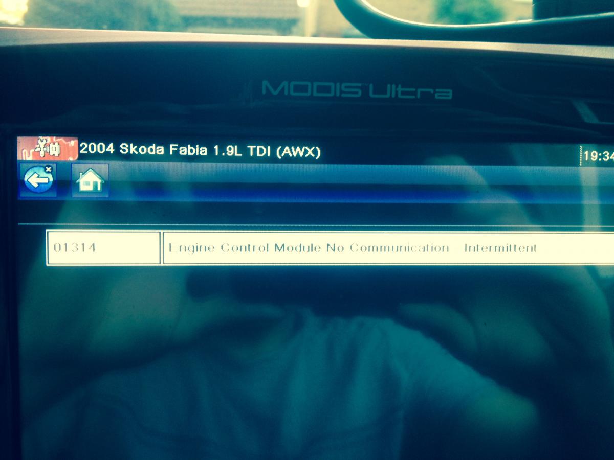

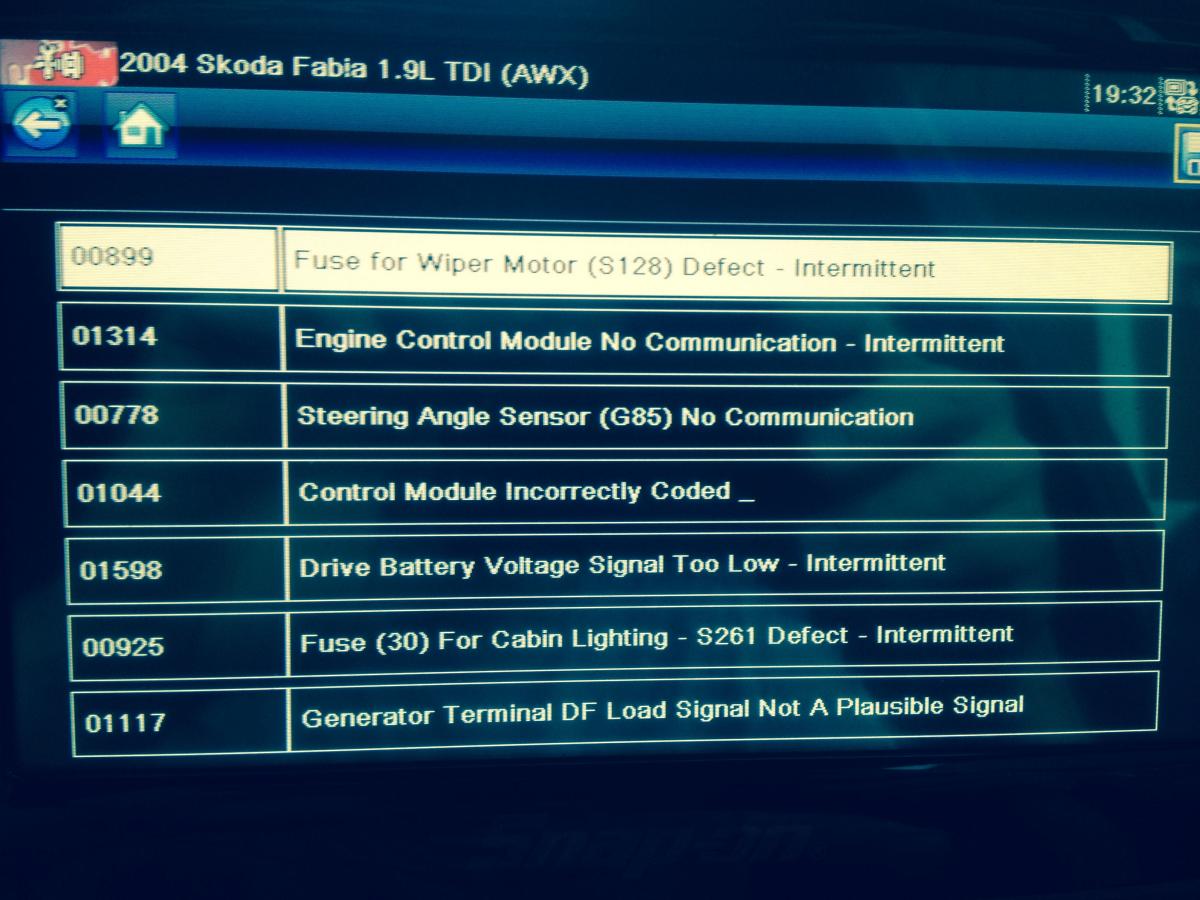

Codes from scanner tonight, I know some are from flat battery
You have a serious electrical issue, disconnect the battery to reset the ECU and then try to read the fault codes again.
...make that a number of serious electrical issues.
Start by taking the battery off and fully charging it, repair the load sensor wire so that the alternator actually charges the battery then clear all codes and try starting it.
Going to charge in morning and update
Hmmm.... Also check the fuses on the battery top aren't cracked/cracking or loose.

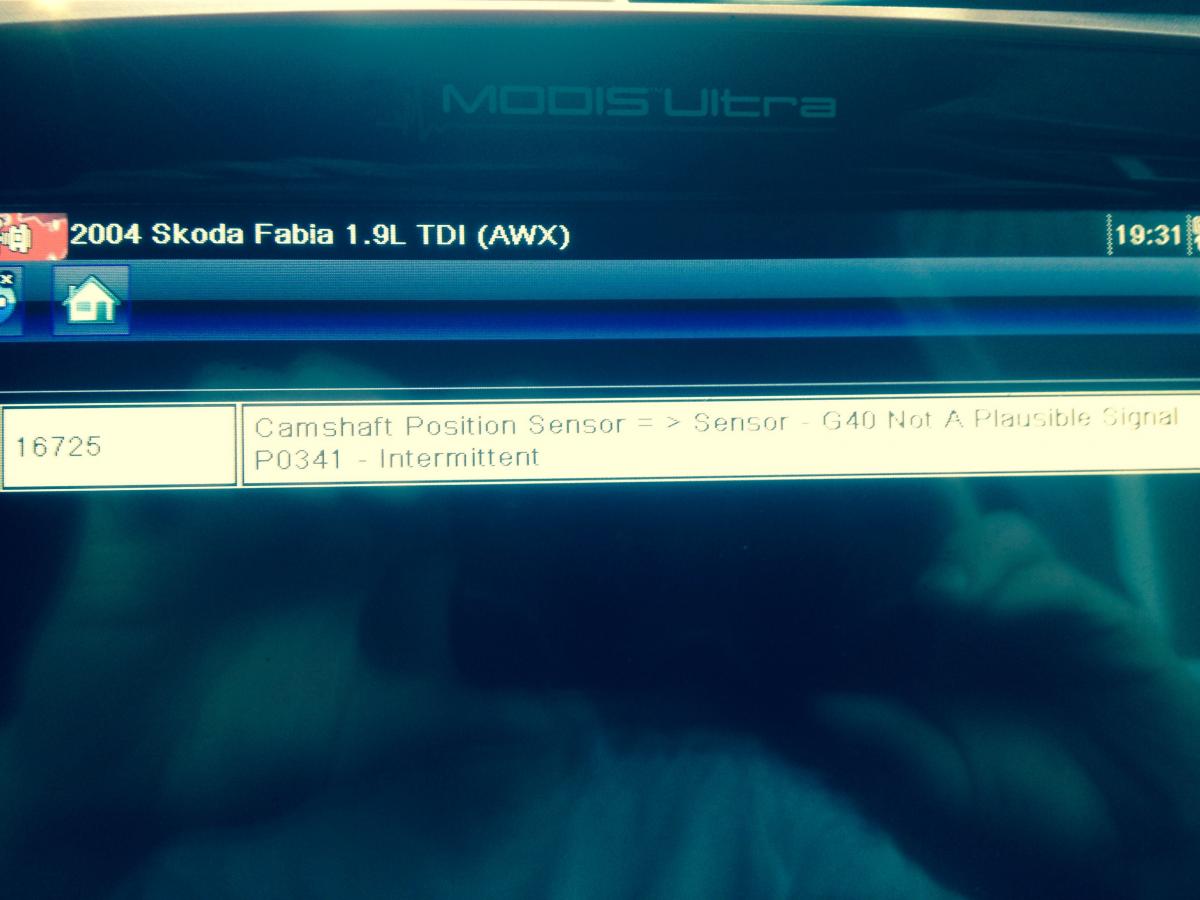

All fuses are good, I have checked wire from cam sensor to ecu and all ok. Only code cam sensor but changed and still the same.
Battery now charged
Now checked timing and put new cam sensor in and still nothing. Also put new fuel filter on
