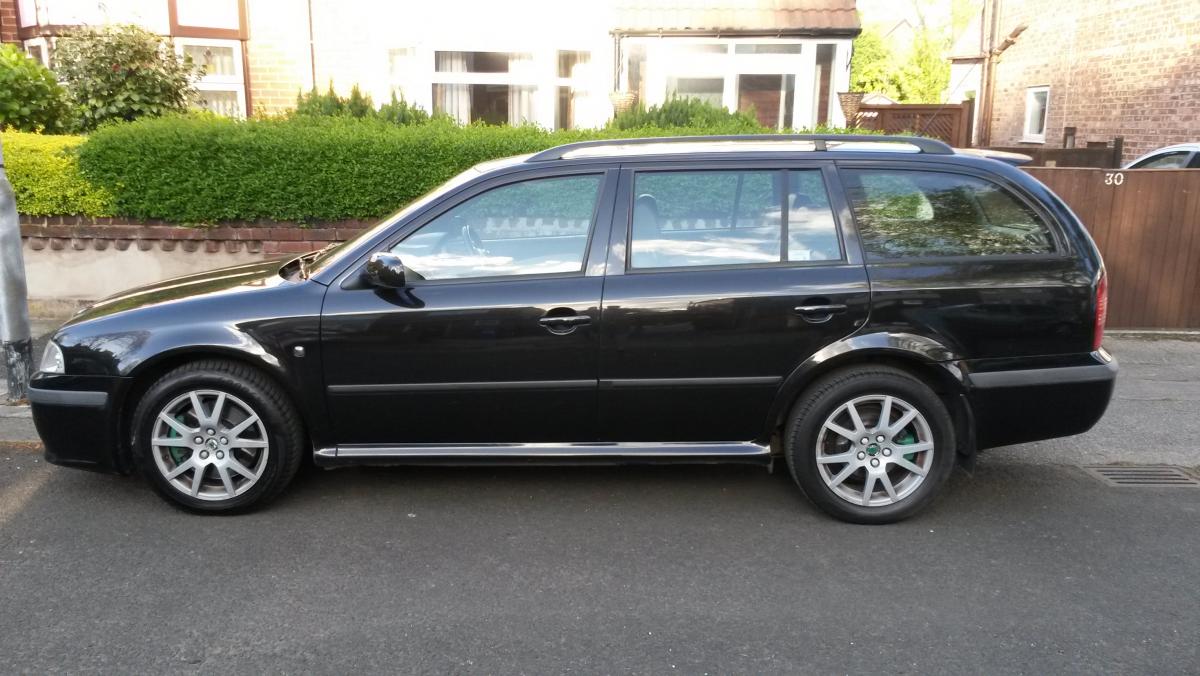

I've just joined after buying a Mk1 vRS estate from a friend of my Dad's.
I previously had a well-sorted Fiesta ST but a new baby forced sale.
The car is in nice nick, and I knew it needed a bit of work on things like tyres, but I don't think any of us expected the oil pump to fail after 20 minutes of driving!
I got the AA to tow me back from Derby to Manchester - I live in Chorlton if anyone is nearby.
Anyhow, I've had the pump and oil changed, new cam belt and water pump and sorted the tyres and it's a great car.
One thing I've really noticed is that the chassis is really not up to the power!
In short my shocks are totally shot, I'm pretty sure they are the original (12 years, 118k miles) and I've spent the past few days trying to track down a set of fronts that will actually fit the vRS.
Found plenty of threads on here with people having the same problem, but can't find anyone listing correct part numbers...
So if anyone can shed any light on it, I'd be very grateful!
I live in Chorlton in south Manchester, so if anyone is nearby, give me a shout.
Cheers,
Nick
