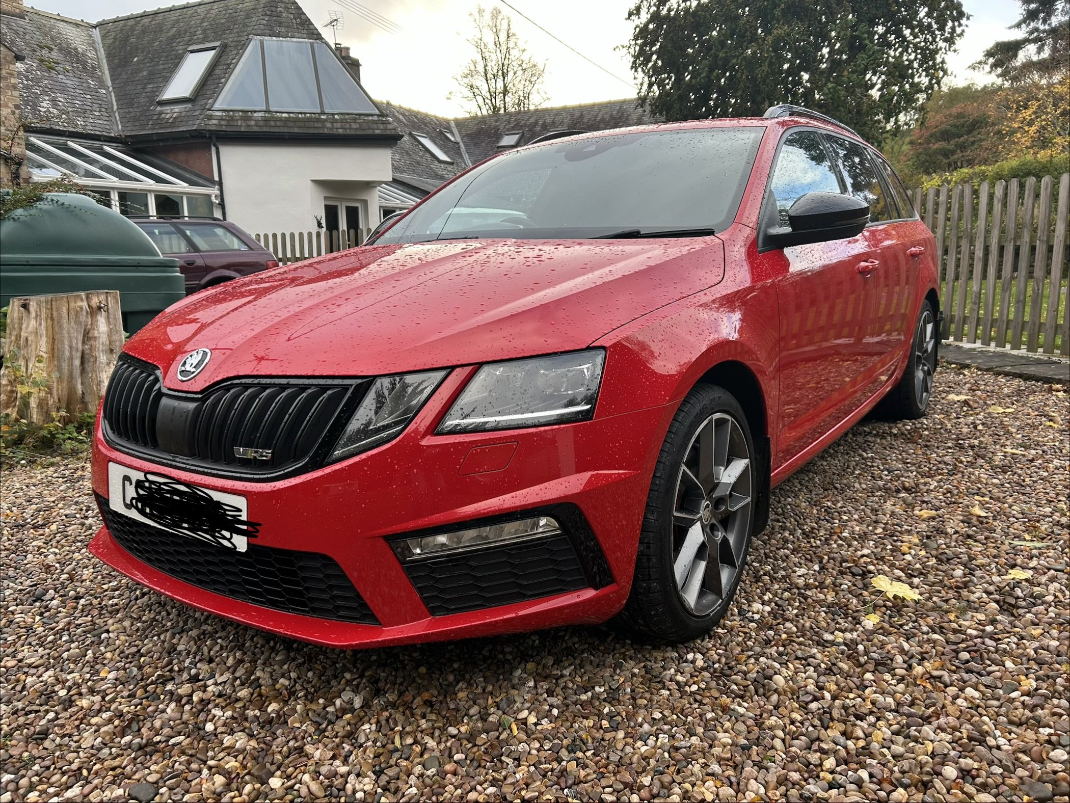

So, after going to view a 2017 VRS estate we came away with it and so “old faithful” has now passed into new hands.
With almost 270,000 miles under her belt and still going as well as when we bought it….Sold.
The new car has big boots to fill, I doubt it’ll be as good as the old one??…. time will tell.
