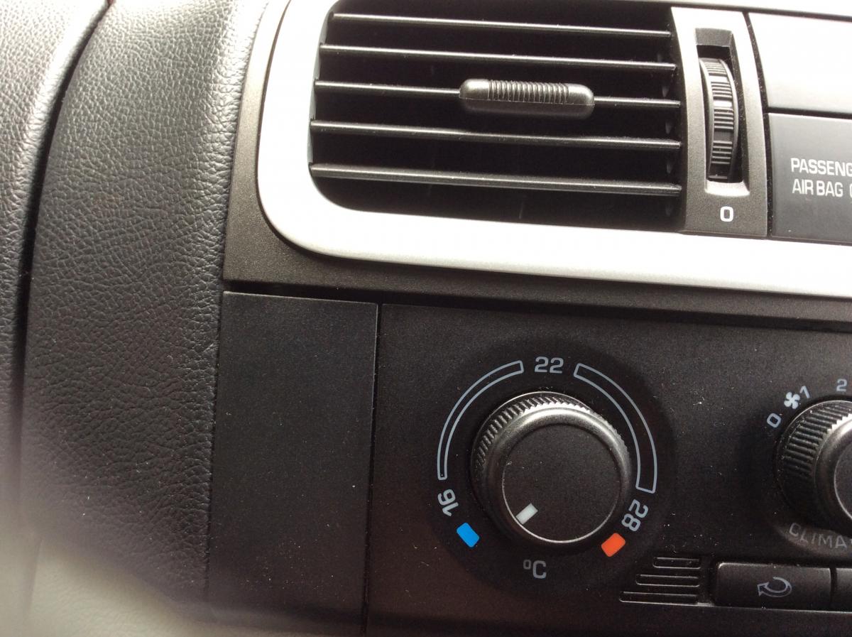

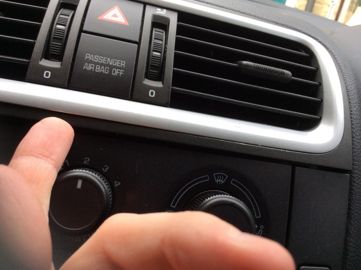

I got a phone holder to clip in to the air vent in the centre console,I thought I try it in the drivers door vent so i pulled it but the clips were stuck so I pulled a little harder and the bottom air vent console unclipped . Now I can't push it back in at the bottom.
How do I get it back in ?
Thanks

I assume you're pushing it and the whole vent assembly is moving back when your pushing so it won't click? If so it is like mine (I tried to rout the GPS receiver to the dashboard mounting bar above the vents and got the vents half out but couldn't get them back in either). I will wait here for an answer. Otherwise it's booked in for a service on the 3rd so I'll ask VASStech to do it. That gap is annoying.
Just a thought, I don't know the layout that well but have you tried or is it even possible to remove the whole unit and then try and replace it starting with the bottom first?
Sent from my SM-N9005 using Tapatalk
Edited by jonro2009
I think i remember reading (maybe 32kofdata's car?) that his snapped a pin or something when trying to get it in place. Still held well with the rest of them though
You need a special tool to clip it back in. I found the info on a workshop manual as I pulled mine out and never got it back in. The car is currently for sale in ebay after ive sold it. The centre air vents are still unclipped. Skoda quoted me 50 for a new unit fitted as its thought I snapped something when taking it out.
It still holds in but yes the gap is annoying , I'll probably leave it.
Thanks
What was more annoying was the fact you can't get it off either. If you can't get it off or put it back then why do they make it so you can get it half way?
Just asked vasstech to have a look at it and I have snapped something too and also need a new vent
