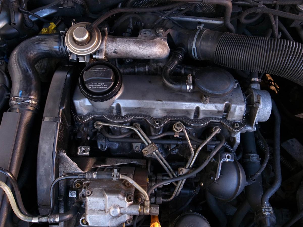

Outcome of the repair initially all looked fine, except that I almost lost the tray cover from underneath the engine whilst driving on M11 - they left it hanging on 3 screws. About a week later though I spotted that I am leaving oil spots everywhere I parked.
Oil level, looked still ok but I couldn't get the dipstick back into the tube - as I found out following removing engine cover, tube was snapped loose at the bottom.
Shortly whilst trying to find the source of oil leak I noticed also that one of EGR valve bolt bracket has been snapped too.
I went back to the garage complaining about all the botched bits and I was told that whilst they can't vouch for not snapping the dipstick tube they assured me that upon removing the head they've never removed EGR valve, which seems strange to me as it is located fairly close to the engine head.
As for the leak itself I was told that it could come from the faulty turbo as I was complaining about turbo earlier but they would have to examine closer.
Got me booked in again for next week anyway.
In the meantime I have located the oil leak, it appears to be coming out of camshaft sprocket area - could be an oil seal on camshaft.

Upon removing the head  - does EGR valve need to be removed or is it possible that EGR valve was never touched ?

Id say you could probably remove the head without removing the egr by just takeing the inlet manifold off with egr intact . So that's a possible, do you know the bolt and bracket was there and not snaped before? I'm not sideing with the garage but if you don't know for sure you gota give em benefit of the doubt ,the undertray could be an easy mistake or just the last half arsed job ,contact your local tradeing standards for best advice .
Jim
Thanks for advice Jim.
Bracket was there 100 % day before the morning I took it to the garage, I remember I was looking closely at Egr then and removed the pipe to see if there is any oil inside.
Unless it snapped whilst driving within the week after the repair I can't see otherwise, on the other hand I can't prove anything.

I've had a bit of argument with the garage in subject but at the end they fixed the leak post warranty and replaced EGR with new one free of charge.
It seems like they prey on people who don't know much or at all about cars but if you talk their language and show a bit of knowledge they back down.
