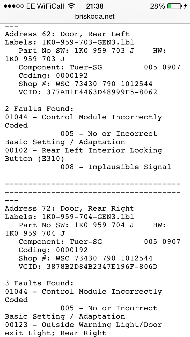

I'd start with an autoscan for any obvious codes then check the controllers for the rear doors. Just had a look through a few octavia scans and they all have the same coding for the both rear doors regardless of part number, HW or SW versions. This is both pre-FL and FL so if your coding if different it may be a good clue.
Coding: 0000144
Address 62: Door, Rear Left        Labels: 1K0-959-703-GEN2.lbl
   Part No: 1K0 959 703 E
   Component: Tuer-SG         021 2435
Address 62: Door, Rear Left        Labels: 1K0-959-703-GEN3.lbl
   Part No SW: 1K0 959 703 J    HW: 1K0 959 703 J
   Component: Tuer-SG         005 0907
   Component: Tuer-SG         006 1301
   Part No SW: 5K0 959 703 A    HW: 5K0 959 703 A
   Component: Tuer-SG         007 2101

That's the scan and has bought up faults too any help please?

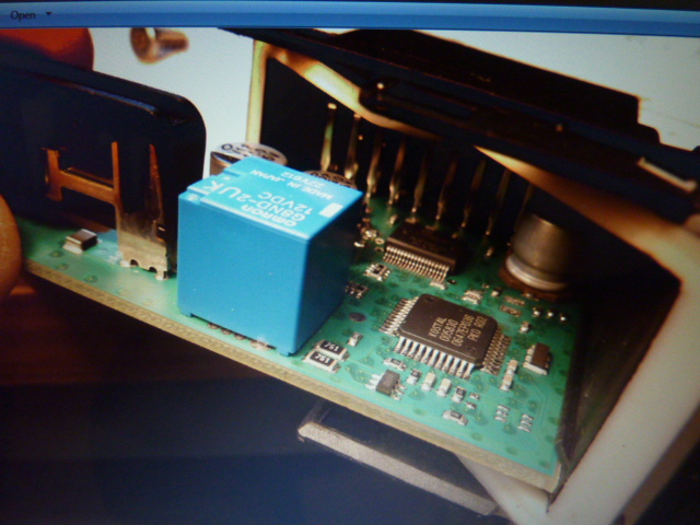

The electronics are very complex. There are two 40 pin IC’s plus a further three smaller IC’s in each door controller to run the CAN network and the various other window features. Each window controller is addressable with its own unique ID. The motor is operated by a power MOSFET via a reversing relay. Motor current sensing is used to monitor the fully up or down positions or when the window is ice bound. A stall situation caused by an obstruction when closing is also sensed the same way. The current rises as the motor stalls and the supply is cut.

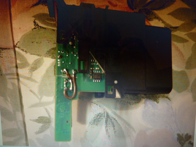

I decided to try and sort the problem out. I easily removed the door card and then the motor unit disconnecting the main plug. My plan was to reverse the connections to the motor if possible. I unclipped the control unit from the motor and drive unit. Fortunately it is fitted with a brushed DC motor so the supply can be reversed to change the direction of rotation.
The only possibility was to cut through the PCB copper tracks and reverse them by soldering short cross over wires as per the photos. I put it all back together and now at least the window works in the right direction and key opening and closing is now possible. The one touch facility continues not to work. I have tried the window reset procedure to no avail.
Unfortunately the Best Answer definitely does not apply to my Mk2 Octavia VRS Estate. To quote: “On the regulator there is a metal bit with four screws that if you turn 180 degrees it reverses the motor”.  The only metal bit is the motor and to make a connection it has to be in the position shown. I have many years of experience in electro mechanical engineering. Hope this is write up is helpful and sorry about the quality of the Pics.

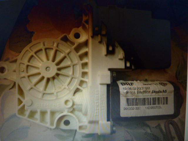

WARNING TO ALL - WHEN BUYING REPLACEMENT REAR WINDOW MOTORS + MODULES FOR THE OCTAVIA II - YOU HAVE TO GET ONES MADE SPECIFIC FOR THE OCTAVIA II - THERE ARE IDENTICAL VW UNITS  WITH IDENTICAL PART NUMBERS, BUT THE VW ONES WILL WORK IN REVERSE!
Now that I've gotten that out of my chest, summing up a long story - I had to replace the rear window winders + modules in my 2006 Octavia II L&K. I got replacement ones (second-hand) with identical part numbers and they would work in reverse!
No fault codes. After a lot of investigation, I discovered that the rear window winder units are made special for the Octy II
ha1-KFJw-M48-FHZLz6-Fq-HQLxt-Zj0n-b-Mxt2
Look at the photo of the above unit I took from a 2009 Octy 2 - the part number has the word SK3 mentioned it and it also mentions Skoda A5
The VW ones wont have this - apart from these the VW ones are identical. Putting a VW control module on a Skoda winder won't work - I tried this and the result is that it works the opposite.
Front Winders and control units seem to be same across VW and Skoda
Don't make the same mistake I did - be extra careful when ordering rear window winders for your Octy II
