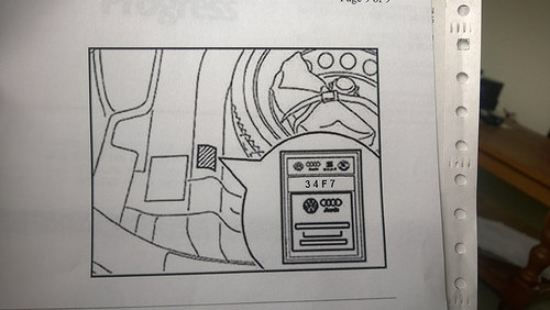

Also a Sticker in the book to show the Field Action as having been carried out.
 & the Information in the Service Book & on the Cars Service History on the Skoda System?

Best ask the Dealership that did the Service Campaign if the Software Update was done, and not assume it was.
Because some technicians doing the Service Campaign did not do it.
(ask why no sticker in the boot as well, which shows laxness on the part of the person doing the service campaign.
The sticker was one of the parts to order for doing the Service Campaign.)
