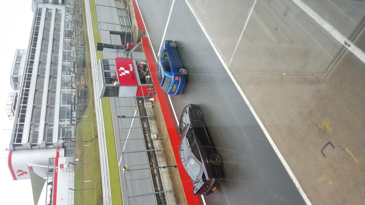

Car had a nice gentle run yesterday, 105 laps round brands hatch :) with the brisky squad, great bunch of guys and a great day out even though we had 7/8 red flags and one very poorly looking focus RS!! No one was hurt luckily.
Was raining in the morning up until 11 or so, so was quite slippery but the car just under steered so no real moments, only a fiesta going off in front of me on paddock hill bend making me stand on the brakes lol.
The cheap tyre held up remarkably well, when we had a dry line I could generate quite a bit of grip from it. And after a session the rubber was ridiculously soft haha. Cooked my rear pads again, had them stinking a few times so I'll throw a replacement set on soon.
A couple random photos
Happy I survived the first session lol
