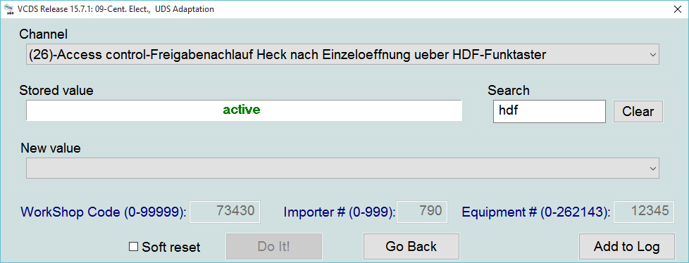

I think I might have found how to activate the taigate locking delay via VCDS - according to post 8 on this thread
http://www.skodacommunity.de/threads/verzoegerte-verriegelung-der-heckklappe.89743/
you need to change (26)-Access control-Freigabenachlauf Heck nach Einzeloeffnung ueber HDF-Funktaster to active.
The poster claims to have tested it - I'll try it myself when I can.
Sorry, post #6 in that thread, not #8.
My German isn't brilliant, but that translates roughly as
Release trailing tail after single opening above HDF radio button
no wonder we didn't spot that!
If you split up the compound words and go for wider meanings you get something like 'Tail release after-run following solo opening by remote'. I'd be very surprised if that isn't the one!
I'll try it this afternoon - my boot still seems to lock but it is difficult to tell as I have KESSY
Also, this seems to work on hatchbacks and maybe not on estates, and I have an estate
Perhaps a non-KESSY hatch owner needs to try :)
Edit: this does work, I just needed to reset the controller for it to work :)
