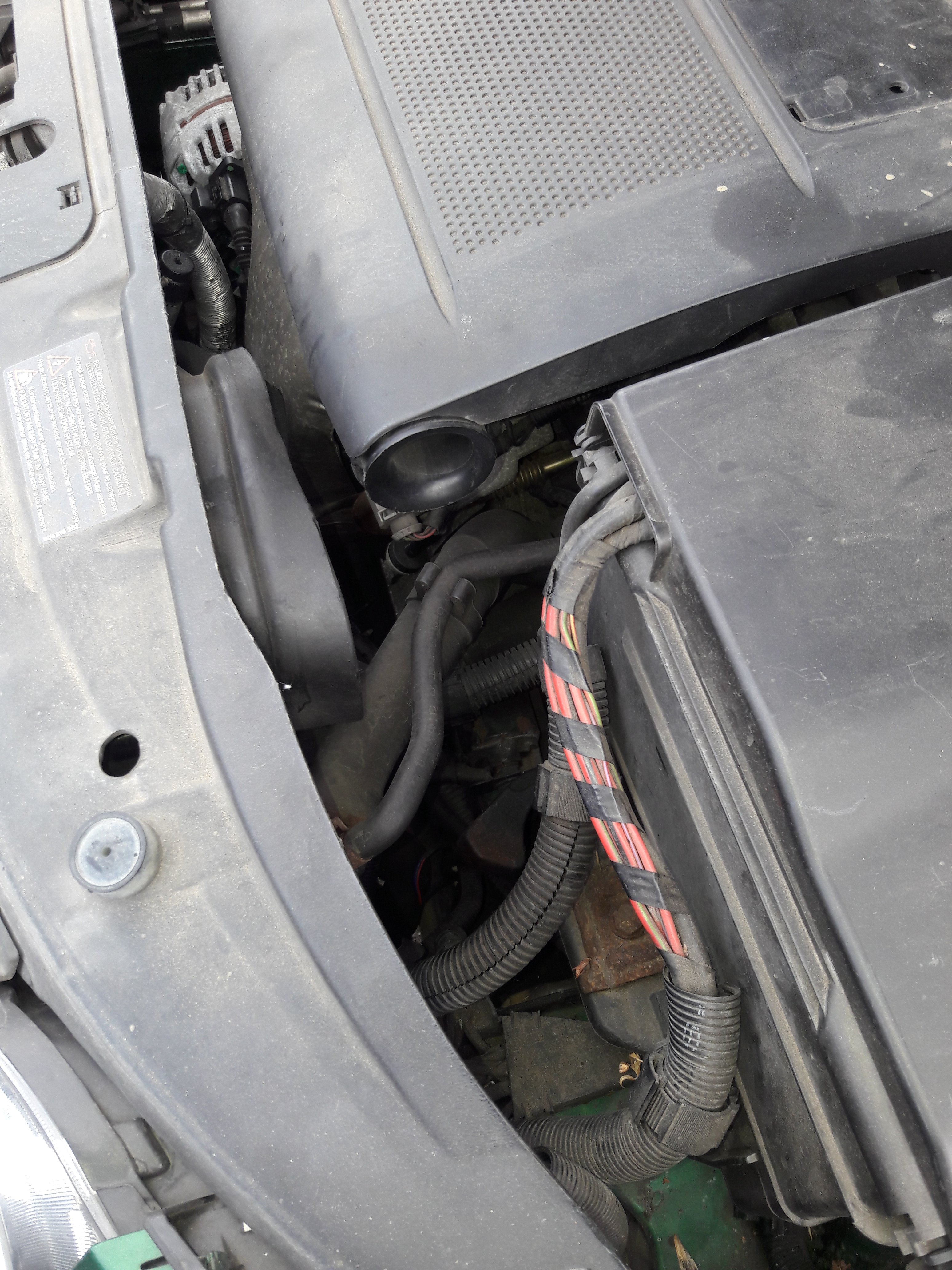

Tried out my new 'Torque' app/OBD dongle thingy today and we went for a short (14 mile) drive to get some real time engine parameters - Engine Intake Temp started off at +9 deg c (agreeing with ambient) but was up to + 35 deg c at the halfway point - by the time we got back into town it was reading +42 deg c - so even with the Intake Flap closed - the engine is still getting hot air LOL.

I think that's just what temperature the air in the engine bay is?
Is there actually a duct from the grille that connects into the engine cover, or just this arrangement where it is 'near' the intake?
I have my laptop with me today, so could log some temps on the way home for comparison.
Edited by Wino
It would be a helluva lot hotter than that if the flap was stuck sucking air from around the exhaust manifold.
I agree @Wino it does depend where the intake temp sensor is.
My engine bay is exactly like your pic .
I was going to have a look at where the temp sensor is mounted this afternoon.
It would indeed sir :biggrin:
It's in the same package as the MAP sensor, so (RHD) driver's side of inlet manifold.
  • Sponsor
It occurs to me that it would be fairly easy to DIY a duct that does connect the cold air inlet of the airbox/engine cover to the inside of that bit coming off the grille.
Funny you should say that :biggrin: I was also thinking maybe of an external blank for the Hot Air Inlet underneath the Engine Cover assy.
If the flap is forced to be closed somehow or other, then I don't think that would matter. Not too sure exactly what mine does at the moment, as I replaced the thermostat with one off a Volvo, and never really checked in detail what happened to intake temperatures, so I don't know how closed/open it stays.  Having completely shut the one on the missus's car and seen no problems over this winter, I'll probably do the same with mine.

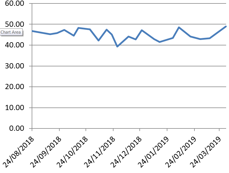

The missus's car has never been better on fuel since forcing the flap to full cold.  Long term average over 7 years is about 41.5
This is a plot of how it's been since, I reckon not far off 10% better (8% actually, almost exactly 45mpg over that period):

Logging IAT for the second half of my ten minute commute home in the Polo showed an average of about 45°C.  Definitely room for improvement.  Will screw the flap full 'cold' first, then think about linking the airbox cover to the grille thingy. Thanks for prompting me to look into this again @YS53. :)
