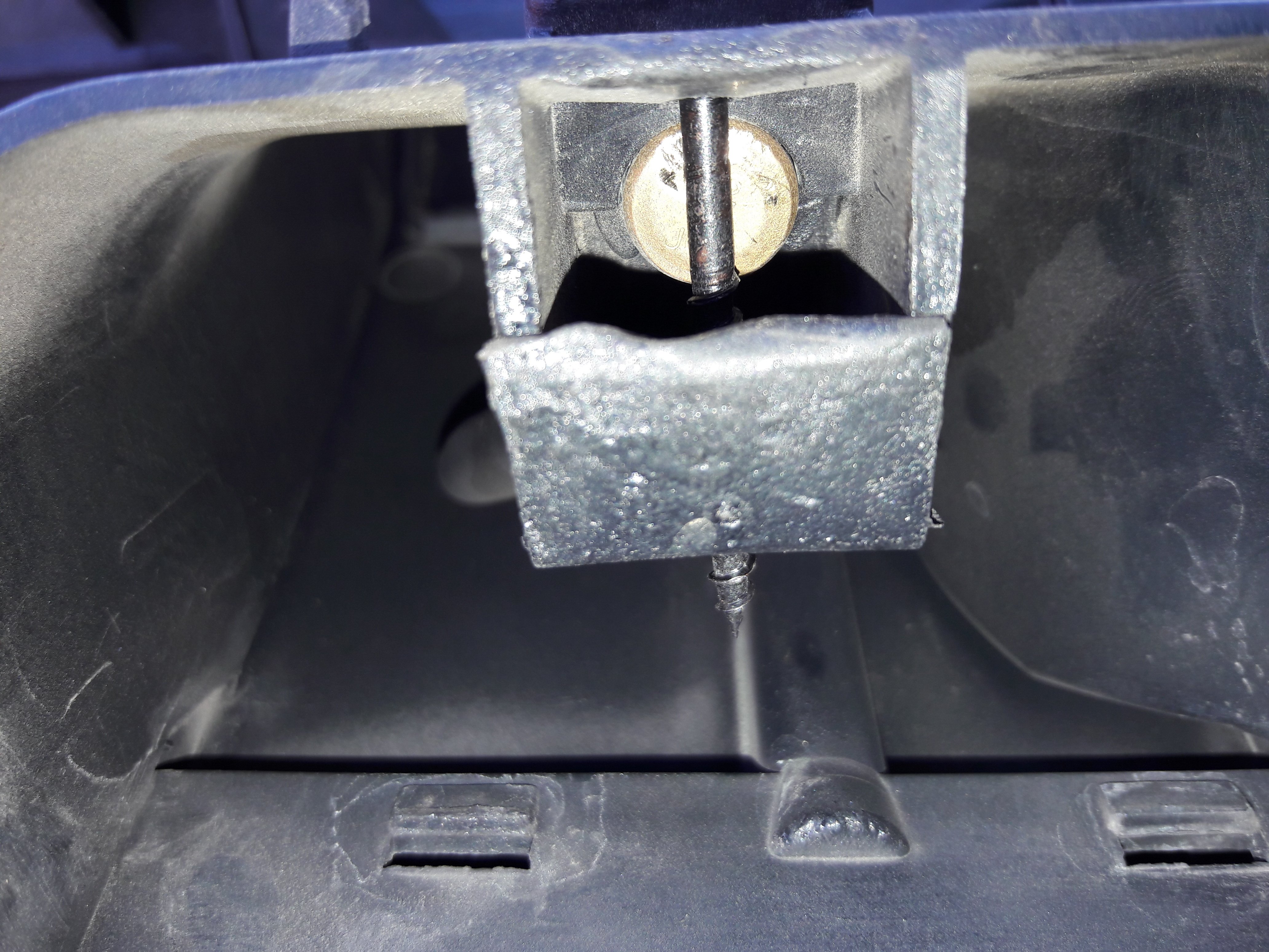

Over the summer I discovered that the one on the missus's car had failed too. On her AZQ airbox, the blend flap stuff isn't accessible to replace anything (no screws), so I just fixed the thermostat in a position where it gave full cold. Probably the far easier fix. One drilled hole, one woodscrew.

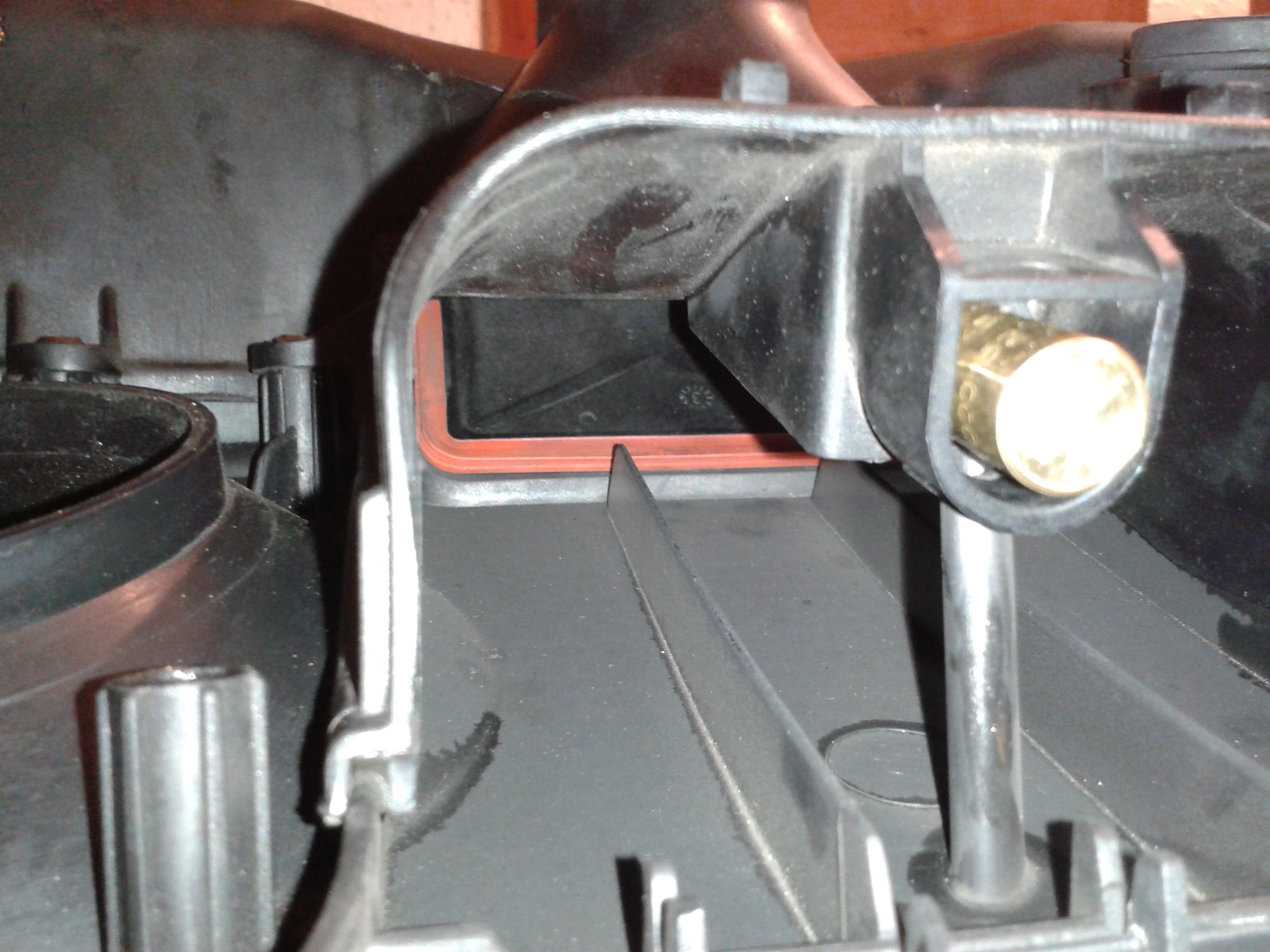

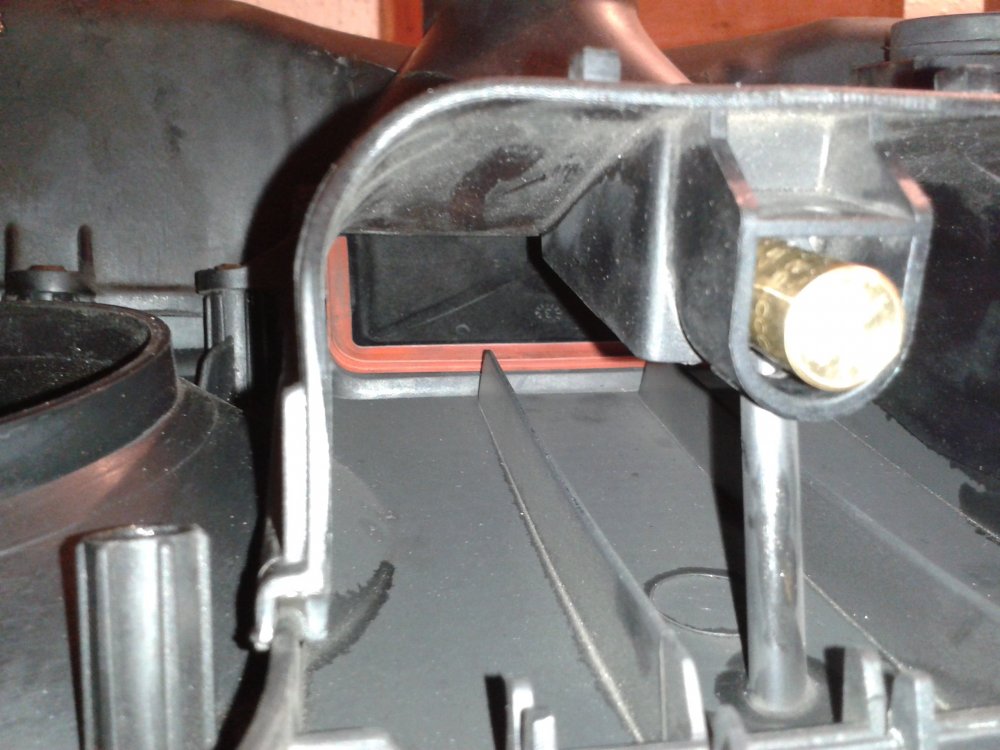

If you take the part off that houses the air filter, you can see the back end of the thermostat. Give that a push and you'll see the blend flap (with orangey rubber seal) move. Then warm up the back end of the thermostat with a hair dryer for a couple of minutes, being careful not to melt surrounding plastic.  If the blend flap moves the same as when pushed, the thermostat is still working.  If nothing happens at all, it isn't.
Here's a view towards the blend flap, with thermostat in foreground on the right of shot:

There's a photo of the thermostat and mechanism in a post of mine two thirds of the way down page 1 of this thread:
Then at the start of the next page I have written the Volvo part number.  In hindsight, I wouldn't bother with this replacement now, I'd just wedge the thermo inward, to simulate a pin that actually extrudes as it should. Like I did on the AZQ version with a woodscrew!:

OK - the intake Flap thermo thingy is sorted LOL - I bunged a woodscrew into it as you suggested - so it is now locked into cold air.
Many Thanks - baz
