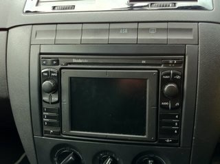

Picture attached showing current setup.
The picture you've put on is the MFD1 head unit, just if you didn't know.

Yeah yeah just put up the picture to show the space the mfd1 takes up. When you say more hassle then it's worth, would you kindly elaborate on what you mean by this? Many thanks
The mk1 Fabia doesn't have the integrated CANBUS system like the Octavia mk2, so you'd have to faff getting it to physically work in the cars electrical system as it won't be just plug and play.
Then there is the "minor" issue of the unit actually being wider than the hole in the dash, so you'd have to start hacking apart the dashboard.
