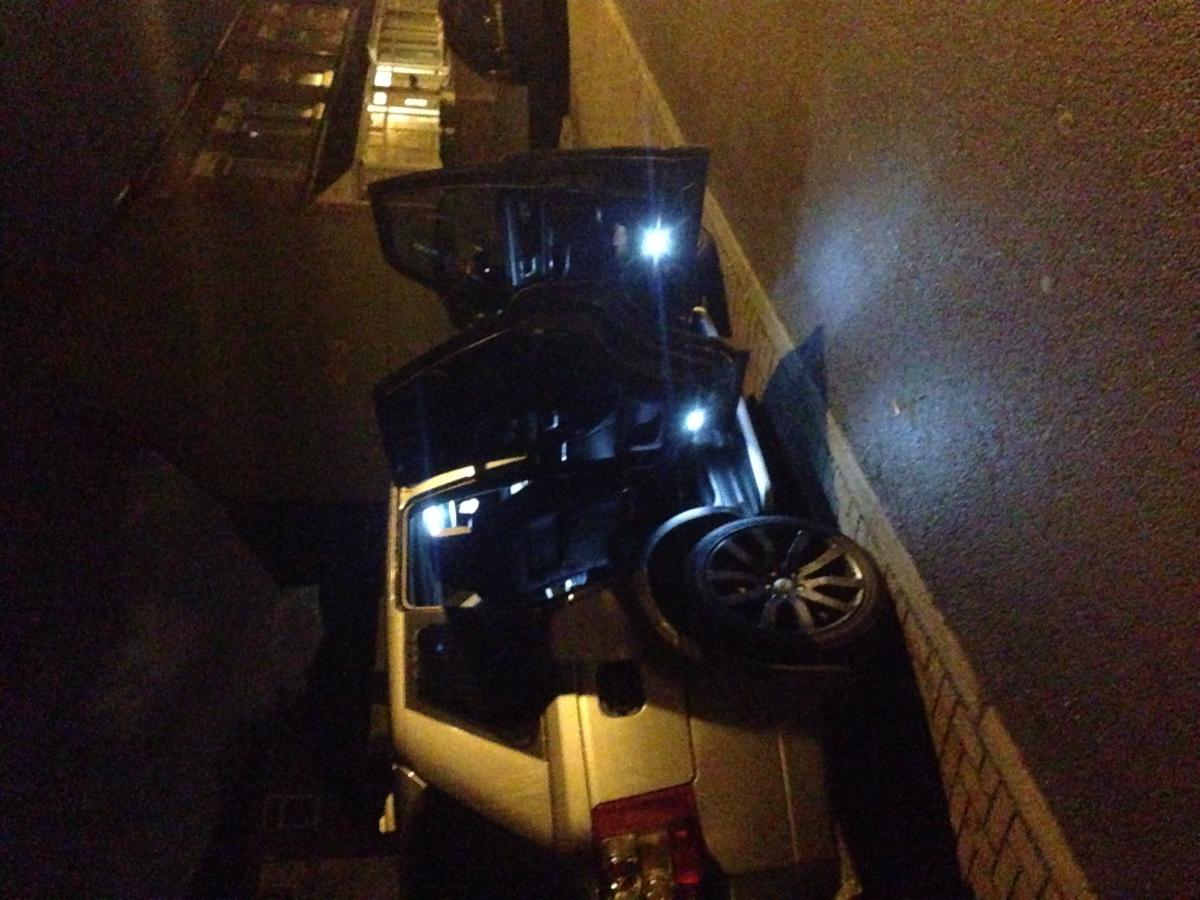

Can you please PM me a picture of what you door light looks like. If they are puddle loghts that are pointing to the floor and after
some canbus error free lights, I can certainly supply you them. I just need to determine the bulb type.
Do they have a clear cluster or a red cluster on the lights.
This is a picture of a range rover sport I had done.
I will let you know the price and bulb type once I have a picture from yourself.
Although I am 99% sure of the bulb type. Just want to make sure.
