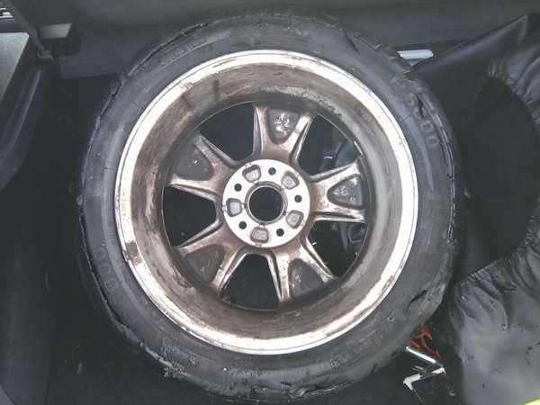

Ahhh that tyre, nothing the gunk won't fix.
