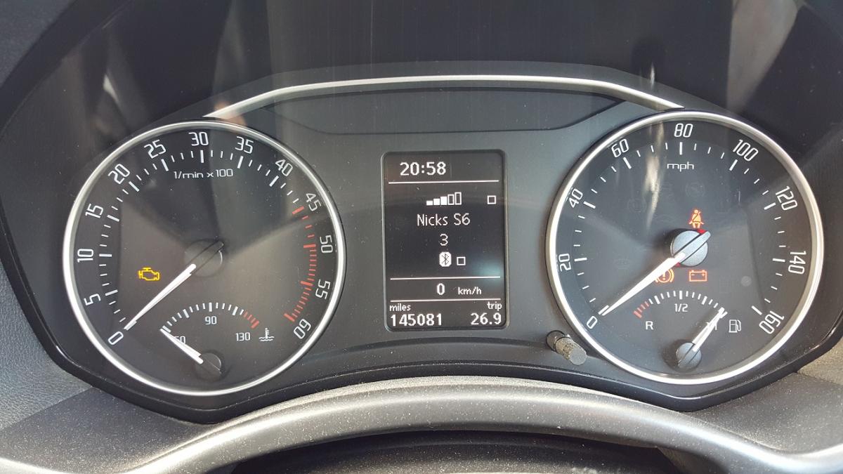

Hi, Ive just installed a 3C8035730E Bluetooth/wifi module to my car but some of the icons are showing up on the maxidot display as boxes. Has anyone come across this before? I also attach a photo of my other car, with the same type module,that shows the icons as they should be.

Looking at that I'd say the software on the cluster is too old at 0110.
There are files for 0422 and 0608 available but these will destroy your clusters as the hardware changed. I've seen mention of a 03xx firmware, but I've never seen the files nor do I know if your cluster is compatible or if it will fix the problem.
I'll see if I can find anything more out but I suspect you may be stuck with missing icons unless you change the clusters for a newer model.
edit:
Forgot to mention, there is a 0112 firmware for your cluster but I have no idea if that'll help. I've never seen a changelog for any of the flash files :/

my other car has this cluster and this works ok
Address 17: Instruments (J285)       Labels: 5K0-920-xxx-17.clb
   Part No SW: 1Z0 920 943 S    HW: 1Z0 920 943 S
   Component: KOMBI         H04 0607
   Serial number: 00000000000000
   Coding: 410E01
   Shop #: WSC 00152 210 91233
   ASAM Dataset: EV_Kombi_UDS_VDD_RM09 A04114
   ROD: EV_Kombi_UDS_VDD_RM09_SK35.rod
   VCID: C9DA179B68985369791-809C
No fault code found.
06xx SW is latest one  but also is a different HW
Cluster with 01xx SW can be update to  03xx or 04xx SW max , due to HW limited .
