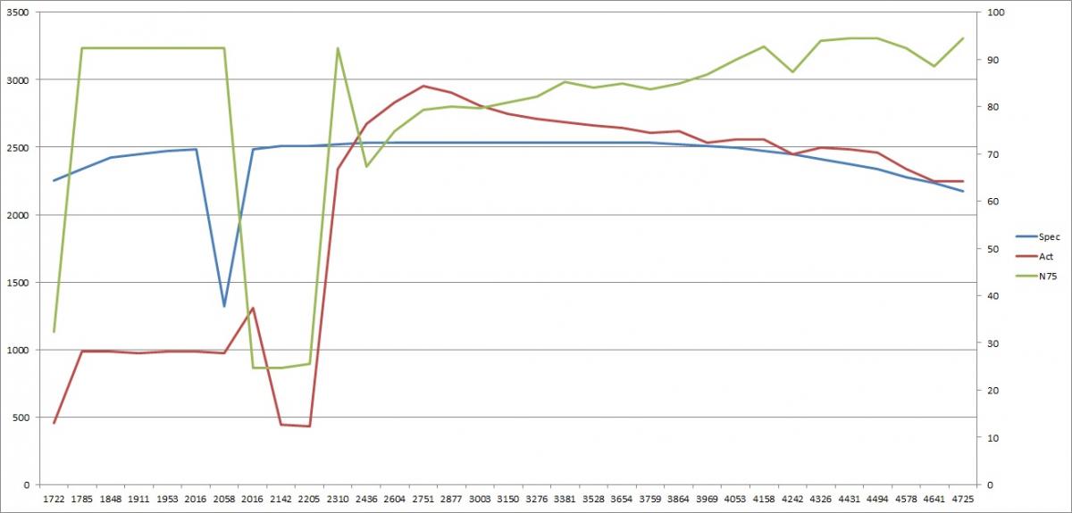

I dont have excel, so hope this reads ok?
Engine speed Spec. intake press. Actual intake press. D.cycle MAP
TIME 2850-3150 2200-2400 2100-2600 35-80%
STAMP /min %
295.73 2016 2484 984 92.4
296.08 2058 1320 972 92.4
296.42 2016 2484 1308 24.7
296.76 2142 2508 444 24.7
297.11 2205 2508 432 25.5
297.46 2310 2520 2340 92.4
297.79 2436 2532 2676 67.3
298.14 2604 2532 2832 74.9
298.48 2751 2532 2952 79.3
298.81 2877 2532 2904 80.1
299.17 3003 2532 2808 79.7
299.51 3150 2532 2748 80.9
299.86 3276 2532 2712 82.1
300.2 3381 2532 2688 85.3
300.54 3528 2532 2664 84.1
300.89 3654 2532 2640 84.9
301.23 3759 2532 2604 83.7
301.57 3864 2520 2616 84.9
301.92 3969 2508 2532 86.9
302.26 4053 2496 2556 90
302.59 4158 2472 2556 92.8
302.94 4242 2448 2448 87.3
303.28 4326 2412 2496 94
303.63 4431 2376 2484 94.4
303.97 4494 2340 2460 94.4
304.31 4578 2280 2340 92.4
304.67 4641 2232 2244 88.5
305.02 4725 2172 2244 94.4

4053 2496 2556 90
If I'm reading it correctly your actuator setting has been altered, the 90 above should be a maximum of 80% at 4000rpm, ideally nearer 70.
VCDS states 70-80% at 4000rpm.
Yeah the grinding is a concern. But I also suspect the actuator is off or a fault with the vacuum.
Getting some nice over boost to 1.9 bar. Ouch
But yeah does look like it's too short. I'd lengthen 2 turns and log again.

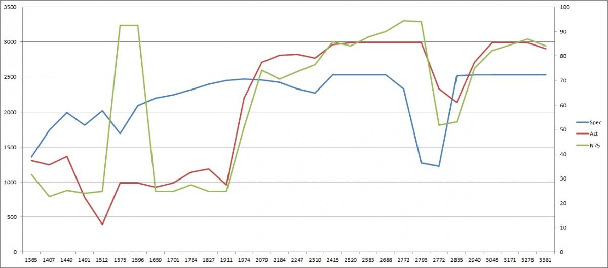

I've put part of the log into a graph.
Personally I think the MAP sensor is on its way out. If you look theirs parts were actual drops to around 500mbar bear in mind atmosphere pressure is around 990mbar.
I'd fit a new MAP and log again.
