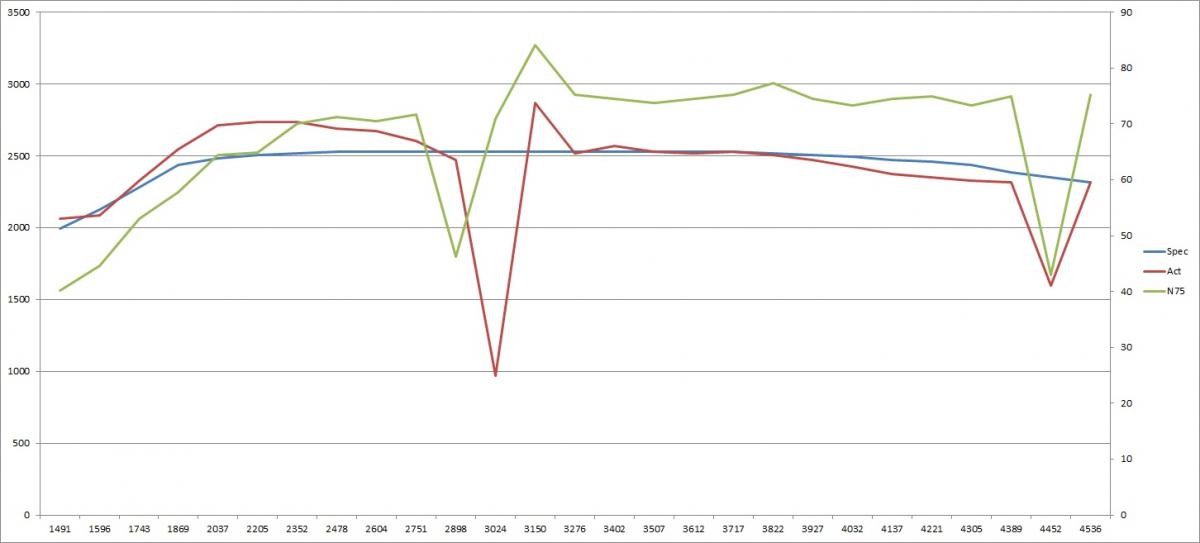

Ive adjusted the length (longer, nearer the end) and it feels much better in 1st and 2nd, but its stuttering in 3rd. How ever after i finished the log i ran a quick error check, and John was spot on :p Manifold sensor error, open circuit earth to ground, open/ closed error G71. So im not sure if that's what's making 3rd feel stuttery, and making air pressure sound when turning the engine off.

Yeah you can see ever now and then the actuator pressure drops suddenly then comes back. Best check the wiring or replace the sensor.
Excel is what I use for graphing it. Maybe use libra office.

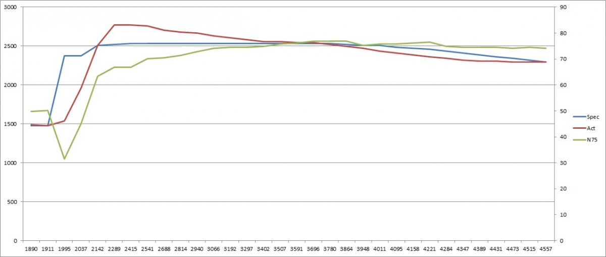

Ok new MAP sensor fitted, still doesnt feel great in third.

Just replied to your last email before you fitted the new MAP sensor, sorry been away. AS you can see actual suddenly drops which I suspect is the wiring or MAP sensor failing.
Can you send me the above log so I can check to see if theirs any drops in actual?
Just copied your new log form here into excel.
I would say best thing to do now is get a stock map on and log again so we can check the actuator is setup correctly. Then put your map back on and see how it logs.
