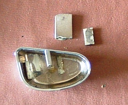

Hi Motor engineers, Had another look and it appears that one of the shiftlock buttons plastic clips has broken off, and that,s why it moves about too much.  Any idea where i can get a replacement shiftlock button.  On my Suberb 2007 it is chrome coloured plastic.  Thanks to all who read my original post and this one.  Kind Regards Graham
They mostly break like this - it is a result of a poor design which snaps the button if you use the button "incorrectly". There are some pics in kkbc's thread which explain it. Button can't be replaced as the whole handle is moulded over it, so it is an expensive fix.
Hi Thanks to all that read my post, and kkbc and Jimbof for there reply. I can lift the shroud off of the gear shift an remove the button and one of the lugs has broken. I am going to try and pick the button up from a salvage yard if not £83 up the swanney. If get a good used button and it fits OK I will repost and let you know. Again thank you all. Kind Regards Graham
Be interested to see some pics if you manage to swap just the chrome button. From what I could understand looking at it I couldn't see anyway to get the button out without it being broken. If you find a breaker with a good whole gearstick the best thing would be to remove it whole and refit to your shaft. To remove a non broken gearstick you need to pop the bottom chrome trim down and pull the button outwards, then lift the gearstick off upwards. Apparently you have to keep the button pulled out (they arrive with a plastic clip holding them out). If you release the button without it being installed on a car then the button drops into the gearstick and it is very difficult to retrieve...

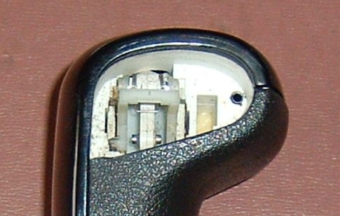

Hi,  Regarding gearshift, i done it in the end. I,am not a motor engineer but hope this helps someone.  I had to break the chrome plastic piece off to get at the guts of it, once off put something in the top to move the pin at the top down.  Once the pin has gone down hold it there then pull the gearshift up (without hitting yourself in the face with it) it will come out with not too much force. To put the new one on place over the top of the gearshift making sure it is right to the bottom of the gearshift shaft then pull the red tool out.  It cost me £85 for new one but well worth it in the end  All i can say is gently bently and you will be ok.  In future when moving in and out of gear press the back of the button only as this is why broke, the plastic piece just came away after a while.  Please see photos to help understand the design.  Kind Regards Grahampost-132261-0-21440300-1473528135_thumb.jpgpost-132261-0-73427100-1473528151_thumb.jpgpost-132261-0-41051600-1473528171_thumb.jpg
