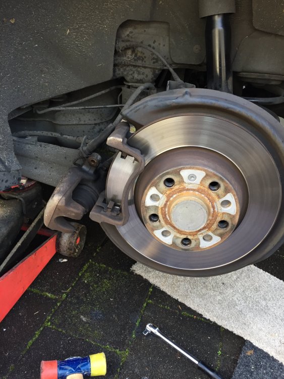

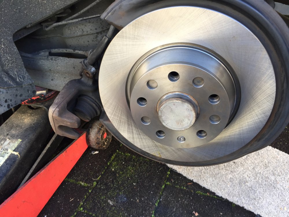

Reviving an old thread here..... I had a nightmare when trying to replace pads and discs this weekend. Got the old ones off/out but the piston rewinding tool I used wouldn't fit 'inside' the caliper to allow the tool's backing plate to push against the caliper. So, I tried just manually pushing and turning which didn't move it. I then tried a G-clamp which of course didn't work either. THEN I realised I was probably working against the hill holder. Given the rear of the car was up on axle stands I couldn't drive forward to release this, so promptly gave up, and put the old brakes back on. With the car down I took it for a drive and I either have air in the system or I've broken something, as the pedal travel is now close to the floor. I took it to a mechanic today with my tail between my legs....
If I had simply opened the brake bleeder would I have had more luck? I was going to but had fears of then not being able to bleed the system (ABS, etc).

The caliper piston will only go back if it's wound in the correct direction.
In theory, yes the piston should have gone back in if the bleed nipple was opened (provided it was being wound in the correct direction).

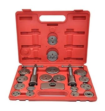

Hi all, I did my front discs and pads the other day now want to do rear pads. I have the rewind kit. Are both rear pistons right turning to go in? The pack comes with left and right rewind tools. Cheers Dom
I bought and used the Laser 5751 Adjustable Brake Caliper Rewind Tool
Very clever design and comes with different fitments.
