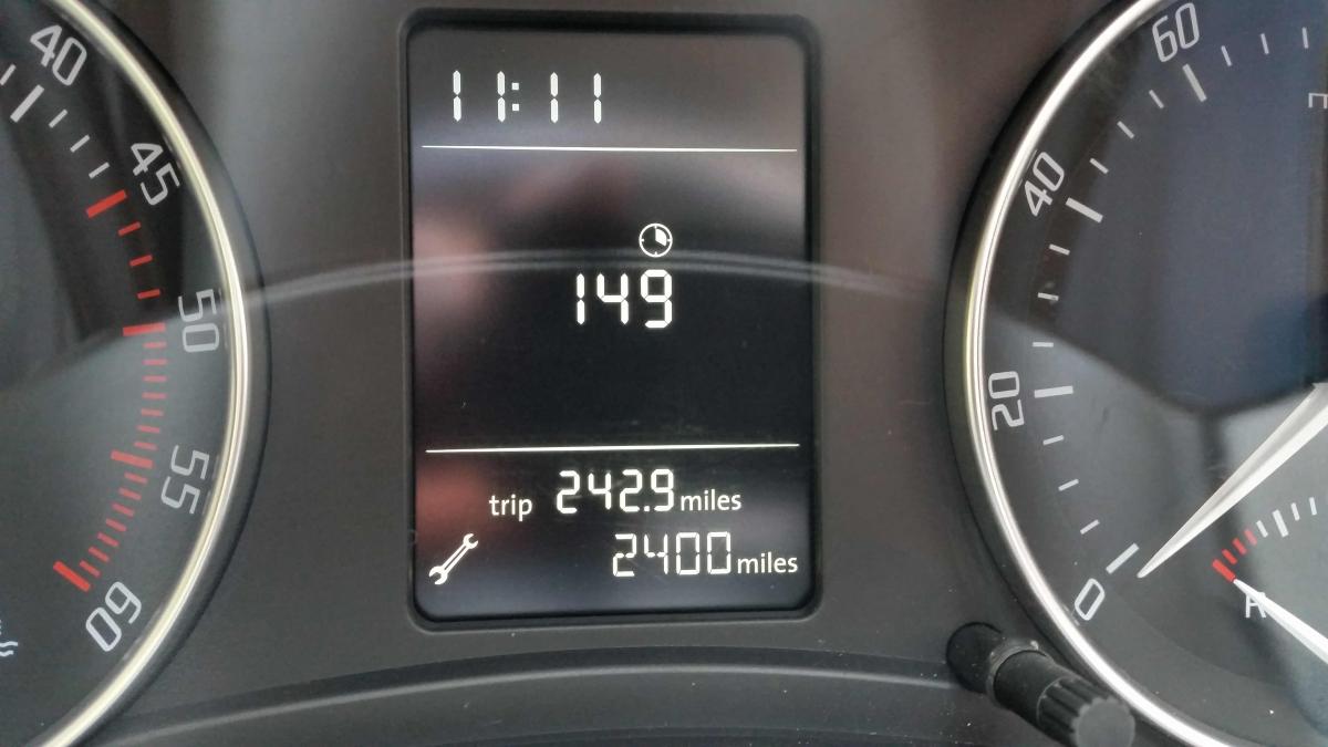

Ok The car was last serviced at 37,410 miles n the clock the clock (Currently reads) 52,500. That means the car was last serviced 15,090 miles ago. When is its next service due? I have had a look at the computer and its says 2,500 miles to the next service is that correct?
I have also attached a picture of the dash cluster reading.
If you're on variable servicing then that sounds about right. I used to get about 17k between services on variable. I switched to fixed services after 3yr.
I typically go with the mileage is the skoda set at 17K between each service?
There or there abouts. I typically get c18,000 miles on variable servicing.
Variable servicing is exactly that, it varies. There are a number of influences such as number of cold starts, journey times, engine load etc.
The maximum interval for variable is up to approx 20,000 miles or 2 years.
What is your annual mileage? Anything around 10,000 miles or less and I'd be looking to change from variable to fixed (10,000 miles or 12 months, whichever is reached first) as this will guarantee fresh oil at least once a year - ideal for engine and turbo longevity.
