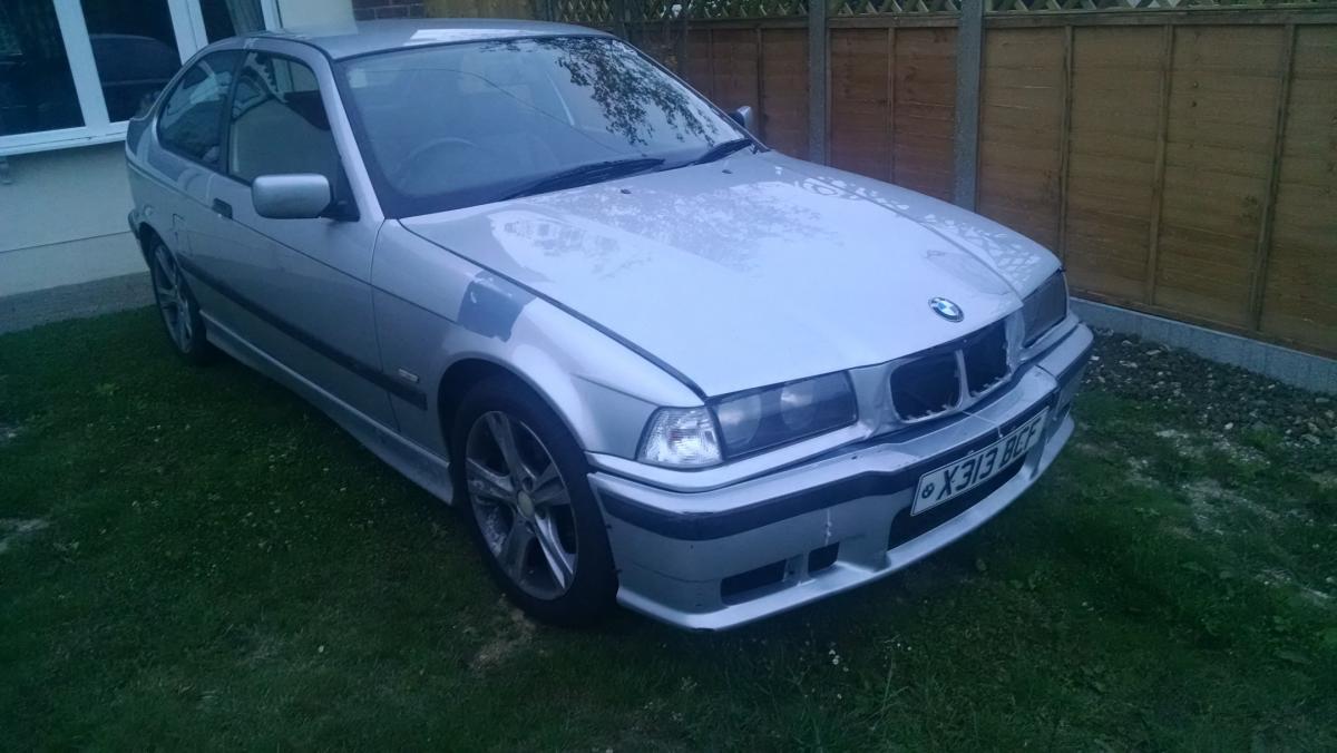

OK, so those of you who know me from the West Meon meet will know I have been banging on about getting another track car for at least the past year, so I apologies for boring you to death but I'm afraid it will continue as there have now been developments. The dilema was between an MX5 to turbo or supercharge or get an E36 BMW and tune that. Sam very kindly made the decision more difficult by allowing me to drive both of his. However the decision was kind of made for me when an X plate 318ti (Compact) with light damage was advertised very locally to me. Sam popped over and we went to have a look, this resulted in me parting with a couple of quid and the BMW is now mine. At face value it seems sound.
Plans are to repair the damage and get it MOTed, then put in a 2.8 that will shortly become surplus to requirements.
This isnt going to be a six month build, probably more like a six year build!! Things will be done as and when money becomes available, and as you can guess from the title I have already set a spending limit.
Anyway further delevopment in due course.

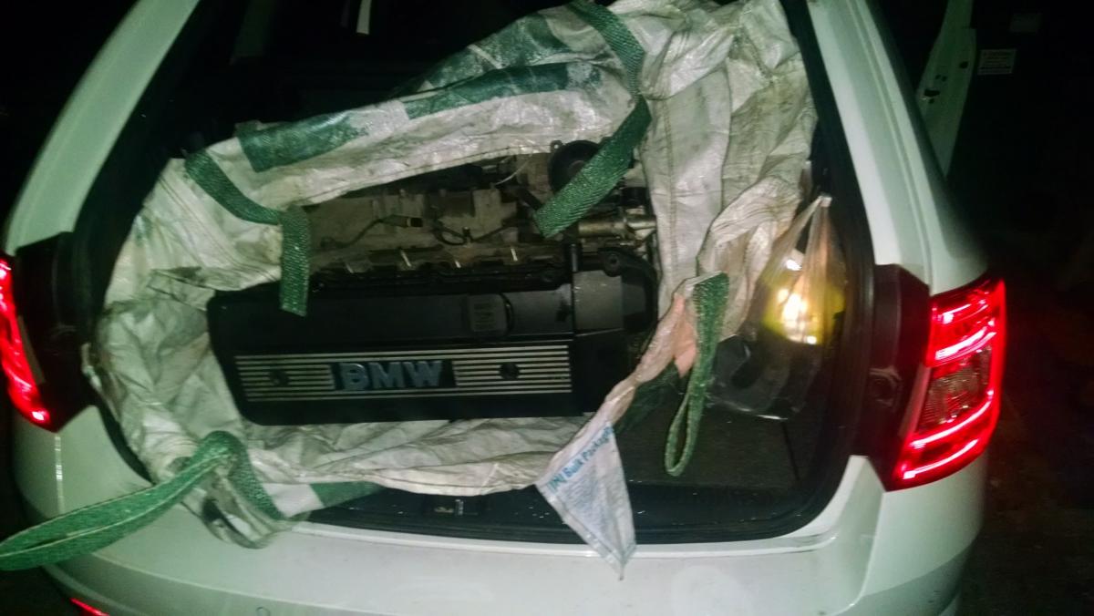

Next piece of the jigsaw acquired
M52B28?
Yes, running almost standard for now but have a few plans for it. Was running 245bhp so I gonna try to match that spec!!

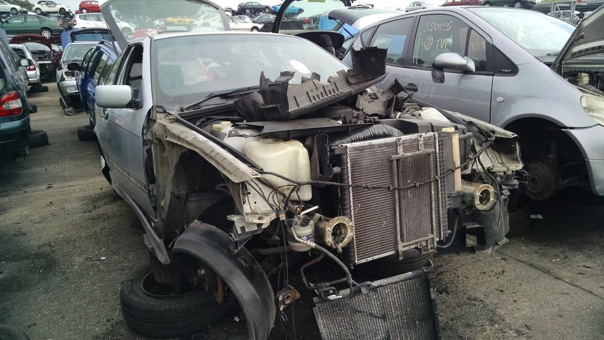

Searching the net revealed a 2000 E36 Compact in Titan Silver with the required body panels in a local salvage yard. It had been seized by the police for no insurance and taken away so I took a trip down there last weekend. Arrived at 10.30, found the car and by 12.30 it looked like this
